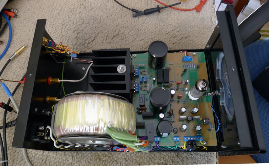

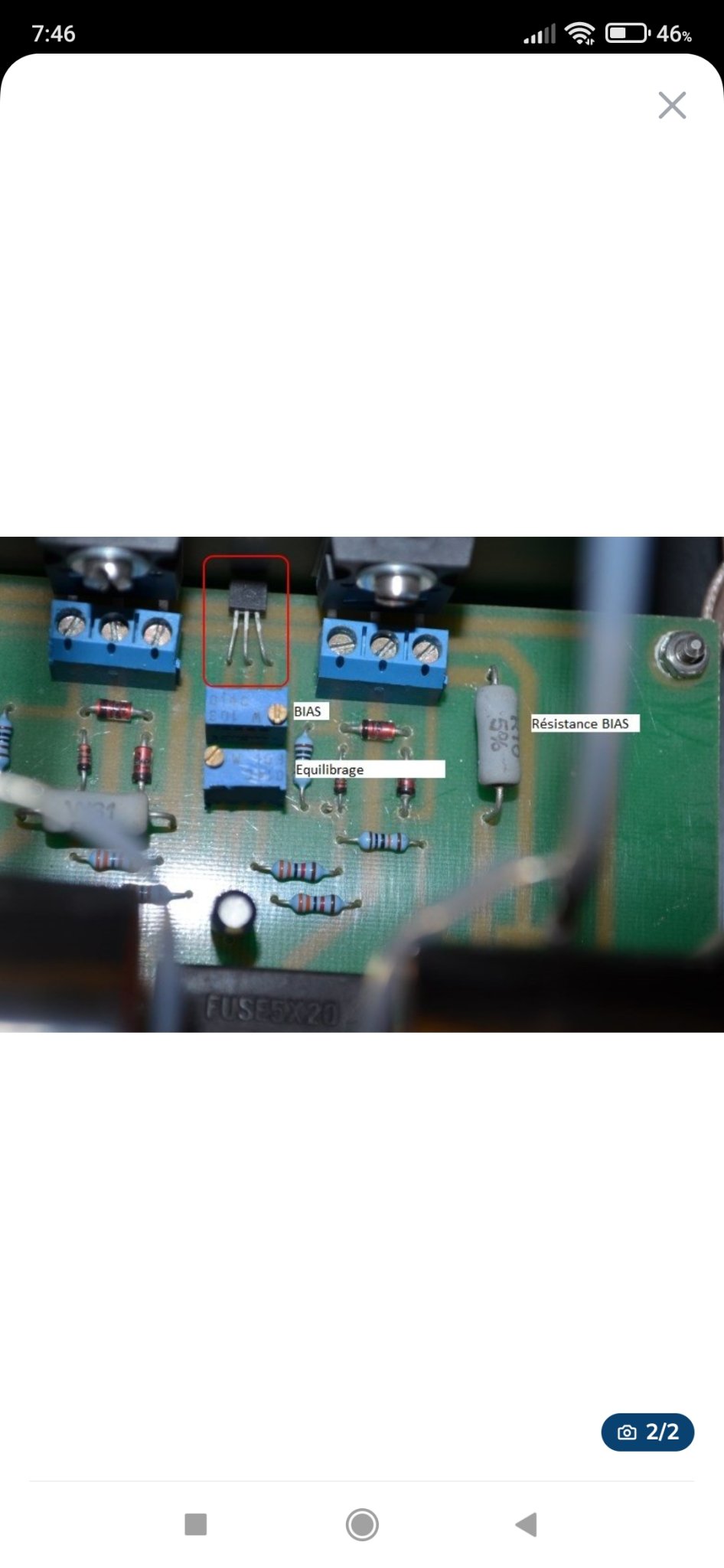

Need help for bias adjusting for hybrid amplifier KORA ARIES.
It's 2 resistors RV1 & RV2,but any ideas for value and test points.
Thank you.

The value is in the schematic: both of them 10k trimmer.
See blue helitrims near the heatsink.
RV1 sets the symmetry of output stage: OV on output.

RV2 only for the regulated current source of virtual (depends of raw DC +50V) common point R25-R26.

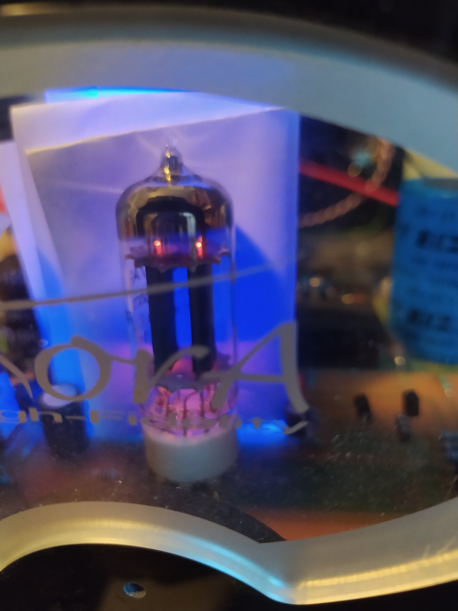

But I have two kora with similar problem.
The sound is low and distorted.
I think the tube alimentation is bad.
Can you help me for verification of voltage on lamp socket.
Across pin 4 & 5 15v AC it's ok.
The 2 tubes are new.
