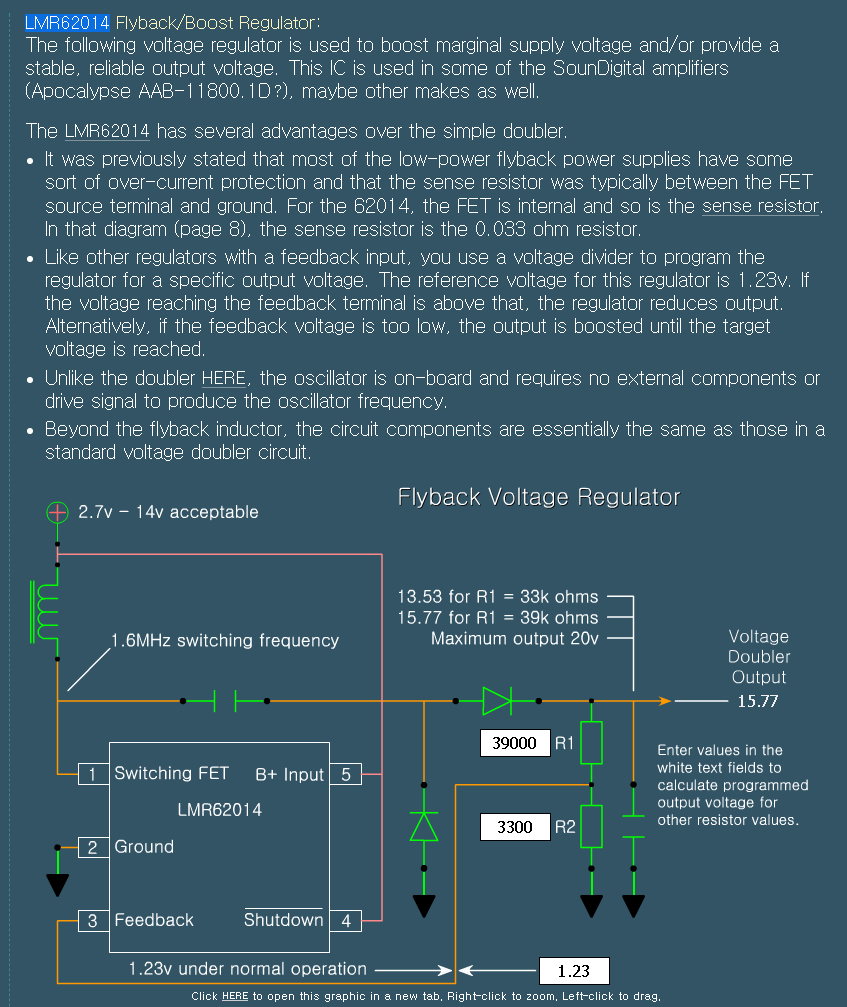

P Perry Babin Member Joined 2003 bcae1.com 2025-04-10 1:12 pm #2 2025-04-10 1:12 pm #2 The LMR62014 has been used. What sort of problem are you having that you suspect that they're defective? Attachments LMR62014forforum.png 67.2 KB · Views: 24 F Formas Member Joined 2008 2025-04-15 6:59 pm #3 2025-04-15 6:59 pm #3 I'm not having a fault now, but theres a lot of those amps that was sold from the store i work, time to time they turn up wanting repair, so im just stocking up on some parts for future use. You must log in or register to reply here.
