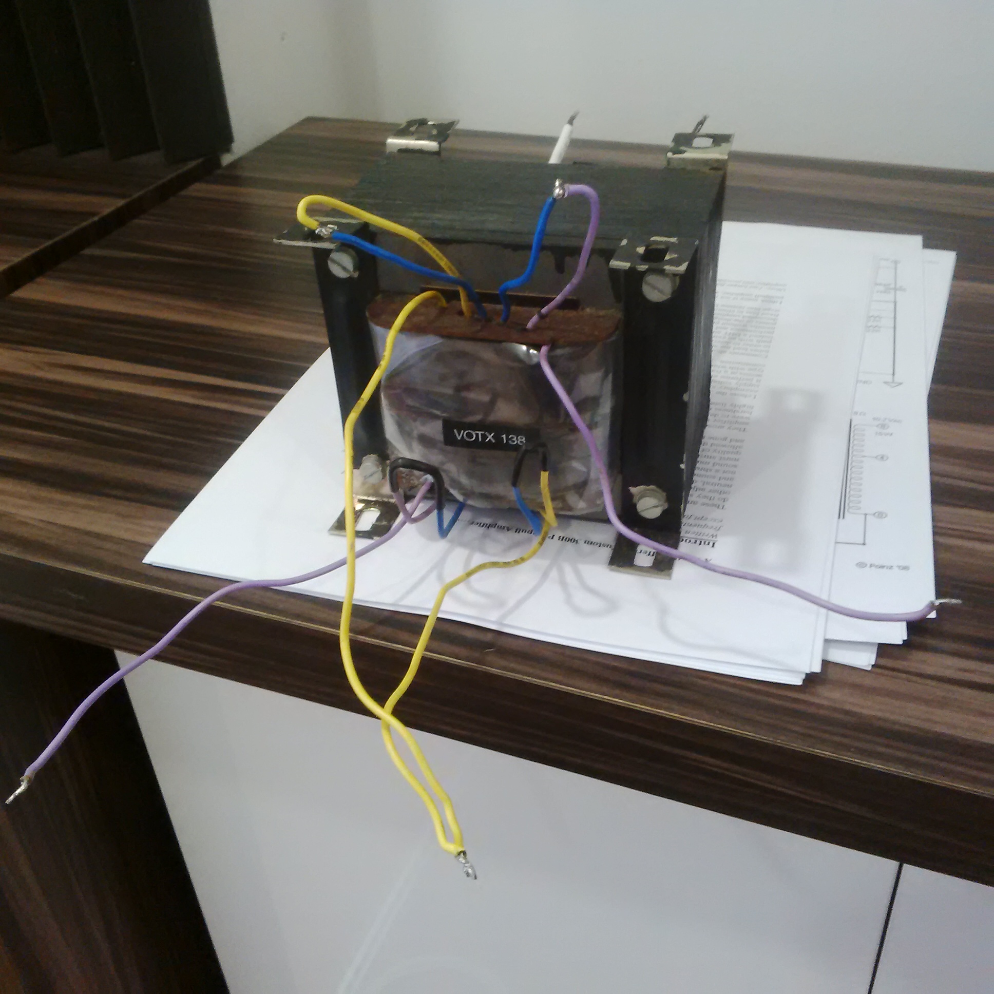

The first picture below shows the primary 2 x purple to plate yellow tied together for B+. It looks like a dual bobbin? I don't seem to be able to figure out why is it wired this way. Or is blue actually the UL tab?
Fiddling with a DMM, shows that for the primary, Each pair (blue & blue, Yellow & Yellow, Purple & Purple) is actually isolated so i actually have 6 set of winding 3 set on each bobbin?

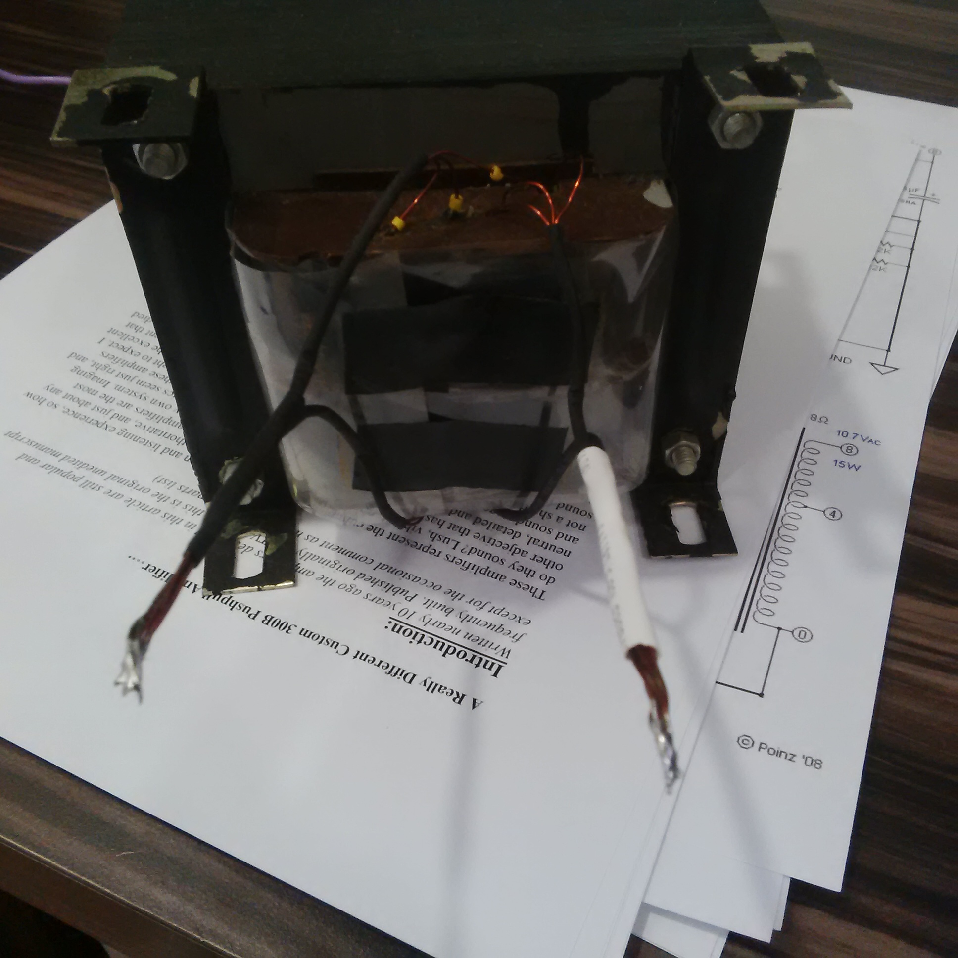

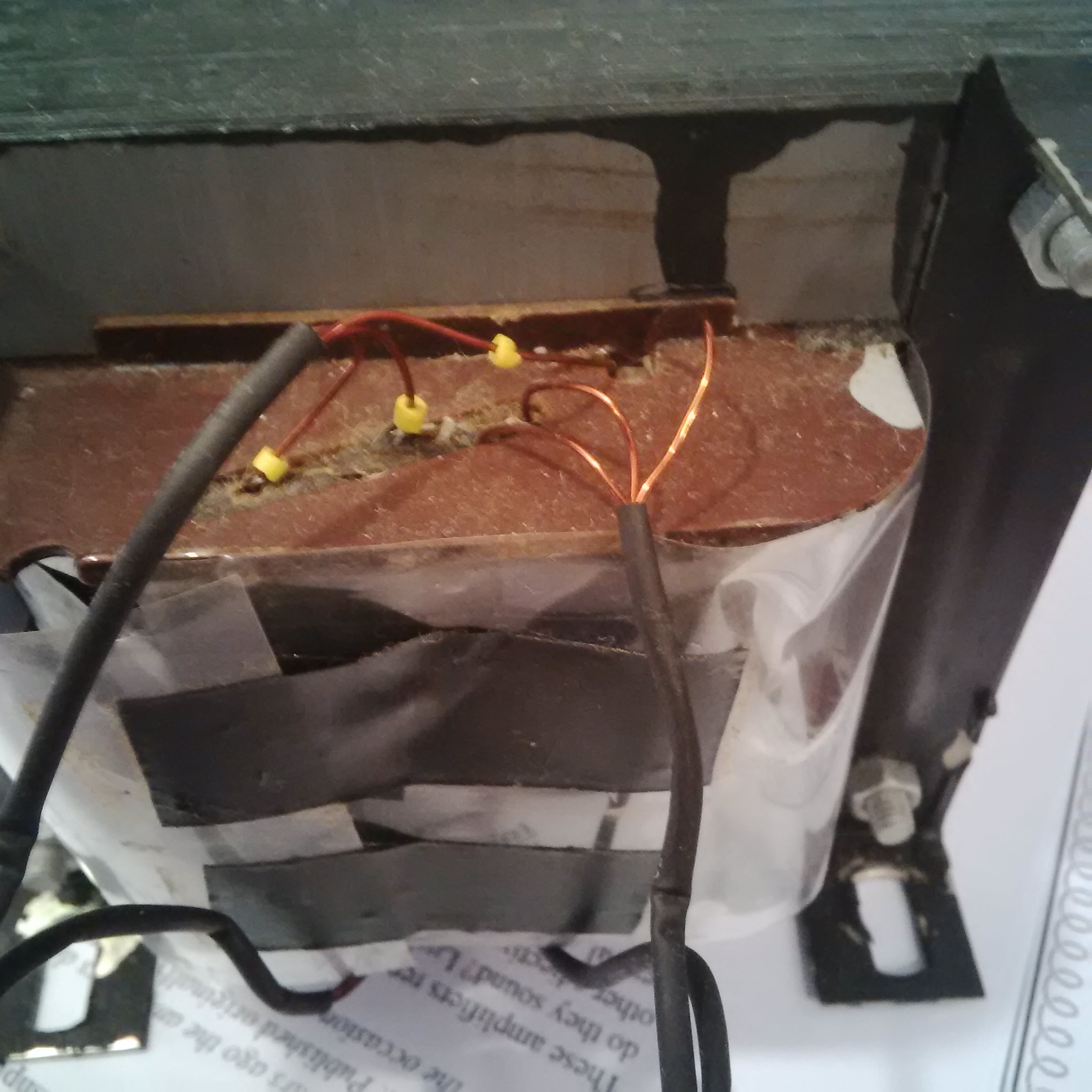

The second picture shows the top of the secondary and the bottom is a mirror image. The third picture is how it is wired as 6ohm. Is there any chance i can change the configuration so i can somehow get a 16ohm secondary to drive my LS3/5A?
Fiddling with a DMM, shows that for the secondary, Each pair is actually isolated just like the primary.

However, the construction of the output transformer look bit strange to me (maybe only to me) so i was hoping i can make some changes to how it is wired so i can use it for other tube instead of sticking to push pull el34 designs. Reason being the output transformer doesn't seem to have any ultra linear tabs and most el34 designs are UL and triode mode doesn't seem to give me enough power.
Unless you want the "iron" wrecked too, leave it alone.

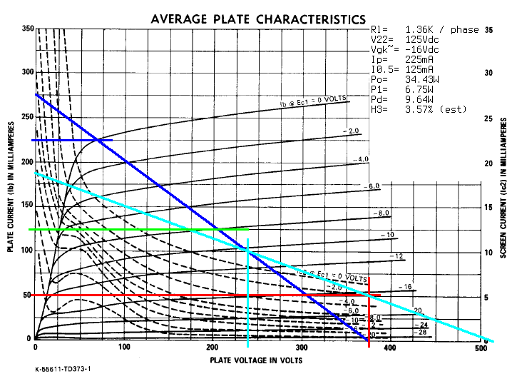

5K4 (P-2-P) is a very close match for the 10JA5. That'll get you just under 35W, and you just might be able to avoid UL. These TV deflection types tend to not make the nastier higher order harmonics, and make mostly h3. You can add just enough gNFB to take the "edge" off and tun them as full on pents: no trioding needed (and not possible, given the screen voltage limitations) or UL or other local NFB.

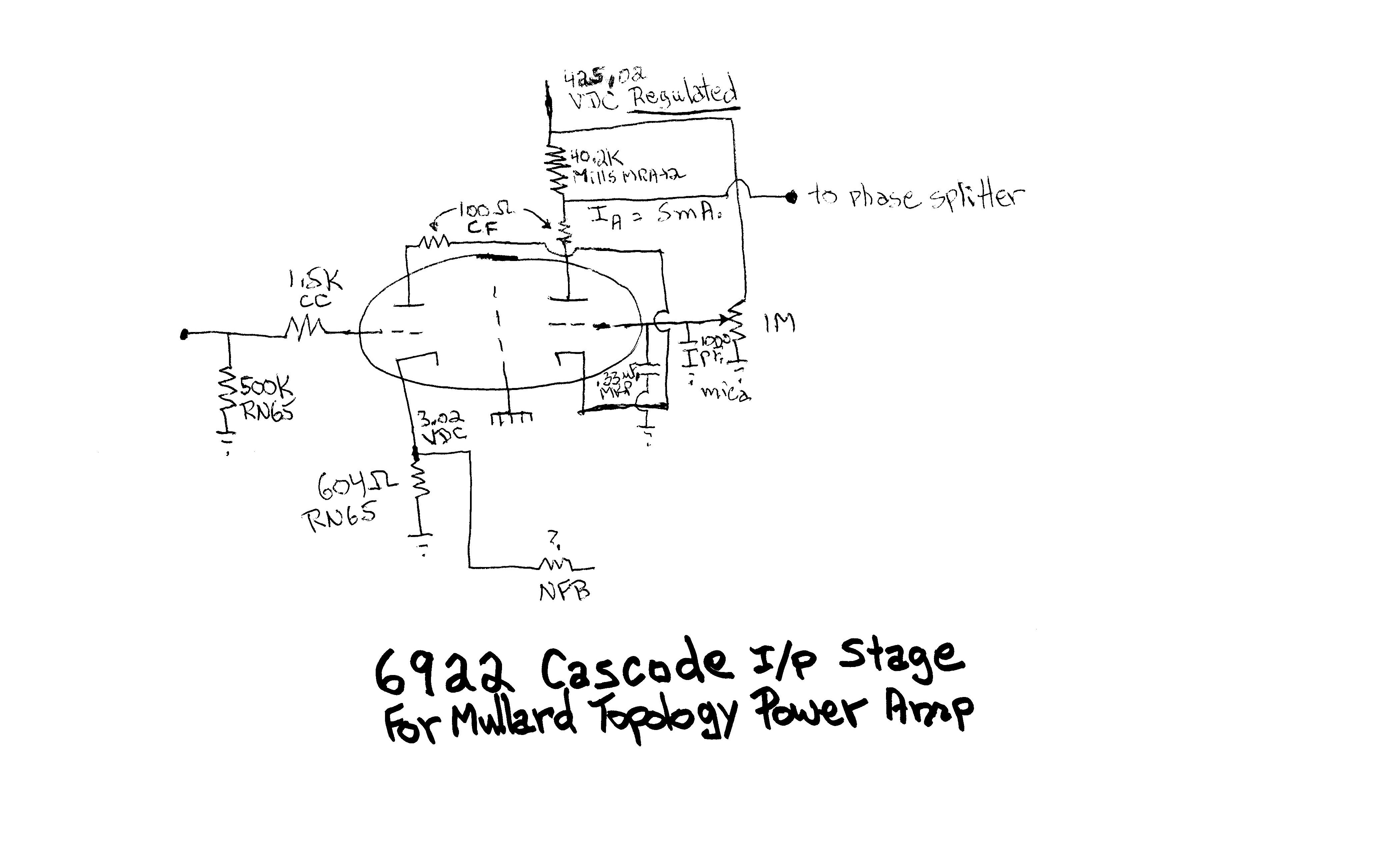

I took a look at the linked info. The O/P trafos are definitely reusable, with full pentode mode "finals". The power trafo is a question mark. What other windings, other the tube B+ and filament, are present? Can the additional windings be put to good use? What are the black "dodads" on top of the chassis? The photo in the link is not clear. Some good photos of the top (with the back cover removed), the back panel, and the underside will help us "scheme and plot".
It looks like enough top plate room is present for 2X Noval (9 pin mini) sockets (1/channel) to be added. Dyna/Fisher/Scott style circuitry with a 6922 in cascode as the voltage amplifier and an IRFBC20 MOSFET as the DC coupled "concertina" phase splitter should fit mechanically well.
I've uploaded a "hen scratch" schematic of a 6922 cascode which might be a "place of departure" for the new small signal circuitry.

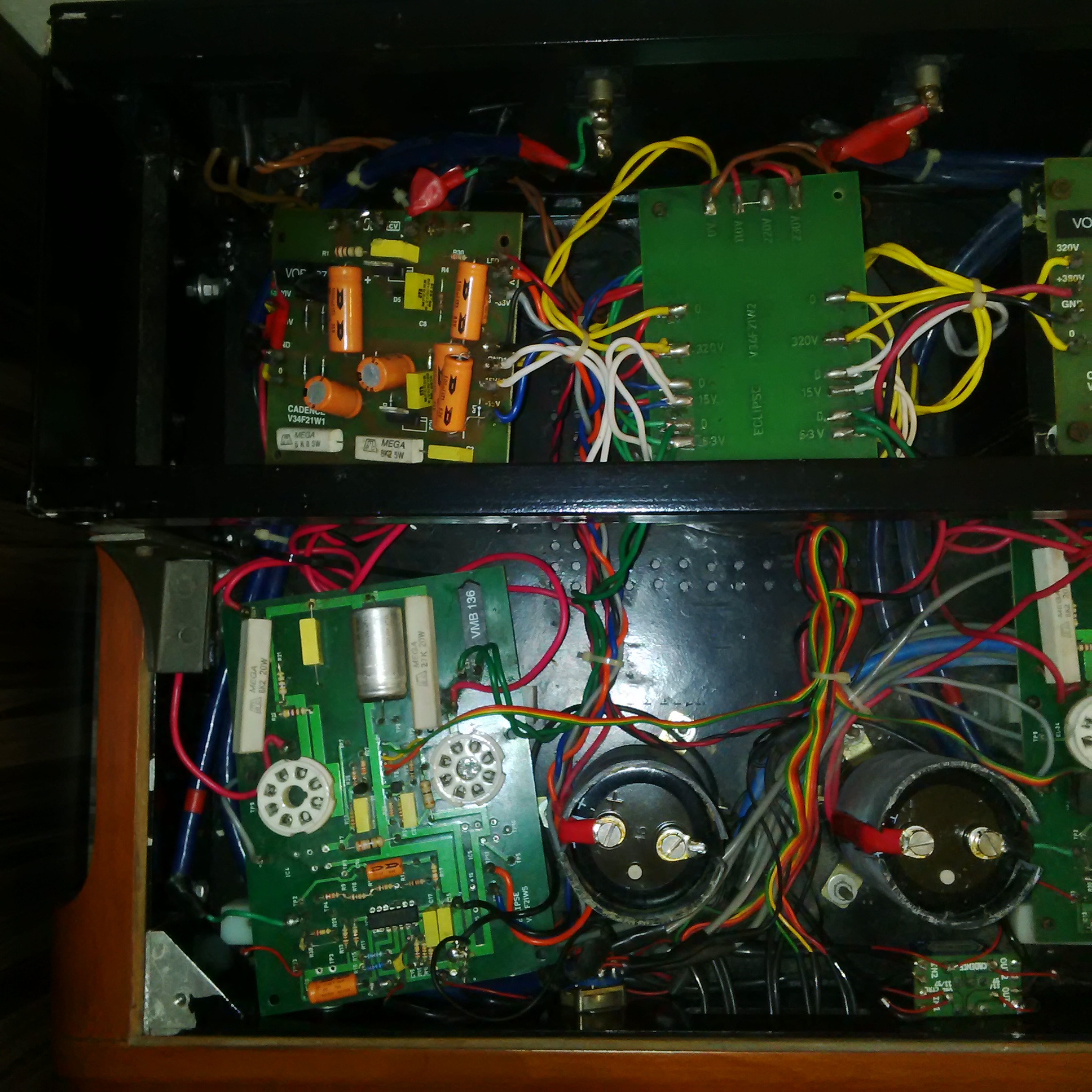

Attached is some nudies of the amp. Yes it is a hybrid tube amp with auto biasing through SS as well as the power supply and also yes it is meant to drive electrostatic speakers.
Power tranny is a toroidal with 0-320, 0-320, 0-6.3, 0-6.3, 0-15, 0-15
Intend to mate this "new" power amp with a CJ PV-10A and Rogers ls3/5a

1) Pete millett uniamp 2: quite costly to build can only use the triode mode and the circuit board may not fit the chassis.
2) Pointdexter el34 amp: triode mode power
3) Allen wright pp1c: triode mode power

1) Convert it to pentode output as eli duttman suggested but there isn't alot of pentode el34 designs forumers rave about.
2) Changing to KT88 to get more power with a new power tranny
3) build either of the triode output design and hope its good enough to drive the ls3/5a if not keep it as a spare amp.
4) Scrap the tubes and work on a real triode. 300b p-p work with this output tranny? most of them suggested around 3k impedance.

UL is out. You'll destroy the O/P "iron", if you try to modify it.

Looks like all the secondaries are connected in parallel. If so, 6 Ohms is your only choice. If all the primary sections are equal and connected in series you have 33% (as used by Dyna) and 67% UL ratios available. This could be confirmed by measuring the voltage from one end to each of the taps with a (safe) low voltage applied. DON'T disconnect the primary sections unless you carefully record what connects to what - the transformer response and breakdown voltage depend on how they are connected.
