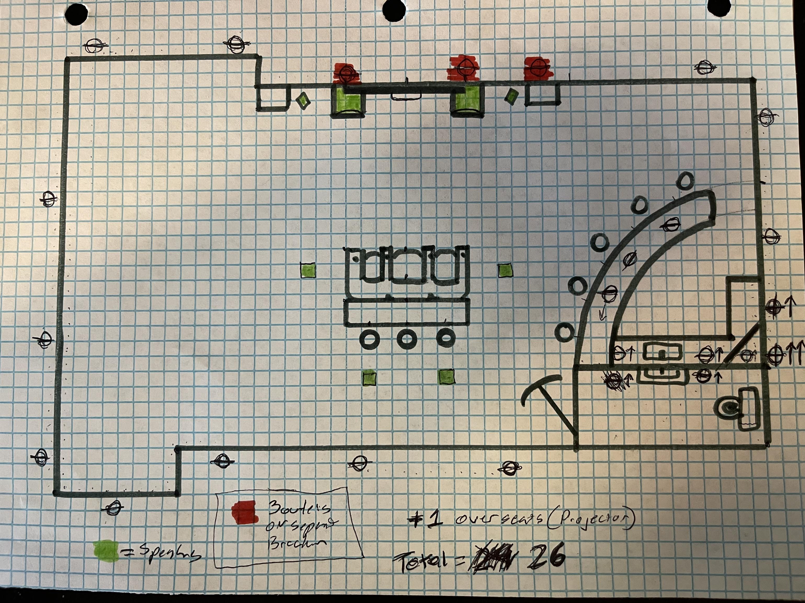

The UM18 in a sealed cabinet, powered by a Behringer NX is a great performer for the price and design simplicity. But get the NX3000, the NX1000 isn't going to give you more than a few hundred watts actual watts. You want some headroom. NX3000 will let you get the most out of the low end without pushing the cheap amp into protection. And get the DSP version so you can use the power where you need it.
I don't agree with the poster who said a 1kW sub is ridiculous overkill. The above system is the minimum I would consider for an HT sub in a large room. And your room is massive really, great for smooth response but not so great for LF boundary reinforcement. In no way comparable to a 13x15 room or a car for that matter.
Yeah, the lowest eigenmode in either direction [25, 50 ft = ~22.6 - 11.3 Hz] basically means no room gain till well below 20 Hz, so precious little boost for even the lowest LF movie soundtracks other than what corner loading adds and depending on how far away from it's location(s), ULF efficiency, even a 1 KW rated sub might not be powerful enough to meet Dolby's 115 dB peaks at the listening position(s).

The more I read in this forum the more I learn that I don’t know much about this. I have attached a quick drawing of the room. It is 50ft by 26 ft with a bar to the side. Poured concrete floor but will have a 12‘ x 15 black rug directly under the screen. And a dark wall behind the screen as indicated. The green boxes on the drawing are the speakers the two large ones the top of the page are two subwoofers under the 100 inch screen. The other remaining green boxes are tower speakers and the speakers by the theater seats are mounted in the ceiling. The red boxes are outlets on a separate 20 amp breaker for the subs and receiver/amps.
That's a big room and the concrete floor means you won't get the easy tactile (shake) response you'd get on a suspended floor. You'll want some firepower for that space.
