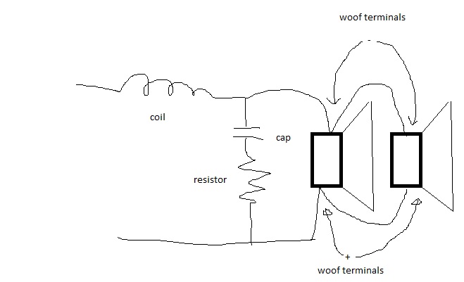

I purchased a set of Tekton Double Impact Speakers earlier this year. From day one, I noticed that there was not great bass as described in the many positive reviews of the speakers. The bass sound seems very flat, especially at low to normal listening levels. The speakers are connected to a Willensenton R8 Tube Amplifier, Bluesound Node2i Network Streamer, and a Denafrips Ares II DAC. After trying just about everything from new speaker cables, Tidal Subscription, Two sets of Tubes Kt88 & EL34, to moving them out from the wall I decided to take a look inside the speaker by removing the top 10" woofer which allowed me to see the crossover inside. Based on what I see, does anyone know if the wiring to the crossover look ok? Are the wires from the woofers reversed? I see the red pos. wires from the woofers connected to the neg. side of the crossover and the black neg. wires from the woofers connected to the pos. side of the crossover. Could they have been wired incorrectly at the factory? Any help or input that can help would be great appreciated..
.. moving them out from the wall... does anyone know if the wiring to the crossover look ok?

Lojzek, I'm suspecting that the crossover is not wired correctly. See picture in my original post. The sound that I'm getting it very similar to when speakers are hooked up out of phase. Checking my speaker cables was the first thing I checked.. Doe's anyone know about crossovers who can look at my picture and tell me if the crossover it wired correctly? I have highlighted and labeled the wires in the picture, and yes the two 10 woofers (TD-LGND BP 102) are in parallel. No, I don't listen to extreme bass music. Mostly listen to Jazz, Dire Straits, Instrumental, Nora Jones, etc. The link you mention to Stereophile "Tekton Double Impact-Very Disappointing" is spot-on to the problems I'm having with the sound.

Yes, Brent, the woofer is wired out of phase. Can you get a similar shot from the other box, just to see if it's the same?

Before I purchased the speakers I watched both of those reviews. I spent some time researching The Tekton Double Impacts. Many other top reviewers on Youtube like "The next best thing studio" and "Zero Fidelity" gave them such rave reviews.. Here is a bigger image of the crossover inside. I highlighted and labeled the wires. Again, I suspect the crossover may be not wired correctly.. Hopefully someone can look at the picture give me some expert advise as to the wiring if its done correctly or not? and how to fix it? if need be..

Remove the speaker wire from the amp and put a 1.5v battery across the wire For a split second. Do both woofers move in the same direction? If they do, there wired right.

Brent21 said:Already checked the other speaker. Its wired the same..
When I meant out of phase, I just meant that the amp red runs to spk black and vice versa, but spk reds and blacks are still running together which is fine, provided the voice coil polarities (within speakers) are also correct. Since phase is relative the disparity could be between left & right or between the drivers within the same box. Now, there's another phase issue between woofer and tweeter, where you would get a huge mid-range scoop-out that no EQ can fix, but this is definitely not that one.
The battery test will tell you if any individual ones need to be inverted. If yes, then that's a workmanship-related defect at the speaker level. However, the surprising thing would be that your particular set of speakers still managed to pass the manufacturer's QC tests!

norman bates said:this might be how the crossover should be...
Sir, I don't know why I feel that it's the same as what it is now? Amp and spk in opp phase (that's ok) but both spk in phase, isn't it?
Yes, though the speaker maybe using patented technology etc., the photographs taken by the OP clearly shows poorly finished wire joints and/or soldering. Note that these are joints that are subject to strong vibrations during operation of the unit, so their reliability does matter.

9v battery test, connect batt pos to speaker pos connector, in phase, woofer will move out, out of phase, woofer move in,…
Simple, fast…
Btw you can the battery just for a little spike, not continuously, obviously…
