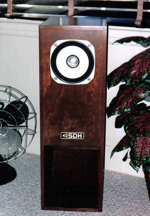

Well, I'm certainly looking forward to building these. The drivers, lumber and terminal cups are now here. Now it's just a matter of me finding the time to assemble them.
Done! Am very happy with the results. Used a layer of fiberglass on the rear, top and side walls. They're articulate and dynamic. I don't feel the need to augment with a subwoofer, nor do I feel the need to add a tweeter. Measured a usable response from 50 to 17k Hz in room.
nice build...
I like.
no tweet? yeah. I use the full meal deal t90a and network. it makes a nice difference but in the end is a tradeoff. the cost is considerable. the t90a can sound a bit raspy to some ears. the best supertweeter implimentation is one that is not "noticable" I love the effect though of a nicely implimented tweeter though. lots of leading edges nicely and effectively defined for these big full rangers. I am still working on tweaking the t90a in this case though...
Clark
I like.
Clark
celt said:Done! Am very happy with the results. Used a layer of fiberglass on the rear, top and side walls. They're articulate and dynamic. I don't feel the need to augment with a subwoofer, nor do I feel the need to add a tweeter. Measured a usable response from 50 to 17k Hz in room.
Congratulations, they look great! Can you give use some details on your cabinet finish please.
Jeff
vinylkid58 said:Congratulations, they look great! Can you give use some details on your cabinet finish please.
Jeff
Sure thing. I used two coats of Zar "Natural Teak" stain (fogged with a sprayer) and four coats of nitro-celluouse lacquer (spray application). I'm allowing two weeks cure time and then am going to do two applications of carnuba wax.
