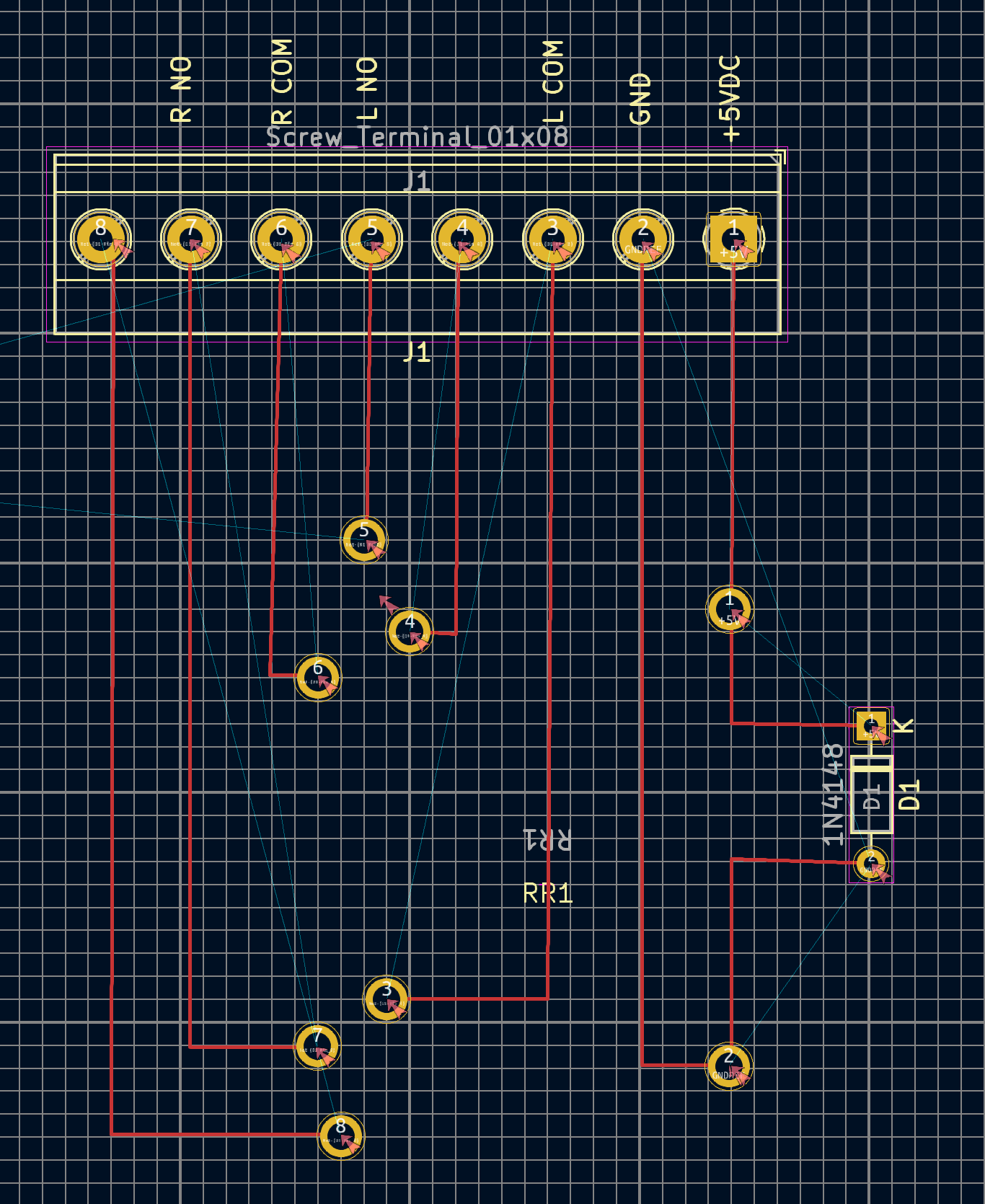

I am using V7 for this project. I have a very simple PCB design, nothing more than a terminal strip and pads to accept the relay pins. The reed relay is quite old (1980’s P&B T10 series, long out of production), but high quality, so I wanted to use them in this preamp project. I was unable to find a datasheet that provided pinout dimensions, so I had to design my own KiCad Footprint. Attachment 1 shows the board (the grid is 0.1270 mm). Running DRC results in many errors. Attachment 2 and 3 shows the two types of errors. I have spent almost a week trying to understand what is going on, but with no luck. What is strange, is that a week before I began this design, I did a separate board for mounting the switches that control these relays, that went without a hitch. So, I assuming it all revolves around my Footprint design, but that is just a guess.

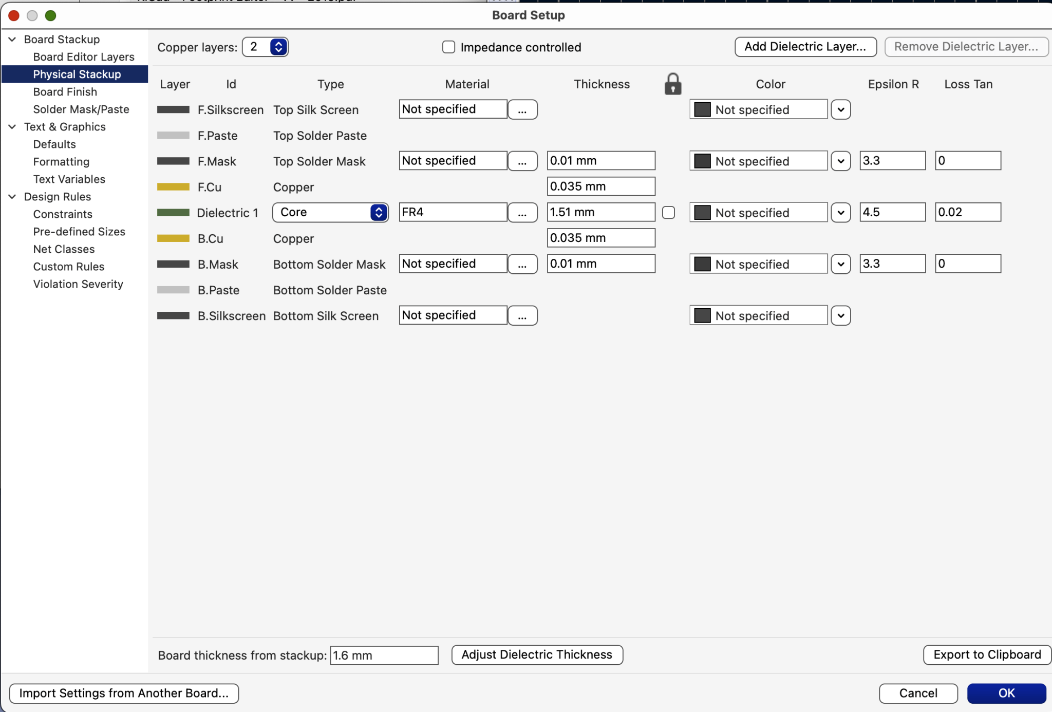

I'd try specifying the top and bottom solder masks in the layer stackup. Pick a colour and go with the default settings to start.

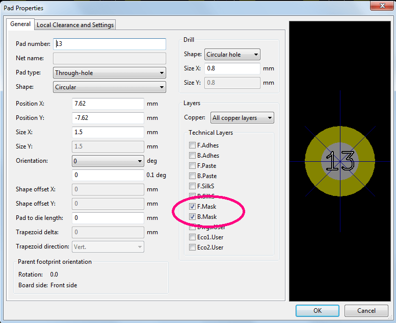

Mark, thanks for the guidance. I checked all eight pads for the Footprint using the Footprint Editor and all had those two boxes checked.

Tom, sorry to be so dense, I now see how to set color for the F and B Mask. I did that, using purple (the OSH Park color), unfortunately no change in errors.
Hmmm... Silly question: Are the connections drawn on a copper layer? You'll want B.Cu for that. Or F.Cu if you'd rather have the traces on the top.

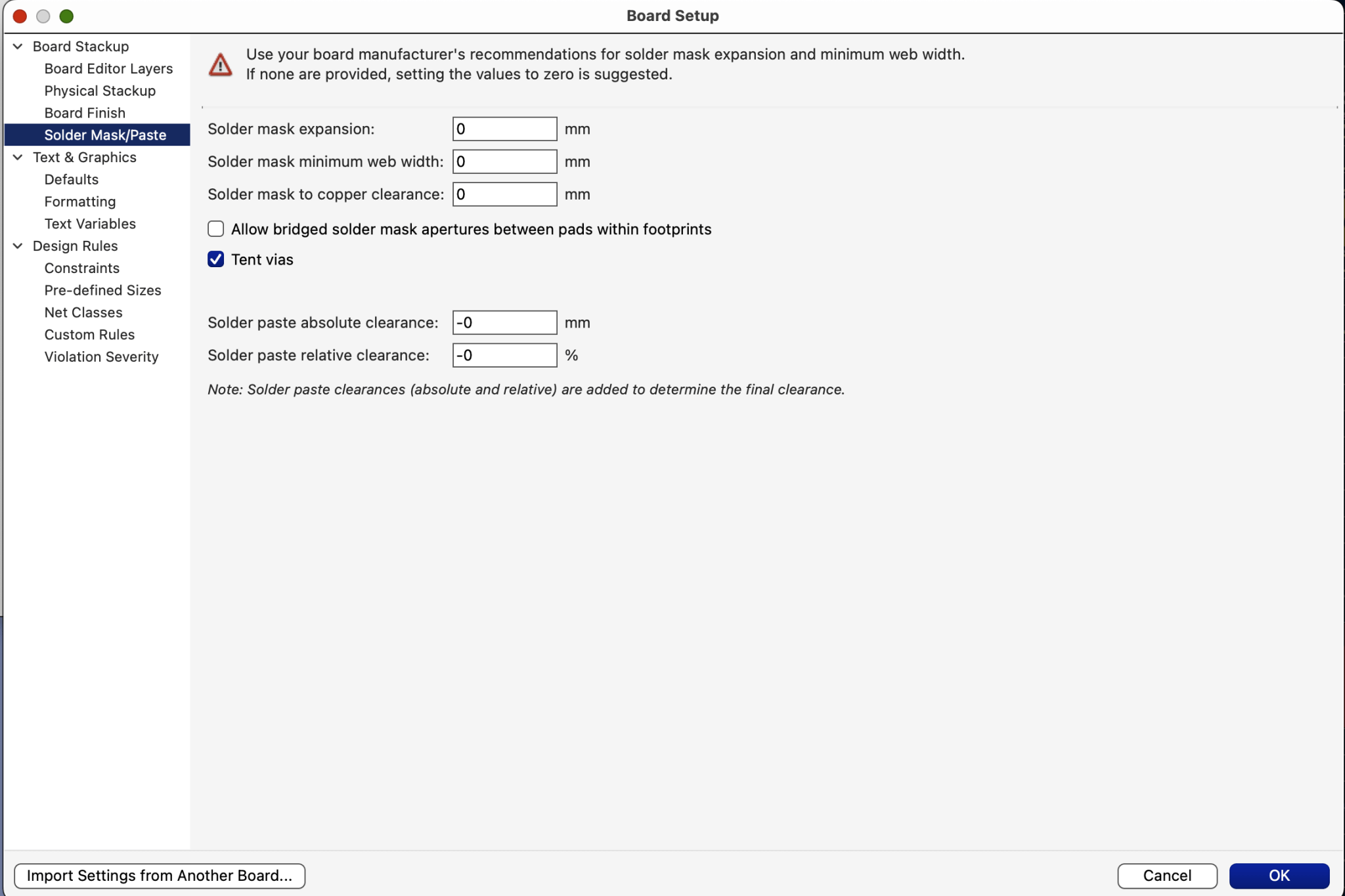

I'd set the minimum solder mask web width to something other than zero. I forget what OSH Park needs. 0.1 mm or so should be OK. The exact spec should be on their website.
Also draw a board outline. I forget if KiCAD requires one but I have had other tools barf if the outline was missing. You need to use the Edge.Cuts layer for this. I make the outline 50 mil wide so I don't get tempted to place the components too close to the edge of the board.

I checked the OSH Park website, and found the minimum setting should be 4 mils (0.1mm) as you suggested. I made the change in Board Setup. No change to the list of errors.

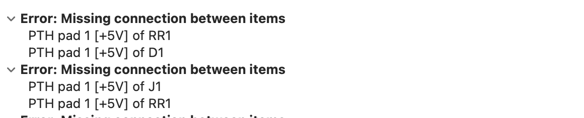

Kicad considers your tracks as incorrect, I sometimes get this error if the track is associated with a net I changed the name of later. You can check like this:
Click on one track with the mouse, hit "i" on the keyboard to select the complete track, hit "e" to open the edit dialog and look at the net the track is associated to. You can change the net there. Normally Kicad does this automatically, but sometimes it gets stuck.
Another way is to simply delete a track and draw a new one: if the same happens it might be a problem with your symbol and/or footprint. The symbol in the schematic needs to have numbered pins so that the footprint "knows" which pin is connected where! If two pins have the same number Kicad wants you to connect them together, or it gets confused when 2 different nets are connected to 2 pins with the same number. Normally impossible, but if you change the footprint or symbol after drawing the layout it can happen.
So if you change something in the schematic or alter a footprint you need to update the footprints in the PCB and/or update the netlist from the schematic into the PCB - there are menu commands to do so.

I am on V5 and can assign the net for the selected track segments in a drop down menu. The FP can have pins that the symbol doesn't have, but the pins the symbol has should exist in the FP.

Jpk73, I have yet to find a way to determine or set a net for individual tracks in V7. For individual pads it is easy, just Select, open Properties, and there is a box for setting a net. If I set all pads for all components to “No Net”, the “Missing connection between items” errors are resolved. The pin count for all my symbols and footprints are consistent.

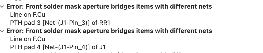

Just an update, I redid everything using KiCad supplied relay symbols and footprints, and I am left with only one set of errors “Front solder mask aperture bridges items with different nets.” Off to the Forum!

Tom was spot on with his comment “you’re dealing with something super obvious.” It turns out I have been trying to draw tracks with the line drawing tool and not the Route Tracks tool. SLAP FOREHEAD WITH PALM OF HAND!!

For the curious, the solder mask layer is a "negative": it shows where you don't want a solder mask to be applied. The solder mask keeps solder from sticking to the underlying copper (or even substrate).
Normally you have a hole (called an "aperture" in PCB-land) in the solder mask over a pad so that the copper is exposed and solder sticks. However, if you have two pads close together, and the aperture covers both of them, then a glob of solder can stick to both, connecting them. So if they represent two different nets then KiCad complains. (This is the "solder mask aperture bridges items with different nets" error.)
Note also that if you don't want to see these errors (or any other DRC errors), you can turn them off in Board Setup > Design Rules > Violation Severity.
