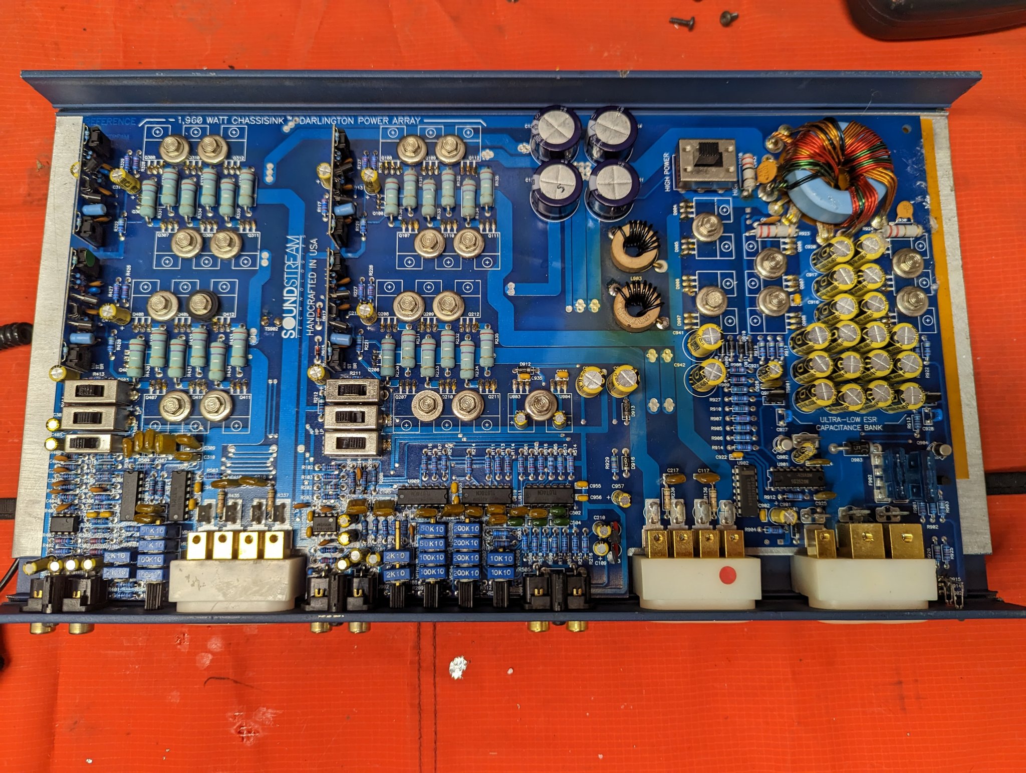

Hi all, new to the forum here. I am currently getting everything together/setup for installing a sound system in my old W123 Mercedes. I have a McIntosh MX406 HU, Soundstream Reference 604 Amp, and have a variety some old-school MB Quart premium speakers and crossovers incoming. I'm am refurbing everything before install.

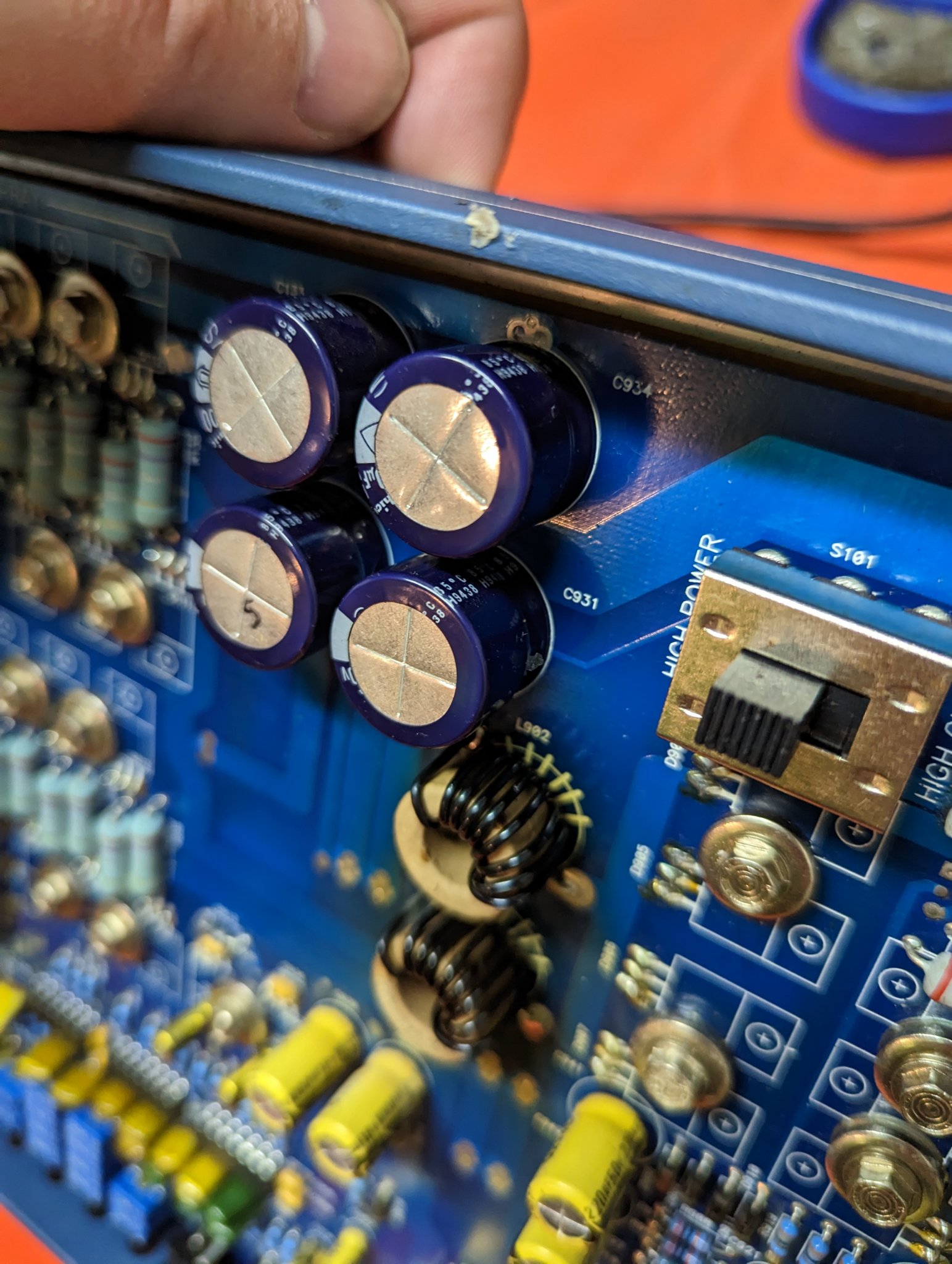

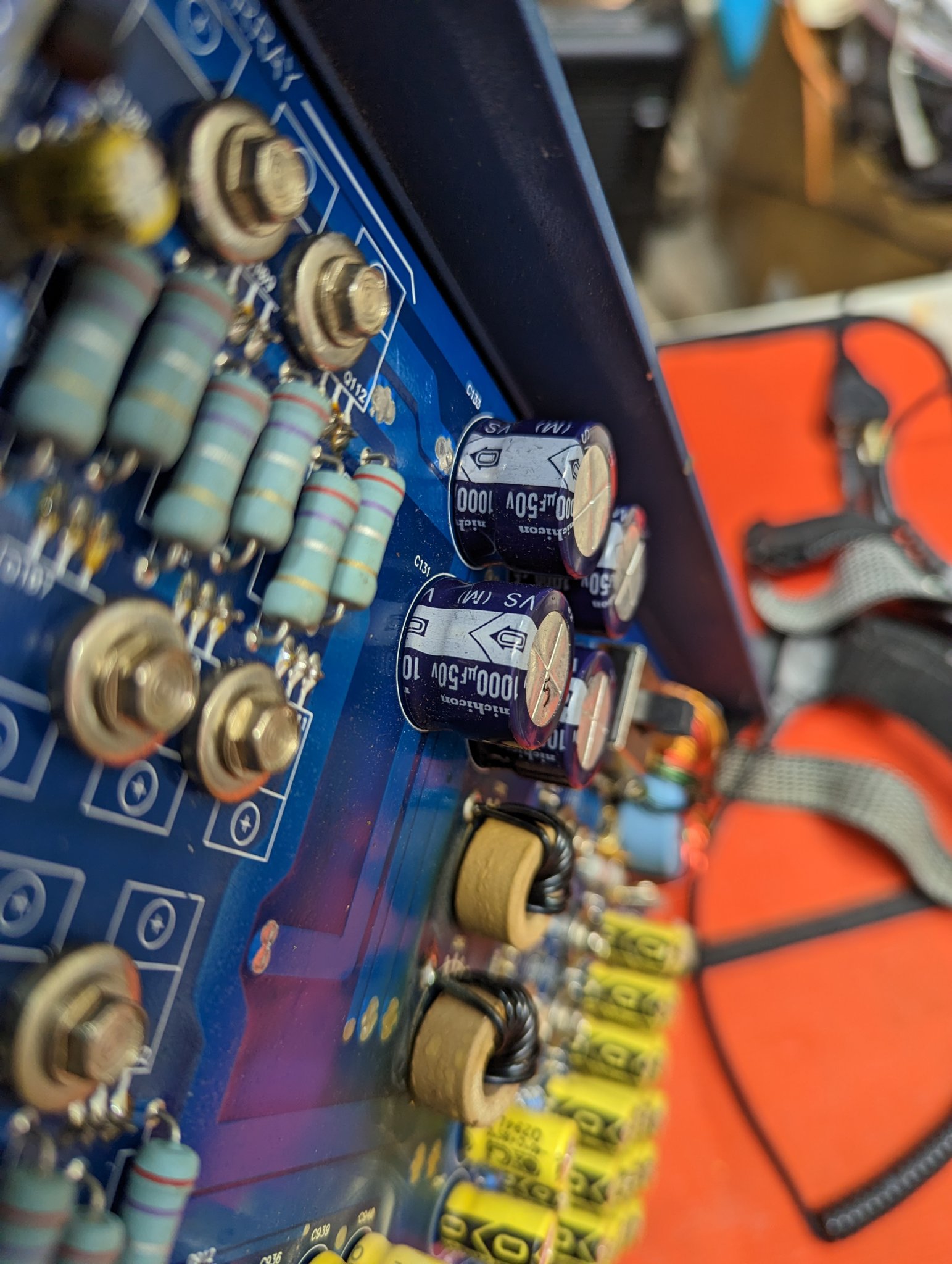

Everything works on the Soundstream amp and it is clean inside (except for some discolration around the power chokes, but amp has been bench-tested). However, I am going to be re-capping it. I am having trouble finding replacement caps for the 4 big power caps that are rated at 1000uF and 50VDC. They are currently Nichicon VS-series (cannot find datasheet regarding these anywhere) and 20mm diameter x 15mm height. The big issue is the height! I can go a little taller than 15mm, but not much as there is no clearance beyond ~19mm. I cannot find any caps to fit these specs - all seem to be 20mm, 25mm, or 31.5mm tall which will be too tall. Does anyone know of a current cap that will fit these physical restraints for this purpose?

Recapping is typically pointless unless you know that there is a problem with the capacitors. Check their value. If they're within tolerance and not leaking electrolyte, replacing them will make no difference.
Nichicon are good, replacements may not be same high quality.
Agree with rayma, and Perry, no need to replace unless really essential.
If you do need to, see 35V series, they should be good enough in a 12V circuit.
2200uF/63V is 18mm dia and 31.5mm long from Keltron, which is a Sprague licensee in India.
Circuit permitting, fit two sideways, in place of 4?

Wow, thanks for all the quick replys on this. It is not my intent to hash the old replace/not replace debate. I was simply providing a little background on what I was currently working on as an introduction, being my first post.
I will say that this is a 30year old amp w/ electrolytics and my viewpoint is to replace the caps in this particular instance as a preventative measure. Yes they may measure fine now, but that does not mean I couldn't have an issue a few years down the road (no pun intended). I feel I would be better served to replace caps now while everything is out and I'm making sure everything is up to snuff before install. This would simply be to mitigate any potential future issue / prolong the MTBF. By the time I would have them out to accurately measure, my opinion is that I may as well replace with new at that point.
I could possibly lay caps down if needed, but in that case I may just leave those alone at that point. Nichicons are reputable and this is not a case of capacitor-plague hysteria (which these would not be under that anyways).
