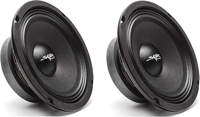

For BUDGET Midbass IN YOUR CAR, what would work really well if you are going to get subwoofers down the line, and wish to cross them at about 100 Hz at 24 dB?
The SKAR Woofers. They take power, they sound good in the doors, and the large door space gives you surprising kick drums and response for the drivers. For $50 a pair? Its a no Brain item to start put with until you are ready to do a FULL door build.
https://www.amazon.com/Skar-Audio-F...ocphy=9061079&hvtargid=pla-605154452555&psc=1
If you want response down to 80-60 Hz from the doors? (Hard to do without rattles?)
This: Was a Great deal when $20 bucks or less. IT HITS HARD! Great for under the seat midbass. Takes GOBS of power no problem on musical transients. And yes, does have output up to 900 Hz till it drops off.
Its marketed as a SUB woofer, and it DOES go down low. But surprisingly? Really works well as a woofer if you have a low Fs Tweeter. Surprisingly sounds good and if you like Kick drums that you can feel in your chest? THIS is it.
