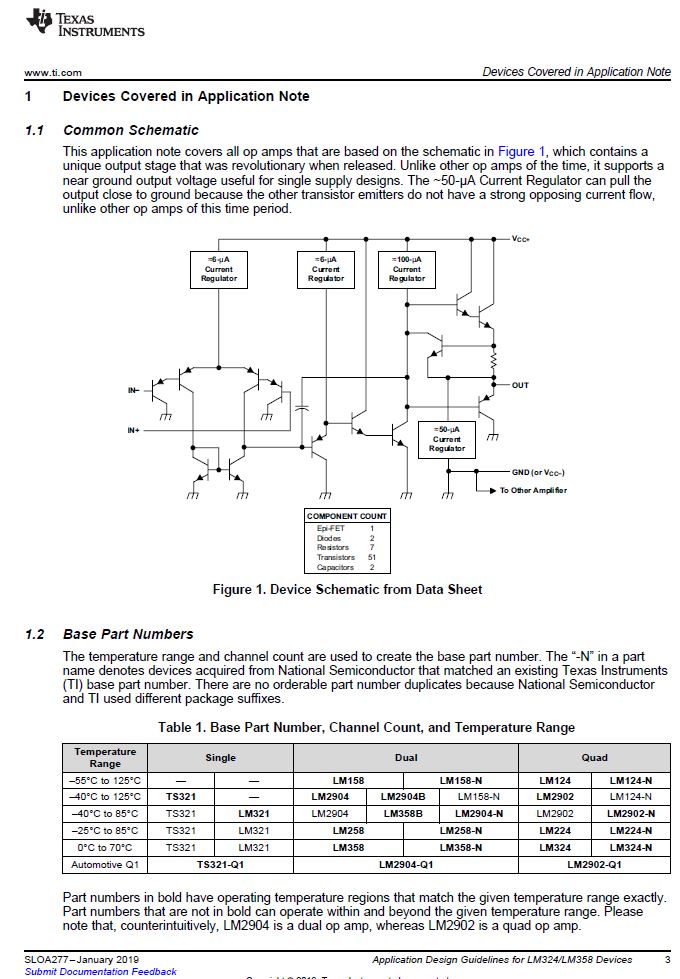

The National Semiconductor (now part of TI) LM358 is the dual version of the BJT LM324 (released in 1972), which was a very old design that could handle ground referenced inputs (uses darlington lateral PNP input differential pair), mostly designed for automotive applications. It was an improvement on the LM741 which could not handle ground referenced inputs.
It is a general purpose cheap op amp with very low slew rate, poor input offset and and not low noise input.
There are many op amps that that operate way beyond the capabilities on the LM358 (dual).
Application Design Guidelines for LM324/LM358 Device
