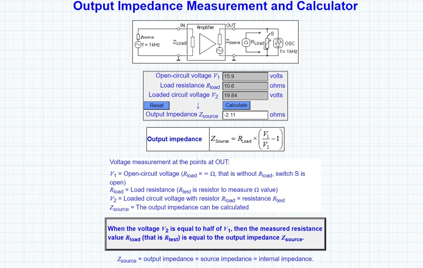

I tried to measure the Zout of my EL84 SE amp with the calculator on this page: http://www.sengpielaudio.com/calculator-InputOutputImpedance.htm
I had it connected to a 8.7 Ohm dummyload (output 15.9V), and then put a 10.6 Ohm resistor in series with the dummy. Output 19.84V (all peak to peak)
The outcome was negative?! -2.11 Ohm.
I've used this calculator for preamps, but this is my first power amp, I'm probably missing a lot but I don't know what.
Thanks in advance!

If output voltage rises with rising load, impedance is not negative.
Tell us WHICH values you used, and WHERE
A screen capture would be fine.
That 15.9 V at the calculator (V1) is not open circuit voltage. You told you loaded it with 8.7 ohms.
The calculator uses the open-circuit voltage you don't have.
What you have is V1 = 19,84V and a load of 8,7Ω giving a current I1 = 1,028A
and V2 = 15,9V with 10,6 + 8,7 = 19,3Ω for I2 = 1,828A current
Zsource = (V1 - V2) / (I2 - I1) = 4,93Ω
But that's not the end of it, with a different load the gain of the output stage change and so does the open-circuit voltage. To get a more reliable value repeat the exercise with two allmost equal loads.

The loading measurement method is invalid/inaccurate for a number of reasons (impedance is a vector, it is non-linear, etc.).
The only valid way to do it (and in a sim, you have no excuse for not using it) is to drive the output (muted) with an external source/amplifier, delivering 1A AC for example.
If you measure the residual voltage appearing at the output, you obtain directly the magnitude of the impedance, and it will be the true one.

I know nothing about measures, but if the number you got was inverted (x -1) it should be close to what it should be.
Sorry but no.
Using the proper voltages asked by the simulator the result will be correct, and impedance will be positive.
