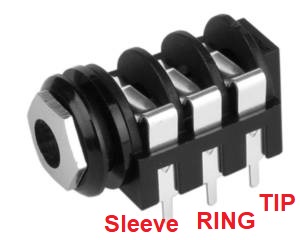

I want to fit 2 of these to two different h/amps - do you think I can find a single picture/diagram to show L/R/E connections.
I plan to use them with the solder tangs upwards. The earth is the 3rd, farthest away from the chassis plate? You would think Neutrik would have this info on their site - no way. Wasted 2 hours on the web - no luck - anyone?

I bet it has standard TRS wiring so Neutrik wouldn't bother to put it on their site. Tip is left channel, ring is right and sleeve is ground. Looking from front plate: ground, right, left.
Bamboszek - you've given me the jack connections. There are literally hundreds of diagrams/pictures of jack connections - what I need are the socket connections and I could'nt find a single one.
I'm fairly certain that the third - farthest away from the chassis plate is ground/earth but the others?

thanks for that, I did'nt realise that when I bought them. here's the thing - if i insert a jack the first two sections/tangs lift leaving just the first in contact, so I infer this is the earth connection.
I shall solder the earth to this and suck and see with the other two.

they are stereo PCB mount, using them upside down makes soldering the signal wiring much easier.

It look like the MZT-223 part is from Monacor.
MONACOR - Products - MZT-223
Here is the same part from Neutrik: NMJ6HCD2
NMJ6HCD2 - Neutrik
All the positions are switched, you have to chose the correct terminals.

if i insert a jack the first two sections/tangs lift leaving just the first in contactOn stereo mixers with jacks when You connect only the Left channel, the signal is also passed to the right channel. I suppose perhaps it's designed for this function.
MAACo, thanks for that.
Chartal - all the positions are switched, you have to choose the correct terminals - exactly my problem.
