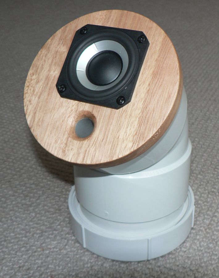

I did a little PVC speaker with it.... Vb=1.4 litre, Fb=80Hz and gets below 70Hz. I added a RL contour network to help with a tad of BSC and with nearfield use. A chamfer on the inside of the driver hole is a must to allow free air flow. 6mm felt was used at selected locations inside the pipe elbow plus 30mm damping in the bottom.
