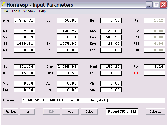

GM said:
Yeah, the AV12-X looks good in a [...] ~11.7 ft^3, 13 Hz TH.
13 Hz and 12 cu.ft !
Damn GM, that's some serious monster ! :D
Show us pics if you build it... :)

Greets!
Just did one, which includes a 0.3 ohms/4 mH inductor, though of course a different value may be required:
