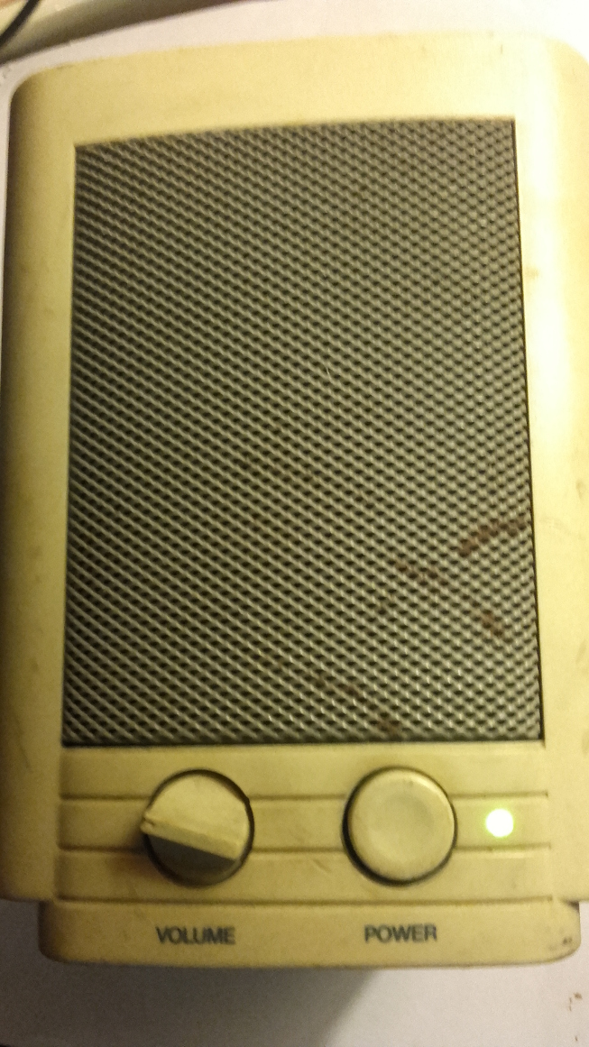

Removing the 3-inch speaker drivers and testing them externally yielded some interesting and encouraging results. Placing them in cardboard boxes generated a surprising level of clarity and some semblance of bass.
The speakers do sound better when 'liberated' from their enclosures. There are several reasons for this, as far as I am able to ascertain. The speaker grille probably cause a lot of diffraction, and also resonances. The box formed by the front of the speaker enclosure and the speaker box also causes some level of 'boxiness' and resonance.

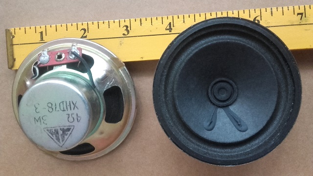

Specifications:
Impedance: 4 Ohms
Power Handing : 3 Watts
Measurements:
Frequency response : 100Hz to 12,000 Hz (pure tone)
Max output : 75 dB at 1 metre

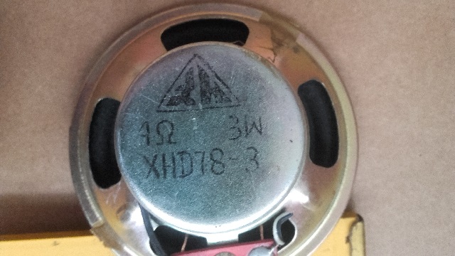

Pictures of Drivers and test enclosure
Pictures of the speaker drivers. These are small units, about 3 inches across and capable of all of 3 Watts.

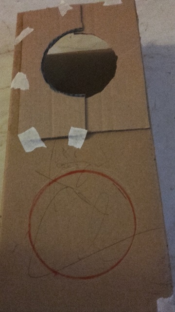

I have attached them to a cardboard box and cut a port of equal size underneath the speaker.
First tests were amazing. Clear sound from the drivers now freed of their cage, and the bass port generated audible, if not sufficient bass. A huge improvement over the original.
I am now convinced of the effects of a ported enclosure, so how do I proceed?

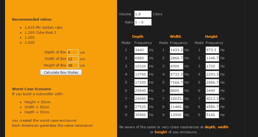

This calculator gives a list of resonant frequencies - do I need to make the box larger?
This calculator gives the port length, is this more or less OK?

Online calculator results
The first site gives a list of freqencies, they are all different for L W and H. This seems OK, however. If I make the box larger I can get the frequencies lower so I get more bass, is this how it work?

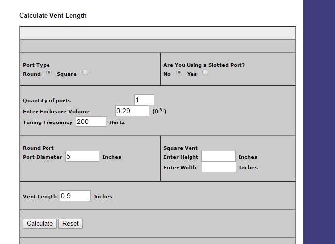

For the size of the box, 0.0635 cu ft, I get the result of 1.84 vent lenght for 2 inch diameter port. "Tuning frequency" is the required frequency? Time to experiment.
Without at least knowing its Fs and effective piston dia. or area [Sd], choosing a cab alignment is a crap shoot at best.
Yes, 'BIB' [bigger is better] rules when trying to get the most bass out of a driver. Tuning frequency is F-box [Fb], i.e. the frequency it's tuned to, which normally would be > Fs if Qts is <~0.403 [Fs tuning] and < Fs for > ~0.403 Qts, but if you don't know what it is, then all you can do is experiment with vent length to find the flattest response and if it isn't flat enough with just a hole in the baffle, then you have to use a larger tube and start over; and if the bass is still too lean, then start over with a larger cab.
Odds are though is that the driver has as high as a 250 Hz Fs with a very high Qts, so the only viable vented alignment is a stuffed TL if the latter is true.

According to the 2cm by 4 cm port is needed for 75 Hz according to this site.
Not sure about square or slotted ports.
