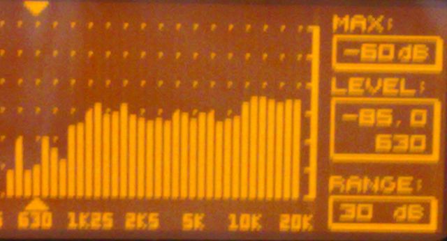

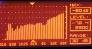

About the tests:
I measured with a calibrated Mic using a Behringer DEQ2496 pink noise... SPL isn't shown correctly, but I referenced to a known 88dB source, so the levels can be extrapolated fairly easily.
The divisions between dotted lines are 5dB.
1) Direct Radiation Response: see picture dm2a on axis direct radiation
the dm2a has an average sensitivity of about 82 dB followed by a "tilted shelf" response starting at 7KHz. The 10KHz level is at about 88dB and the 20KHz level is about 95dB and appears to continue on a strong rising trend.
Comments:
The dm2a response makes it a little tricky to integrate without resorting to lots of equalization. If used in a system at 82dB it will be smooth from 1KHz to 5KHz with a 4 dB dip at 6Khz, but will then have a MAJOR high frequency emphasis and sound quite sizzly.
One could put in a first order roll-off on the top end but this would aggravate the dip at 6KHz, make it very inductive.. and still end up with only 81 to 2dB on axis sensitivity.
Also note, even though the level at 450Hz is about 84 dB, that is due to a major mechanical resonance. The crossover should be at least 3 to 4 times higher to avoid exciting this resonance. Don't even THINK about a 900 Hz crossing unless you like a very resonant vocal band!
Not so good if you want to use these with even a medium sensitivity midrange or woofer. But read on, there IS a way to make this work and work WELL.

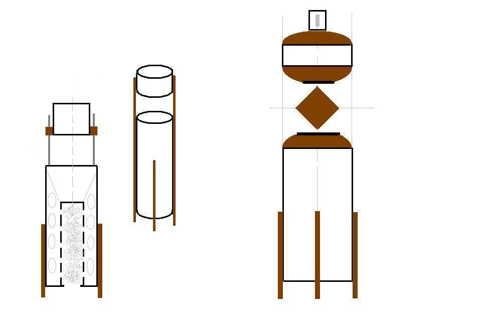

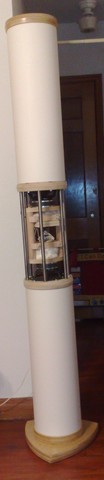

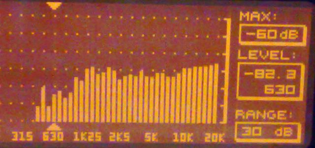

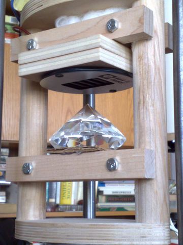

2) Where one could say that the dm2a is not a great choice for direct radiation, it can be SPECTACULAR if used as shown in the picture entitled "dm2a omni mount with deflector"
If you look at the series of pictures of the Omni w. deflector response, you will see that the use of a properly proportioned and spaced deflector adds an acoustic impedance load which brings the response of the combination to a level that is much more than just acceptable, it is very, very good.
Because of the improved acoustic loading (and dig that fancy cut glass deflector!), the average sensitivity goes up to near 88dB across the band and is now very flat, within a +/- 2dB band from 1.5KHz to 20KHz. See the pics of response for the Omni array at 5 degrees below horizontal as well as the responses at 10 degrees above and below.
This array puts out very FLAT response well beyond 20Kz
PLEASE NOTE: 88dB at 2.83V is decent efficiency, but because this response is nearly identical at ALL of the 360 degree circle (It's omni ! It's OMNI !!), the acoustic power output is equivalent to that of a ScanSpeak AirCirc D3004/6600 direct radiator at 94dB. This level of output is about the same as that of the AirCirc … and the impedance is also about the same at 4 Ohms for the dm2a vs 3 Ohm for the AirCirc
I really like the AirCirc... but I may like the dm2a even more...need more time to tell for sure, but this omni array really works wonders.
But please note! the deflector shape and distance play a CRITICAL role in smoothing out the dm2a response. IT WILL NOT BE THE SAME UNLESS YOU USE THE DEFLECTOR ARRAY!! What you see in these pictures is the result of very careful adjustment of the distance between driver and deflector (23mm). other shapes and sizes give different (and mostly inferior) results. I tried other deflectors, this one worked the best... there may be others that work better, so please let me know what you find.
So how does the Omni array sound? Crossed over at 2KHz with a simple 1st order slope, and mid bass drivers at 88dB, the sound is spectacular: open, clear, quick, tremendous impact (impact? From a tweeter? YES!!) and uncompressed clarity that is very hard to beat, even at very high SPL.
Comparing against the ScanSpeak AirCirc revelator, the dm2a in the omni array will give similar levels of neutrality, MUCH wider dispersion at high frequencies, and apparently higher levels of low distortion output with what seems like more impact. And the fact that it can be had for USD100 each instead of USD250+ for the Revelators, well that makes up for the shiny plastic faceplate which covers the (adequately substantial) painted metal housing.
More later, maybe test em with controlled directivity waveguides and the foam bung like GedLee... but that will come MUCH later, if at all. I like this in omni so much that I may never get around to it.
So, anyway, looks like great choice when used in this way.

AMT cost
yes, Jason is making them available at $100USD each...
I think it's a fairly good price given the performance these are capable of. But I do advise users to respect this one warning: they really sound excellent, but again ONLY if used with an Omni diffuser similar in distance, size and angle to the one I used...
and please no jokes about "crystal clear highs" 😀 ....
and , no, I don't really believe the diffuser has to be made of crystal

M&D use their Omni-Harmonizer from 7K on up - and it is made out of marble (they like to use marble don't they). Something a little bigger along the same design lines should work out. If I used 2.5 KHz for the targeted lowest fs then the diameter of the cone should work out to 5.4 inches and 8.76 inches high (golden ratio). So - make a little "snow cone" shaped mold out of heavy paper and mix up a little acrylic plastic and "presto" - I have a diffuser. Or I could turn one out of a nice hard wood - that might have some WAF to it. I would finish things off with BudP's EnABL pattern just for S&G's. Hmmmm - currently have two speaker projects in the Q - plus a couple of class A mono blocks in assembly - so that would make the ETA on this thing - ????? 🙄 Damn - I just luv this little hobby!!! 😎
Dear Santiago,
Won't the usage of diamond deflector, won't the sound be a bit bright😀

Now back to the omni reflector. Will the use of a high grade diamond make the sound brighter (sorry couldn't resist😀 ).
I am sure when you built that the wife approvalbility factor was quite high...

as for sparkly highs, well I think "crystalline clarity" will surely beat "hard as diamonds" so I would still opt for the crystal deflector hehe, just a matter of personal preference I'm sure
but we should never rule out the sparkle appeal when it comes to the ladies, so yeah, go ahead and use that extra pair of 500 Carat diamonds you have lying around in your safety vault....
that way the sound could be .... "sparkly but rich"

I think you should also consider lighting up the diamond from below..... Could look quite spetacular.
If i had a few 500 carats, I might sell it off and get a few other wives....

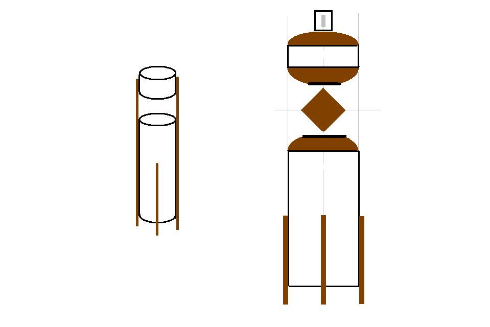

Hmm, using the Dm4 with the Alpair could be a good combo...
I would think that you could put the Alpair at a 60 degree angle, almost pointing up, this would give a near omni response up to about 3KHz or more.... plan on using a coil in series with the Alpair...
definitely use a rolloff on both drivers, don't try to use them in parallel... unless you like screaming mids... I don't!
The detail on the Alpair is probably very good up to at least 6KHz... and putting the crossover point up around 3KHz should give you good results.
Seriously, you want to avoid crossing the dm4 at 1KHz with a 1st order..
Hey I like the idea of the lights... multi-colored LED lights could look really cool, especially if they pulse and glow with the music...
it would give the sound more of that "lit from within" quality...

Omnis have always interested me, since I first saw The Ace Horn with the big impressive diffusor mounted right in the middle of the Lowther driver
I did once build the Super Ace, but with 10" Coral, and they are long gone now
At the moment I am focused on designing something very easy to build, and have also thought about OB
But now I think I will try an omni and use thick plastic tube
I will build a couple of simple protos first, but when my lathe is up and running again in my new home, I will be able to do a better finish
Driver are all Tangband, 6.5" and 4", and maybe a small Fountech on top
Xo will be quite simple, I hope
Cost should be low
Goal is that they should be easy and pleasing to listen to, at avarage SPL

Spaceships?
Hey Tinitus, that space ship looks pretty cool. Looks like it has good potential.
Here is a picture of something I've built that works pretty well with either the Scanspeak Aircirc in front firing mode or with the M&D dm2a
Yup, it's an Omni, and it sounds pretty dang good!
Needs a little more work on the filters, currently am using a Behringer DEQ2496 in digital in/out to correct for some freq response aberrations in the 1kHz and 4kHz bands
I may not change anything further.... it's really good as is. Sounds excellent whether far away from walls or right up against them.
More details later, i may be offering these in kit form once some details are ironed out.
