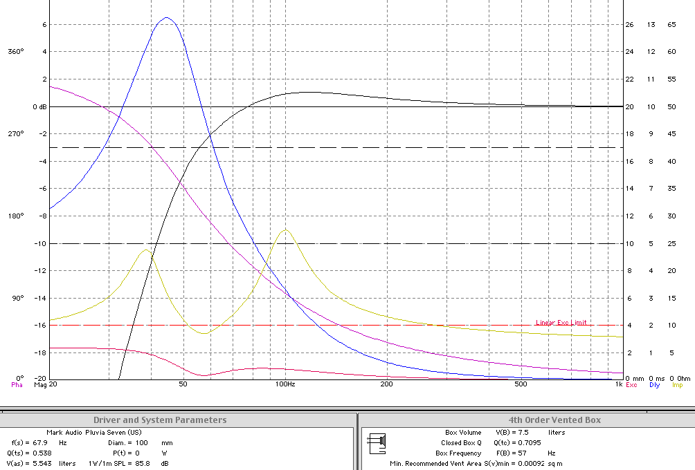

I just did a bunch of sims. Sealed (7.6 litre/butterworth) you are going to get 90 Hz F3, 50 Hz F10. I tried it vented (4.7 to 13 litre) and (with my alignment) i get F10 as low as 40 Hz, the smaller boxes near 50 Hz but with an earlier start to the roll-off. Almost as low as the A10.3. Much like the EL70 in terms of alignments.

I would be wary of putting pluvia in a vented box for any other driver. I have yet to rework the miniOnken for this driver, but it is closer to the EL70 than the CHR70 as far as boxes go. You could put it in that volume but you would very likely need to change the tuning.
dave
dave
Likely just a change in length. 7.5 litre they say tuned to 57 hz.
The factory tuning has a bit of a bump in it -- ideal if you use a high aspect ratio vent to knock it down (full width, 12mm tall, 147mm long). 1.5" (38mm) plumbing pipe is easy to get, 113 mm long but bass may be a bit fat, maybe boomy (vrs the slot).
