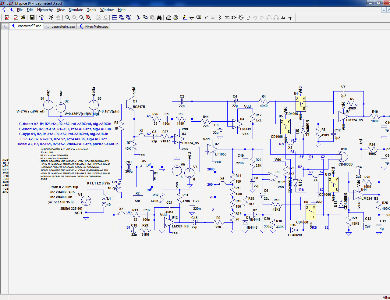

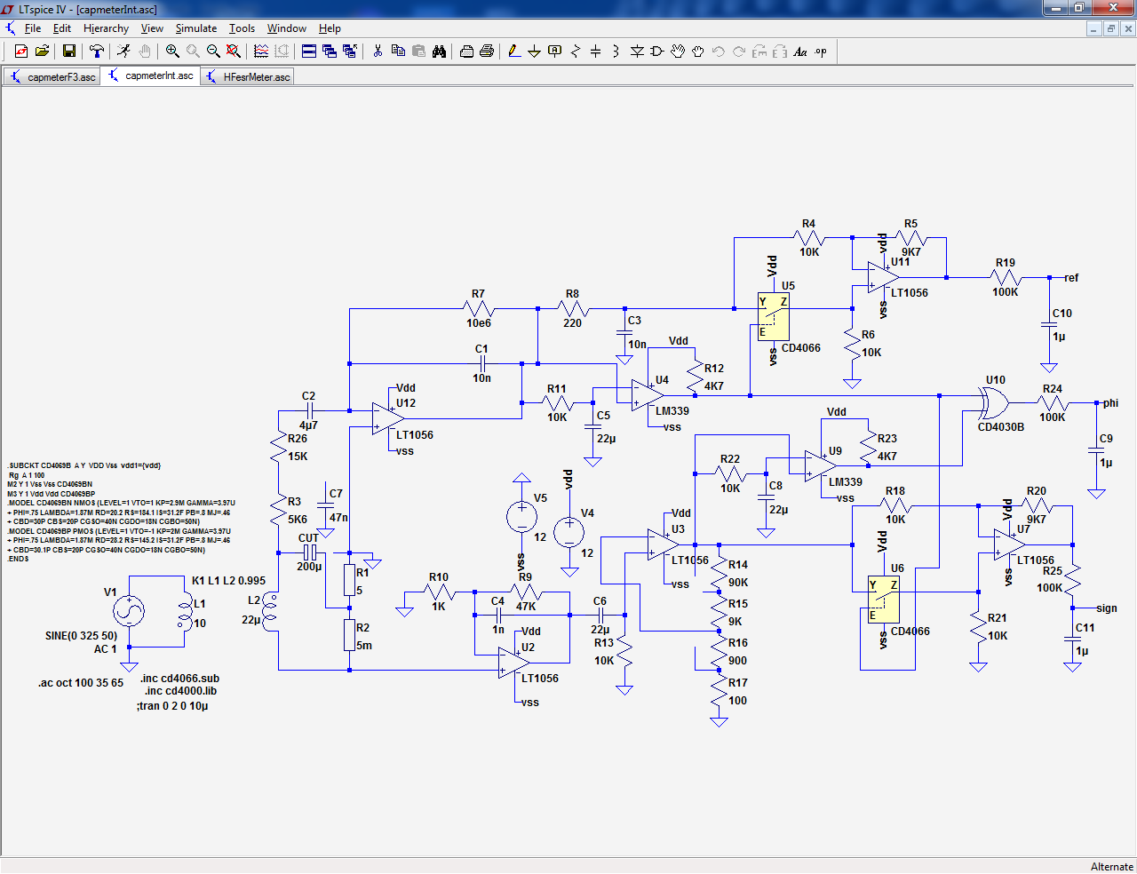

It may be worth reading through the ESR meter(s) prepared by Jay_Diddy_P on eevblog (ESR Meter Adapter Design and Construction - Page 1). I set that circuit up (well almost the same) and it was certainly accurate for resistors, but I could only make subjective measurements for ESR of caps (although they seem reasonable).
Testing at 100kHz can require more attention to the analog mux switch (eg. 4053) and layout, as leakage signal increases, and I ended up just 1kHz or 10kHz. Maybe the PIC can acceptably do the oscillator and mux functions. I certainly found the use of an instrumentation amp a benefit due to ease of offset trimming and stable but high gains if you want an analog display of V=Ohm.

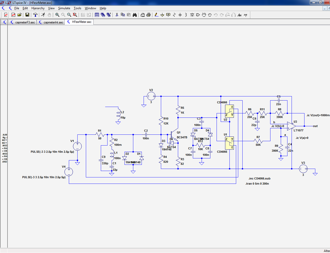

A good, SOTA example. There are many ways to skin a cat though, and I often use slightly different schemes.
The absolutely minimalist option uses a single switch; it can be 1/4 of 4016/66, a FET or a small MOSFET.
It is simplistic and works OK at low frequencies, but it struggles at higher frequencies.
Here is an example (U5, U11 and U6, U7).
The switch and the 10K resistor can be swapped to reverse the phase:
Here is another example, using 4053's (simulated with switch and inverter).
This time, the input resistor is upstream of the switches, and the integration is performed at the opamp level.
The gain is 1/2 than the peak rectifier used by Jay Diddy, but the switches are completely protected, they see 0V all the time across them, they just steer currents, and the averaging at the opamp level gives a much better immunity against imperfections, like small ringing due the inductance of the test leads:
It is also possible to insert an amplifier (here 20dB thanks to the transistor) between the CUT and the sync-rect. It is advantageous, because the DC accuracy does not matter at the AC level. This means that the DC post processing doesn't need to be particularly stable or low offset:
In general, since the 4053 has 3 operators, it is possible to connect another operator in parallel, but with the control in antiphase and the input to the GND or better, the GND sense line in 4-wire configuration.
This will restore the gain to that of the peak-detecting circuit, but without its drawbacks, and with some charge-injection cancellation.
These are just a few examples, it is a vast subject

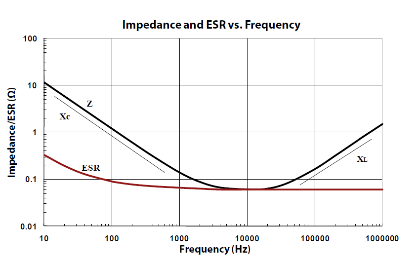

In the vector world, things are a bit more complicated : Z²=ESR²+X²c
Thus ESR=sqrt(Z²-X²c), but in practice this will only be workable when ESR and Xc have not too different values.
For smallish values of ESR, Xc and Z will become indistinguishable: Z is the hypotenuse of a right triangle, and when ESR is small, the other triangle side becomes almost equal to the hypotenuse
This procedure chooses a test frequency for ESR measurement, where there is just about the least possible pollution by Xc and by Xesl.
Presto. You've found a test frequency "fTEST" which is midway between the capacitance-dominated region at low frequencies, and the equivalent-inductance-dominated region at high frequencies. Run your ESR test procedures at fTEST and be happy.
- Measure |ZL| = magnitude of impedance at a low frequency, e.g., 100 Hz
- Calculate CL =1 / ( 2 * pi * 100Hz * |ZL| )
- Measure |ZH| = magnitude of impedance at a high frequency, e.g., 750 kHz
- Calculate LH = |ZH| / (2 * pi * 750kHz )
- Calculate fTEST = 1 / [ 2 * pi * sqrt( CL * LH ) ]
