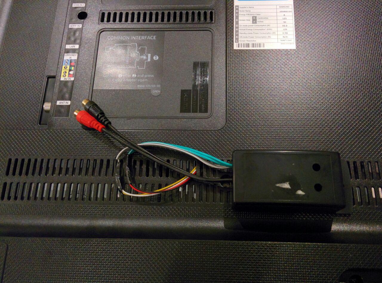

I've even done that too........
found the connector online, lucky they just used a standard jst...audio is better but much quieter on the rh channel... so still not right.

with the yellow connector connected to the board is its red connector on the far right as is shown with the white connector ?
Say what now.........?! The yellow connector was the OEM plug to the speakers, the white one is the one i replaced it with so i could connect the high to low level filter without damaging anything.
I understood that the white plug was replacing the yellow plug. But because the sequence of the wires in the two plugs is not the same in the photo, my question was really is the yellow plug as shown in the photo
upside down from the way it would be plugged into its socket. I suppose it is but not familiar enough with those plugs to know that.
the colours are irrelevant, i just used to pinouts diagram on the board to know which one was r+- and r+- ...
