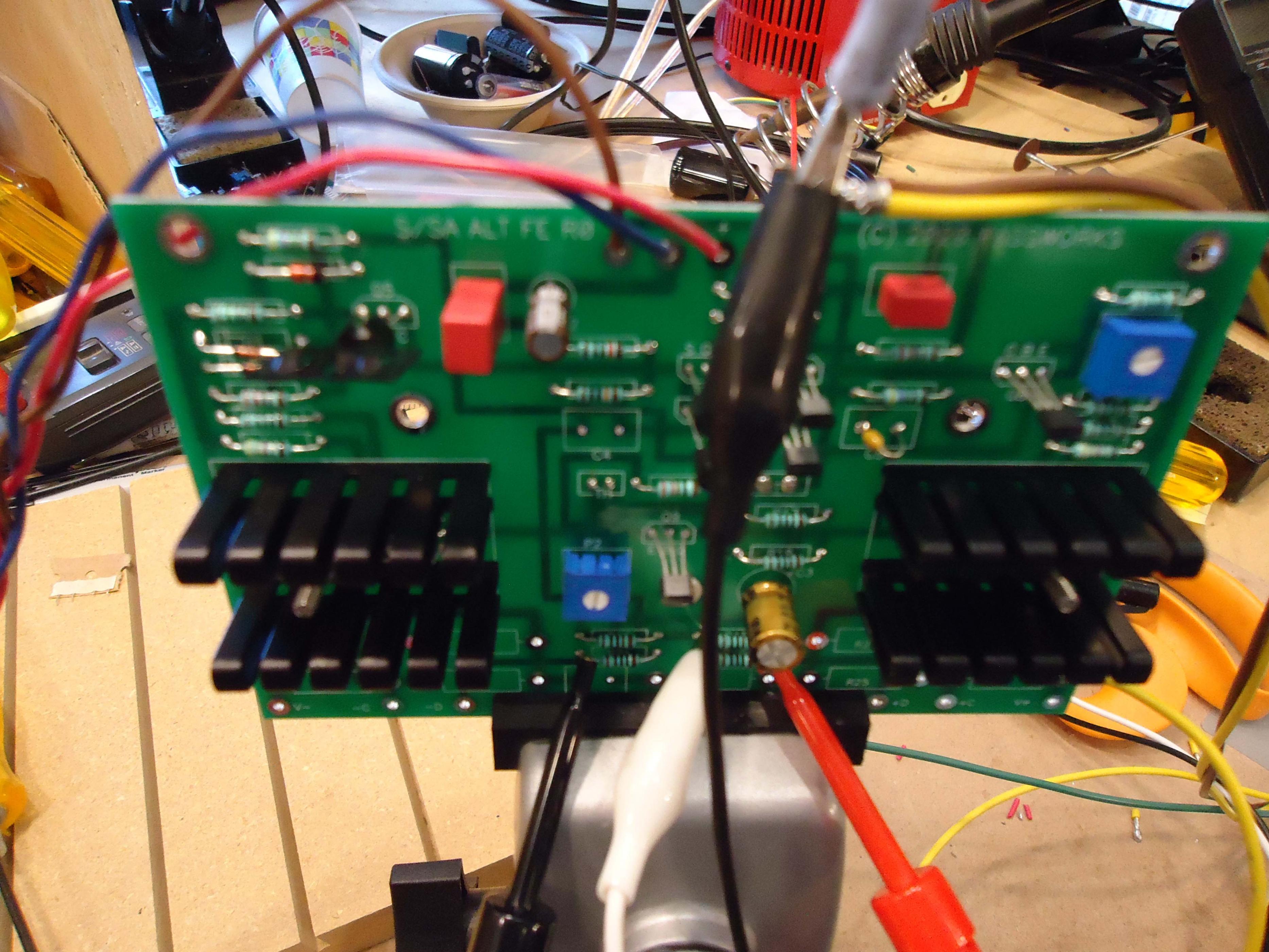

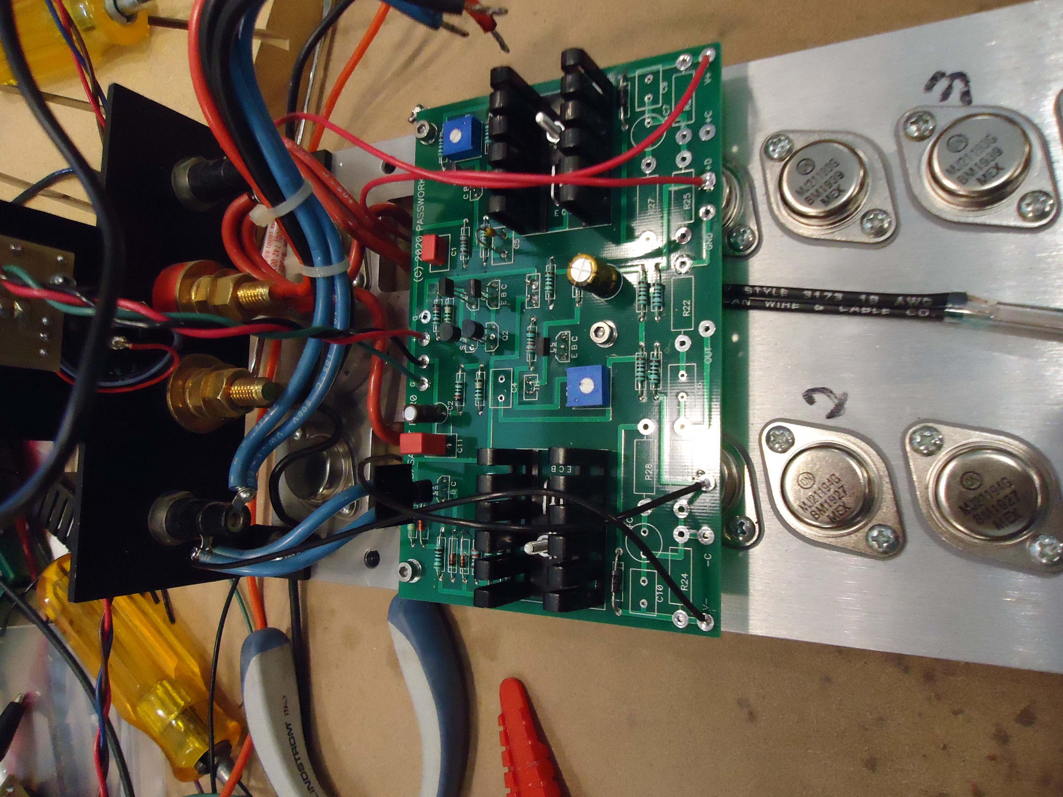

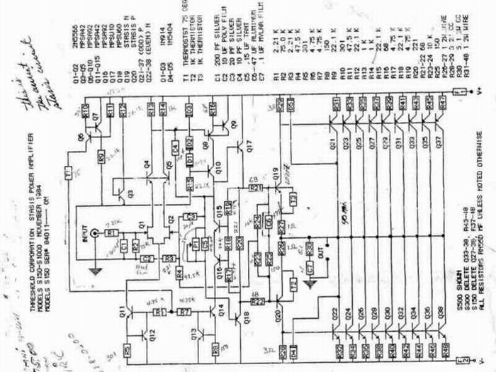

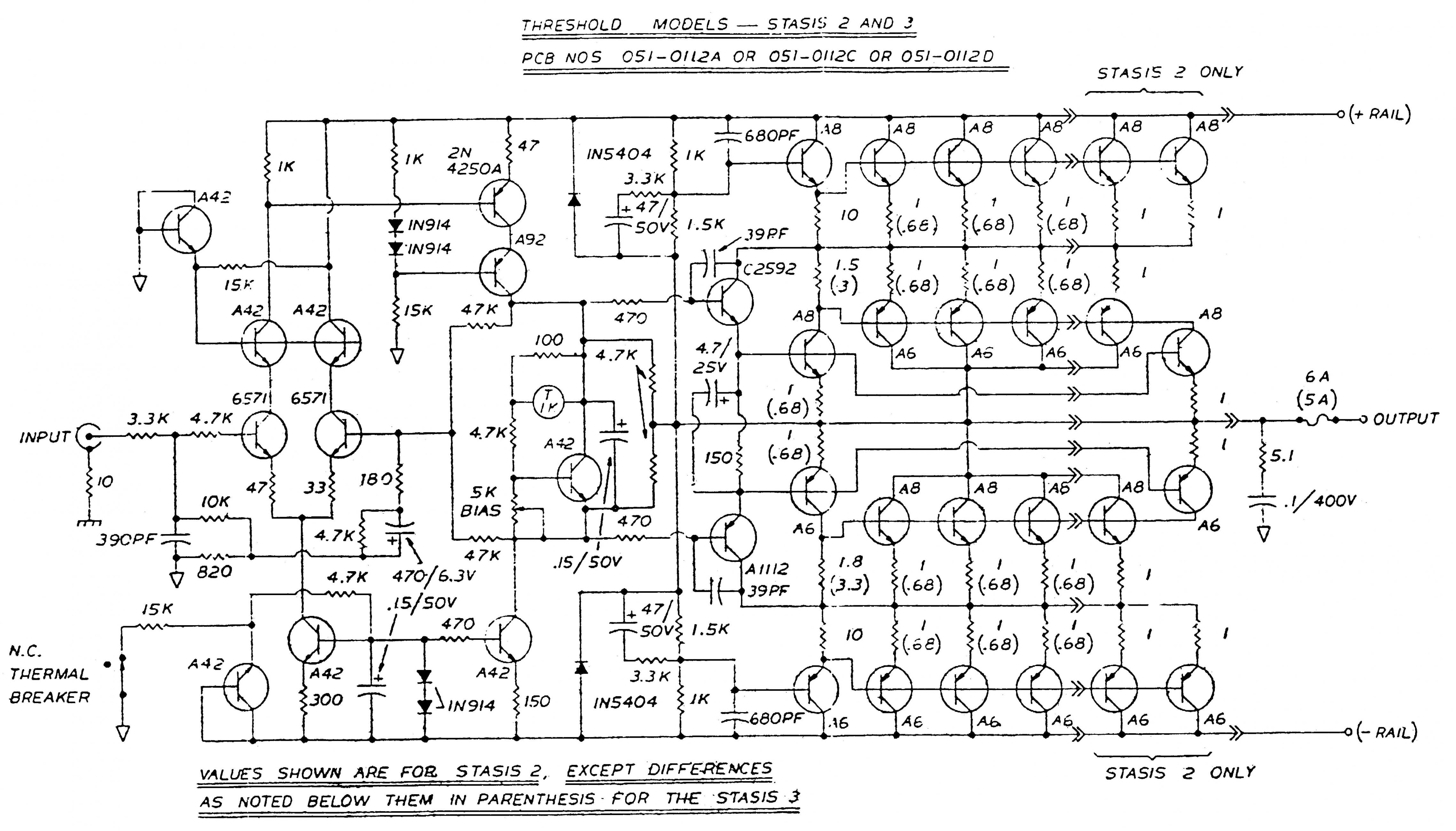

Not too long ago I received a request for some help from an owner of
an old Threshold Stasis amp, whose amp was broken and where some
previous work had left some issues with the circuit board.
As many of you will know, I have lots of time on my hands 😉 and a
sentimental desire to revise old product in light of the wisdom I have
acquired in 50 years.
So.

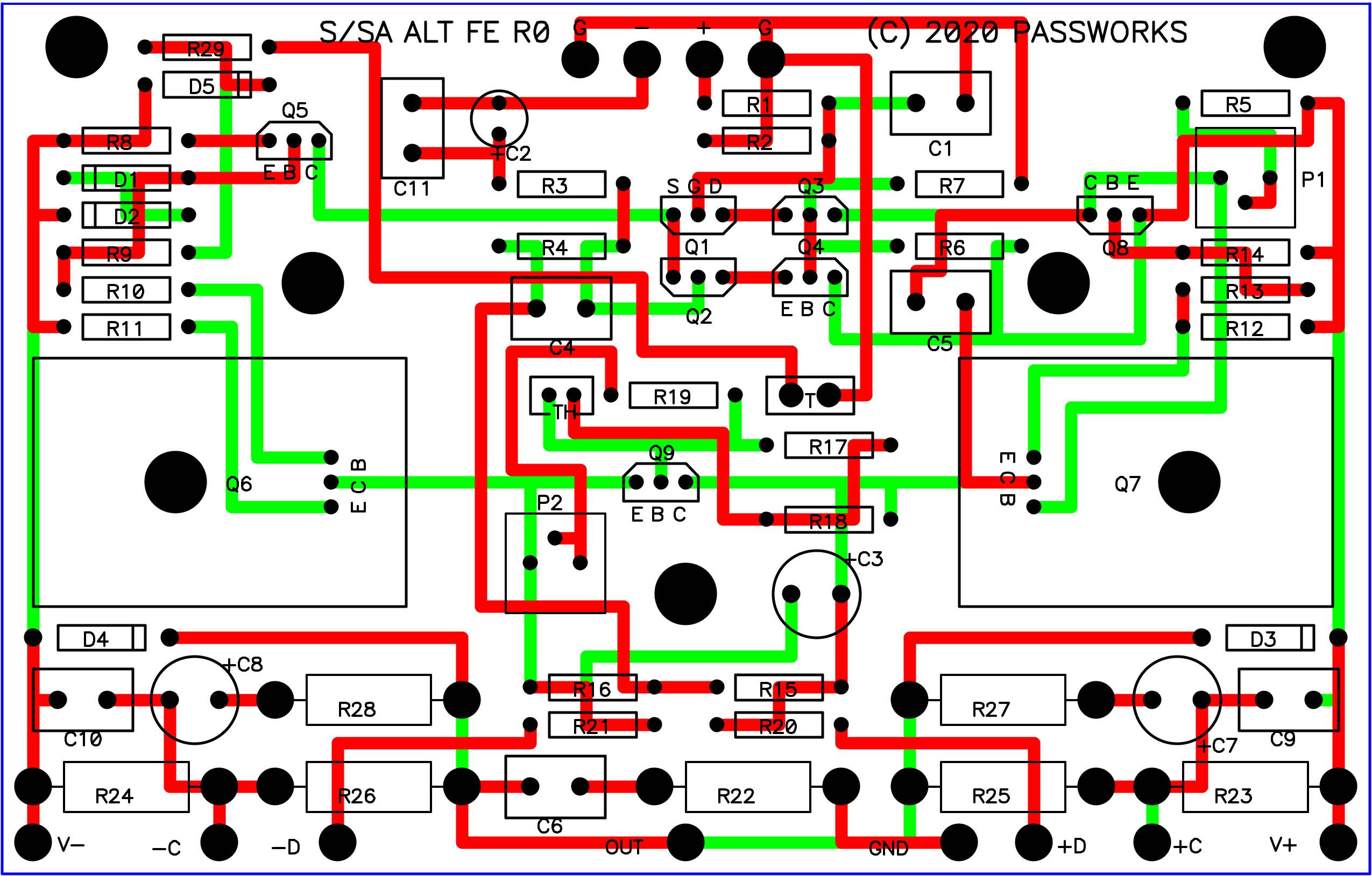

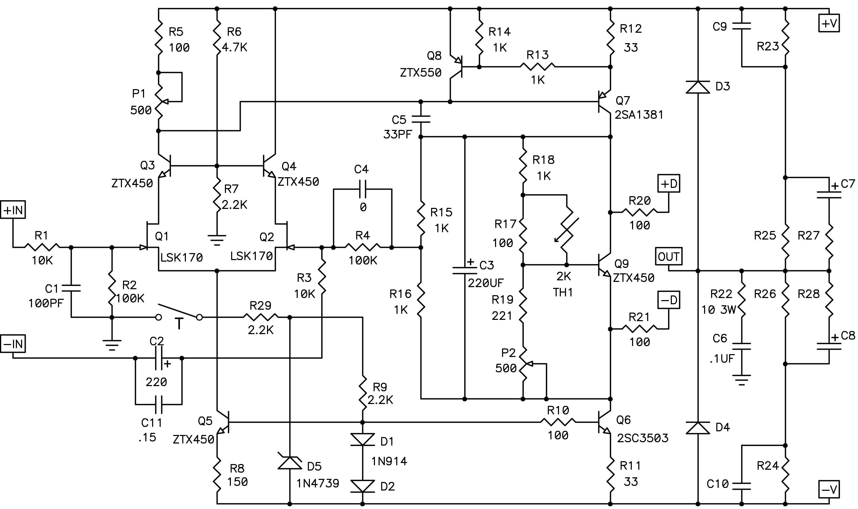

I revised the circuit, making it more simple, and laying out a circuit board
which should be usable for all known versions with minor adaptation.
Attached are various schematics and graphics and also the gerber files
for the circuit board, which was made my pcbway.com, who will ask
what dimensions are, which is 5.5" x 3.5"
This thread will also serve as the location for asking additional questions
and so on.

Well Nelson you have opened a pandora's box with this thread - you are so very generous. I may as well say that I will be building a Stasis 2 or 3 copy now. Can I ask the following based on looking at the new design.
1. What is switch "T" for?
2. TH1 = 2K - is this NTC or PTC and I assume should be attached to the output stage heatsink?
3. What are recommended +/- DC rails to build a Stasis 2 or 3?
4. Any recommended subs for the 2SA1381 and 2SC3503 - I would say the KSA/KSC types will be fine or perhaps the newer Toshiba TTA004B and TTC004B types?
5. P1 adjusts output offset I assume?
6. P2 adjusts output transistor bias I assume?
7. What is recommended bias per output transistor (Stasis 2 or 3)?
8. For single ended input - I assume one simply grounds the -IN input?
9. What are C9 and C10 values?
10. What are R23 and R24 values?
11. What are R25 to R28 values?
12. Whar are C7 and C8 values?
13.What are D3 and D4 types?
I hope I have not over whelmed you with these questions, but I am sure answers will be appreciated by many members who may want to dabble into some past Threshold history, to bring one of these classics into the new century.
Thermostat
Classic thermistor - resistance goes down as temp goes up
30V to about 60V, I think.
Something nice that fits. I recall using KSC2690 and KSA1220
Yes
Yes. Maximum resistance on first start up
Whatever settles in to 50 deg C on the top of the sinks operated for
a hour with the cover on
Yes
680 pF was the value for Stasis 2 and 3 - it's on the schematic
and those parts are only to drive cascode outputs - not used
on later models.
Typical 1K 3W
Typical 1.5K 3W
10 to 100 uF
1N4004 or higher current for flyback protection.

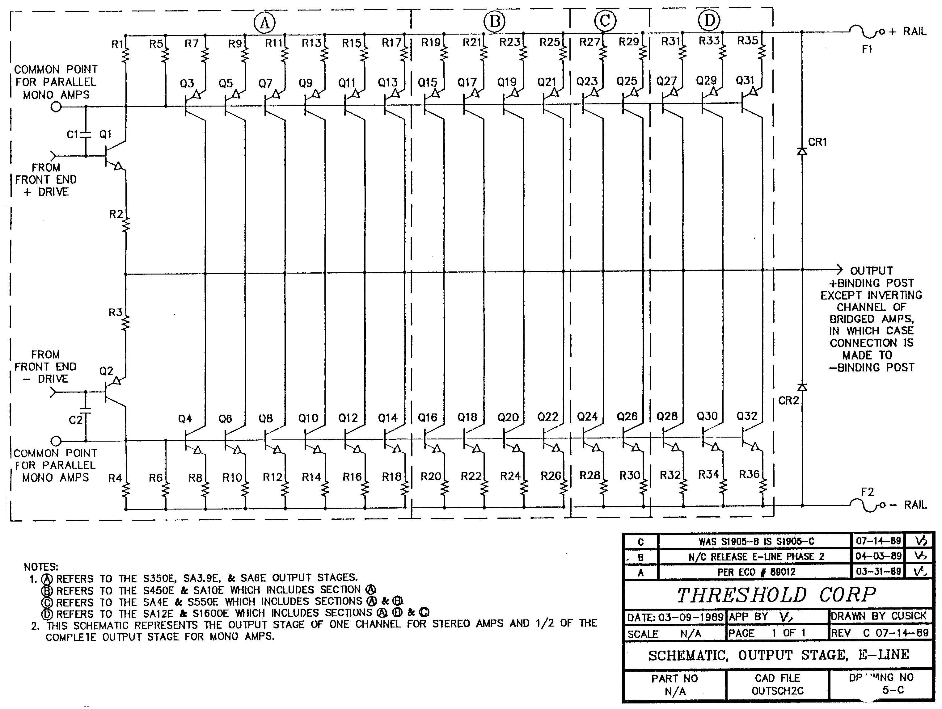

Thanks for those replies Nelson - you are awesome.
Just one other question, to build a simple output stage to say deliver 50 watts rms into 8 ohms, and with 30 to 35 VDC rails - how many of the MJ21193/94 TO3 output devices would you use per rail and what would be a good emitter resistor value?
