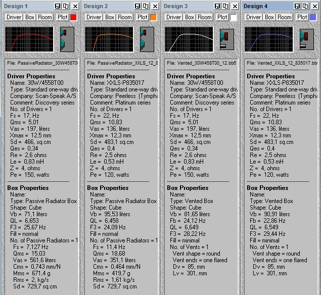

Ok, so I'm going to post now some pictures of the 4 systems...
For each Driver I did the passive radiator/vented system calculation so that the F3 value would be the lowest possible without degrading the curve response, I also didn't want a BIG box so I tried to create a medium size box.
Design 1 (RED)- Scan Speak with one PR (F3=25,67Hz; damping= typical)(Venclosure=73L);
Design 2 (ORANGE)- Peerless with one PR (F3=24,09Hz; damping= typical)(Venclosure=97L);
Design 3 (WHITE)- Scan Speak vented (F3=28,22Hz; damping= minimal; vent type - one flared end with a diameter of 8,5cm and the length of 30,1cm Fb=24,12Hz)(Venclosure=85L);
Design 4 (BLUE)- Peerless vented (F3=29,48Hz; damping= minimal; vent type - one flared end with a diameter of 8,5cm and the length of 30,1cm Fb=22,86Hz)(Venclosure=94L);

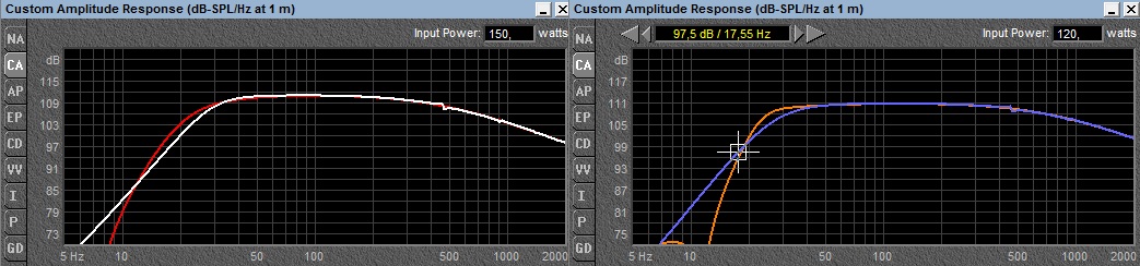

Ok so I tried to compare each driver with the PR and the response curves are as fallow... (I peaked the power to 120W for each driver because the ScanSpeak as 150Wrms and the Peerless as 120Wrms).
But... moving on... 😎
Now comparing the drivers in vented mode...
And finally the comparison of the costume amplitude response for the Vented and passive radiator boxes.
Ok, so to my conclusions:
Between the PR enclosure I think that the ScanSpeak is better than the Peerless driver.
Between the vented both the drivers perform as I expected.
Between the PR and the Vented enclosures the ScanSpeak is the one closest to the vented enclosure.
Now for the final thoughts:
I think the PR with the ScanSpeak driver is a very good choice... but I also think the Vented for both drivers are very good...

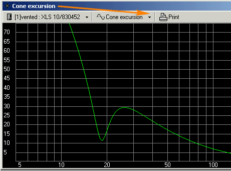

@ RuiSilva
Your last screenie "some pictures of the 4 systems" is too small to view/read. Can you upload it again, but larger 😉
Here's where you'll find "cone displacement curve" in WinISD

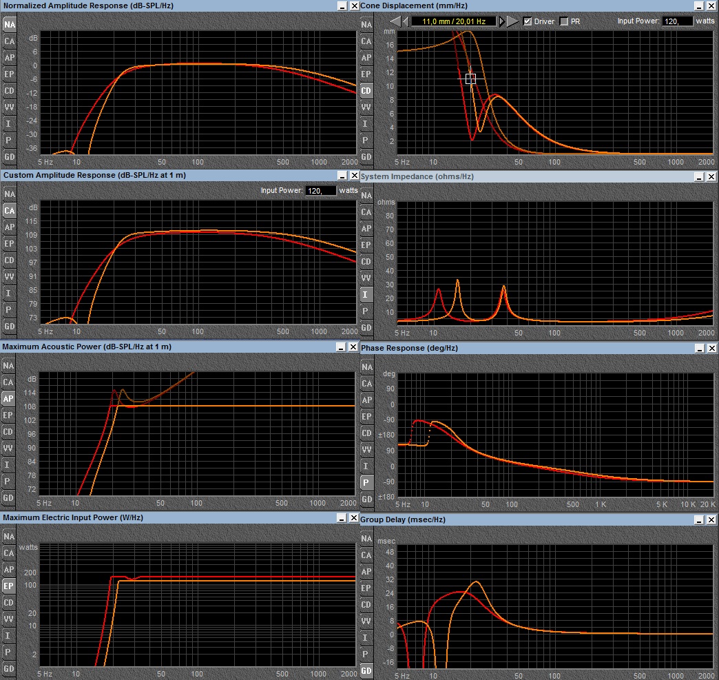

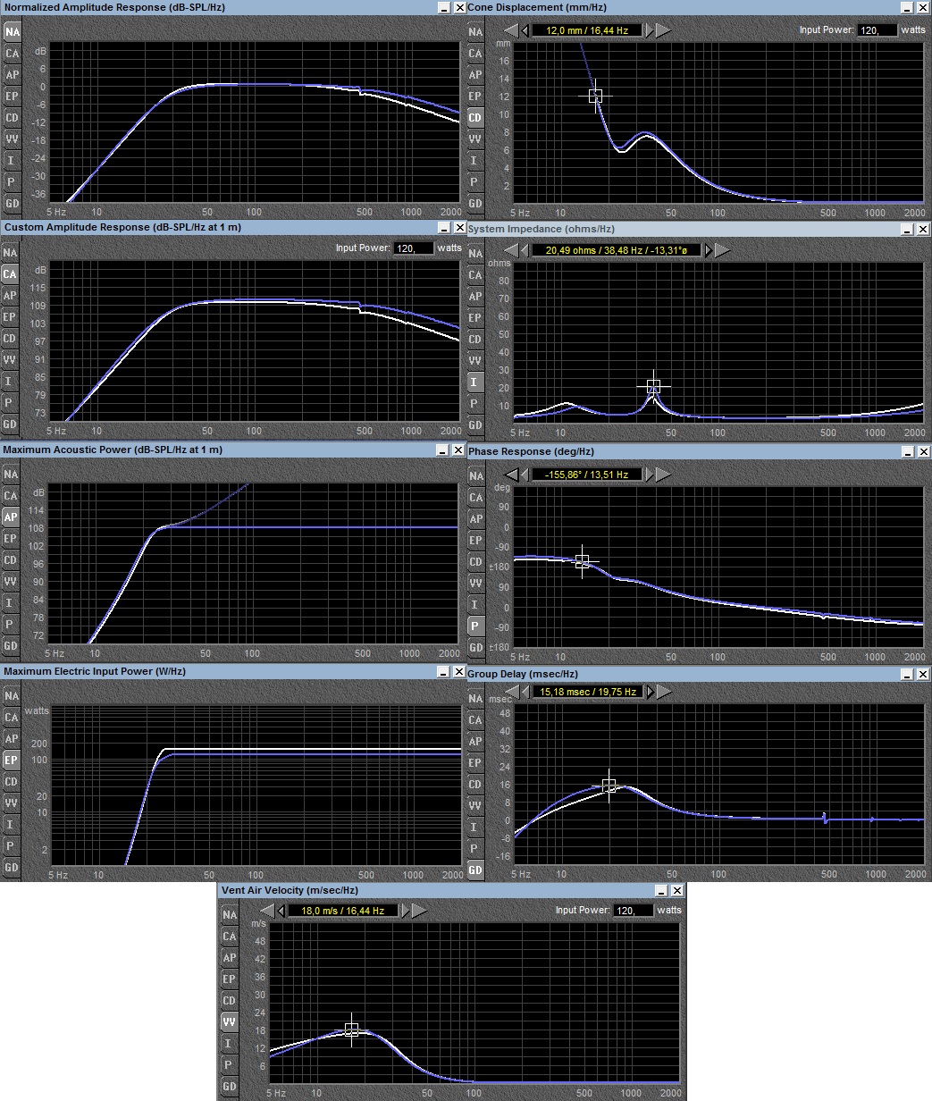

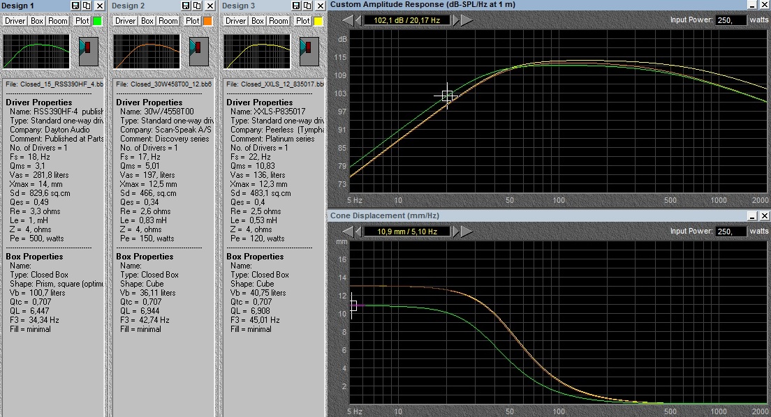

Hello fellowship of the DIY! 😀
Sorry Zero D I don't know why but that image is really small, here is a new one.
Revboden thanks for your reply, I am thinking on a Cubic design (I know it's not the most appropriate design) the room as 42m^2 (452ft^2). The sub will mainly be used in Home Cinema, the box should be between 100-150L.
After johnr66 post I read more about vented and closed enclosures designs and I did some analysis on some of the parameters of these three drivers.
First of all I read that closed design is better suited to the Home Cinema buff then the vented one. What I read is that closed boxes is for listeners looking for sound quality driven system that is clean across the entire frequency band, something that a vented one can't do without engaging in a big volume enclosure.
I know now (always learning new things!) that if the EPB is lower than 50 it's recommended to use a closed enclosure, and if the EPB is higher than 100 you should go vented, and everything between this values is your choice.
The Effective Bandwidth Product (EBP=Fs/Qes) for the given drivers are:
Peerless - 55
ScanSpeak - 50
Dayton - 36,7
I'm going for the closed design, seems to be a better choice due to the fact that I want a better sound quality across the entire frequency band and I don't want a big box in the room.
Now for some numbers:
Peerless
-12dB @ 22,48Hz
F3 = 45Hz
Max dB(@120Wrms)= 110.6dB
Maximum X(@120Wrms)=9.05mm
Xmax = N/a
ScanSpeak
-12db @ 21.68Hz
F3=42.7Hz
Max dB(@120Wrms)= 110.8dB
Maximum X(@150Wrms)=10.1mm
Xmax = N/a
Dayton
-12db @ 17.44Hz
F3=34.3Hz
Max dB(@250W)= 112.2dB
Maximum X(@250W)=10.9 mm
Xmax reached at 415W
Maintaining the input power at 120W and comparing the acoustic power at 20Hz the Peerless and the ScanSpeak will give 96dB and the Dayton will give 99db.
Now analyzing at their maximum input power (for the Dayton I will use the 250W and not the 500W because Xmax was reached at 415W and I think this input will be enough!) at 20Hz the Peerless gives 96dB the ScanSpeak 97dB and the Dayton gives 102dB.
I'm going to post some images of the amplitude curves and cone displacement for these three drivers at an input of 250W, this is only to show the difference between the three drivers.
My thoughts are that the ScanSpeak/Peerless are two very similar drivers in closed enclosures.
The dayton has a better amplitude response with a better cone displacement within the same power input.
Because I'm leaning to a closed design I think the dayton will suite me better, mainly because it has more power in it and slightly better amplitude response.
Note: All the above designs are for Hi Fidelity in order to have best flat response as possible. :cheers:
Looks good,
I know the rss390HF-4 very well and something is wrong with the BBP model, you'll need 158L to get a Qtc of .707 a external box with external 23"h x 23"w x 24"d box with a double thick baffle board would get you that.
With a little EQ to bring the top end (30-80hz) down a bit The 390hf makes a monster HT sub. 😀
You can make a BR box sound as good as a sealed box but you have to tune it very low (14-16Hz), so you are correct, that requires a large box.
edit: If you want an example of a very good sounding ported sub using 6.3ft^3 and a rss315hf-4 I made one. http://www.diyaudio.com/forums/subwoofers/197238-my-little-build.html

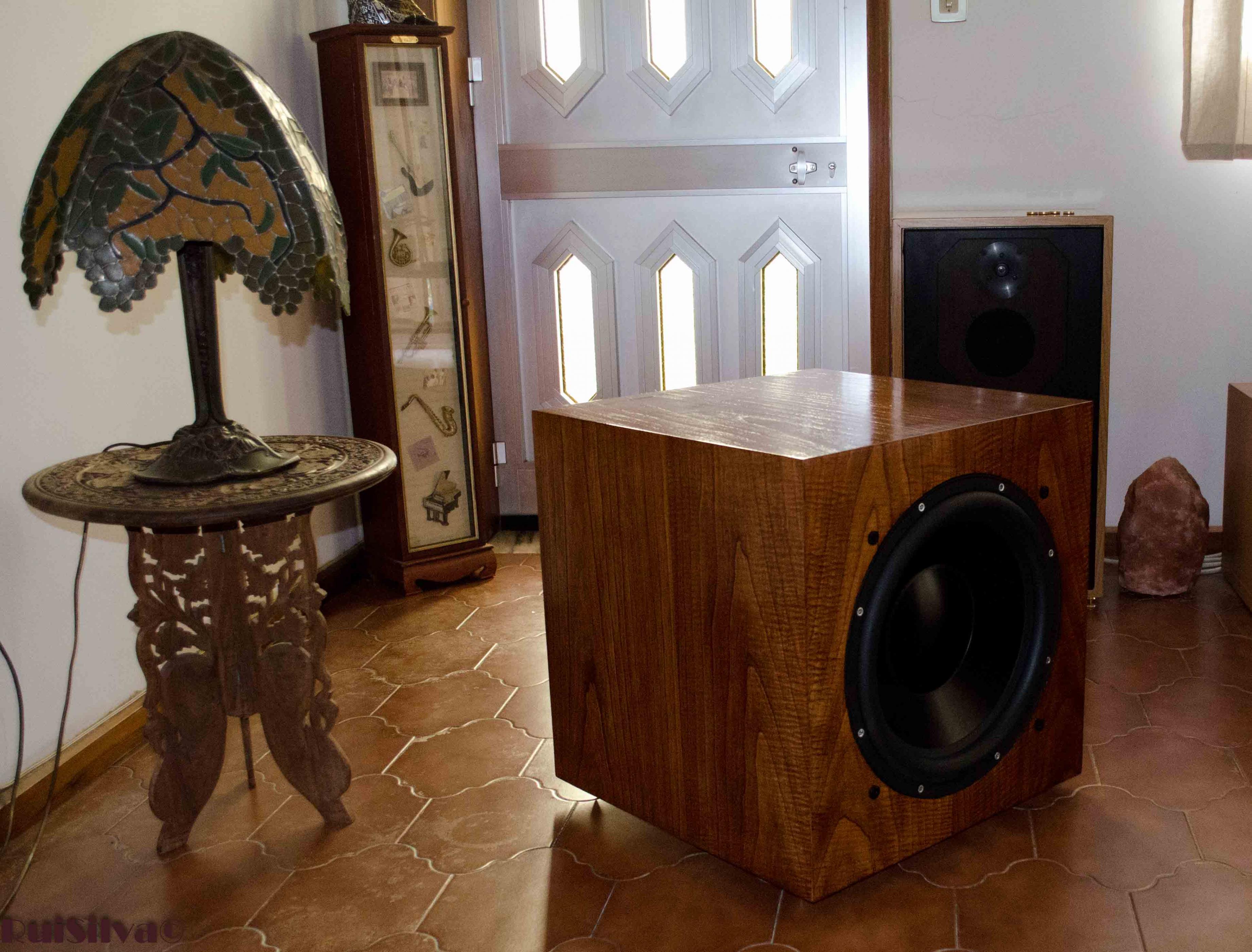

FINALLY!!!
Allrighty then😀!!!
I've made it!!!! And it sounds like a piece of art, musically it's warm like I can't describe it's evolving, all the sound specter is present, the sound pressure is amazing for a sealed box and its accuracy is amazing. My SACDs like Diana Krall, Patricia Barber, Sting, Sade and etc, sound rich like never before.
I've never imagined that a well built subwoofer could have such a outstanding impact.
Don't get me wrong I know a sub is a good piece of equipment for both music and films but the subs I've eared where not has harmonic and sound pleasing as this one.
Maybe they where misplaced, but mostly you could know where the sound was coming from and it wasn't tight and not as accurate.

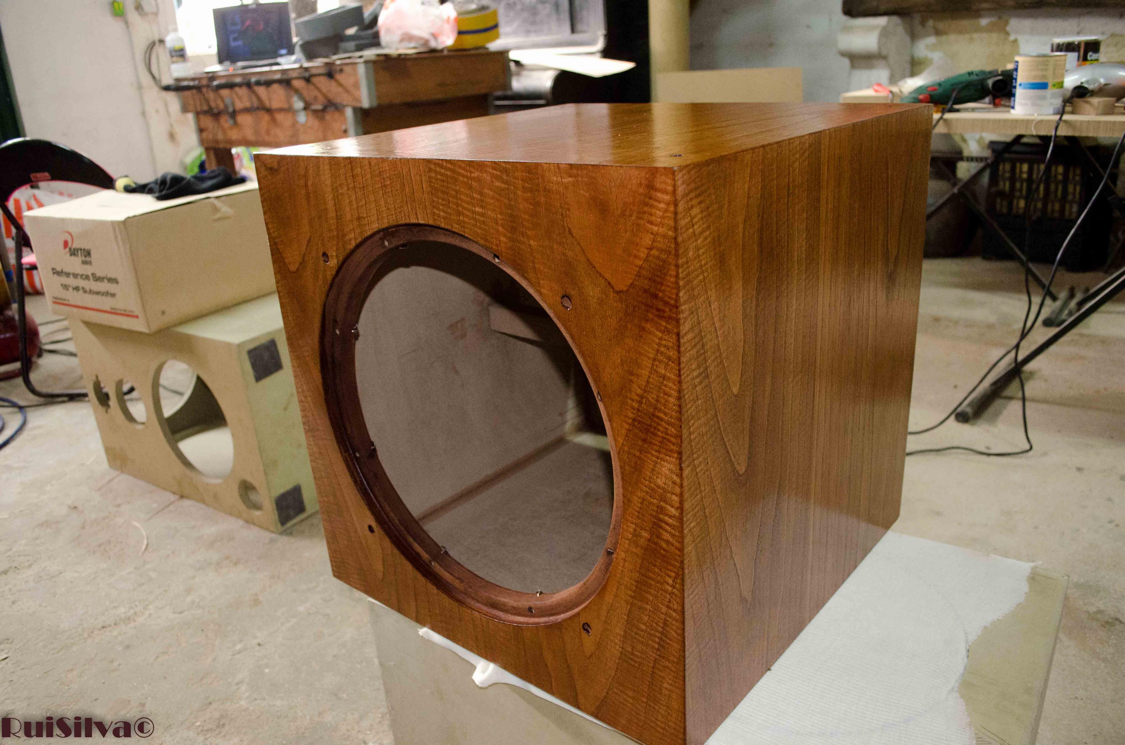

OK, now why the wait, why didn't I wright a single word since my last post?
Well, after I placed the order of the speaker and spikes, they didn't have the spikes in stock, and I've waited 4 weeks for them to be available in stock and another 1 week to be delivered. The minute I've received my order of the speaker and spikes, I started to build the box, 3cm MDF, and middle bracings the box was waterproofed with a sealer, then I veneered it with Oak, stained it, applied the spikes and the frame dowels.
And here is the picture of the box...
Then I placed the order of the plate amplifier, the Hypex DS4.0, and guess what it also was not in stock! Ok so I waited... waited for 1 month and sent an email, no response, waited for another month, sent an email and phoned to the company, no reply. After 2 and half months the brand product got out of the site which for me could only mean the company I was buying from (EuropeAudio) and the Hypex parted ways... It was a really bad sign for me...
After 3 and a half months I talked to a friend of mine that is living in Holland so he could call the company and... he did and they said that the product was coming on a Friday, after it was in stock they took 2 entire week to sent me the Amp... Neitherless to say that I am really skeptical about working again with a company that doesn't respond to emails and to phone calls. I even wrote an email in Dutch!!! and even so no reply...:h_ache:
When it FINALLY arrived I damped the box mounted everything and it finally was completed!!
Here is my final picture
The total mass of the sub is of around 60Kg and it's a cube with a length of 50cm.
Then I searched for the perfect spot for it... the famous knee search! (some of you may say...what the hell is that!! Well... although you can't (shouldn't is the right word!) locate the spot of subwoofer, for that to happen you have to listen to music rich in bass (I advice to a soft bass rich music) and then position the sub on your listening position, afterwards you have to crawl on your knees searching for the perfect sound! It should be where the music sounds perfect in every frequency the sub is outputting and it doesn't sound out of control.
I then tested it with some DVD DTS (War of Worlds) and DD (Star wars, the Pod race part and THX presentation) blue ray movies with DTS HD MA (Avatar, Riddick and Bourne).
The THX presentation with the sphere and the lighting strikes your clothes trembles and your jaw opens, NOW it really sound like you’re in the middle of it all! The Mechs in Avatar sound amazing as of course the explosions the ships and all the bass rich track that the almighty powerful LFE can give with a good sub!
As you can see behind my subwoofer there's my Left Front Speaker, my rear speakers are equal to this one, only my central as only one tweeter and two midrange.
I've heard people saying that Basstronic is a real test to the sub, taking it to the limit and the sub handles it perfectly.
