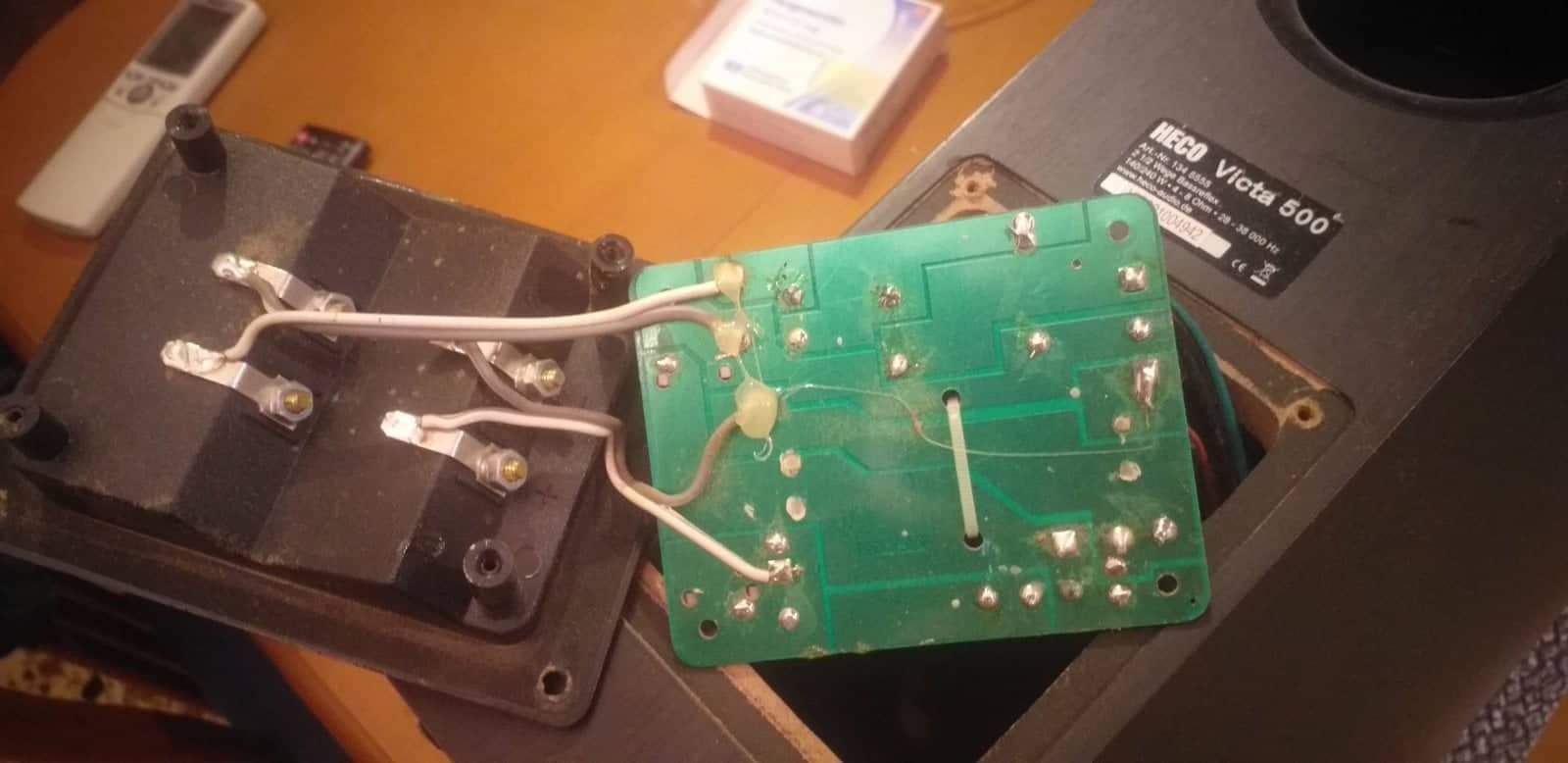

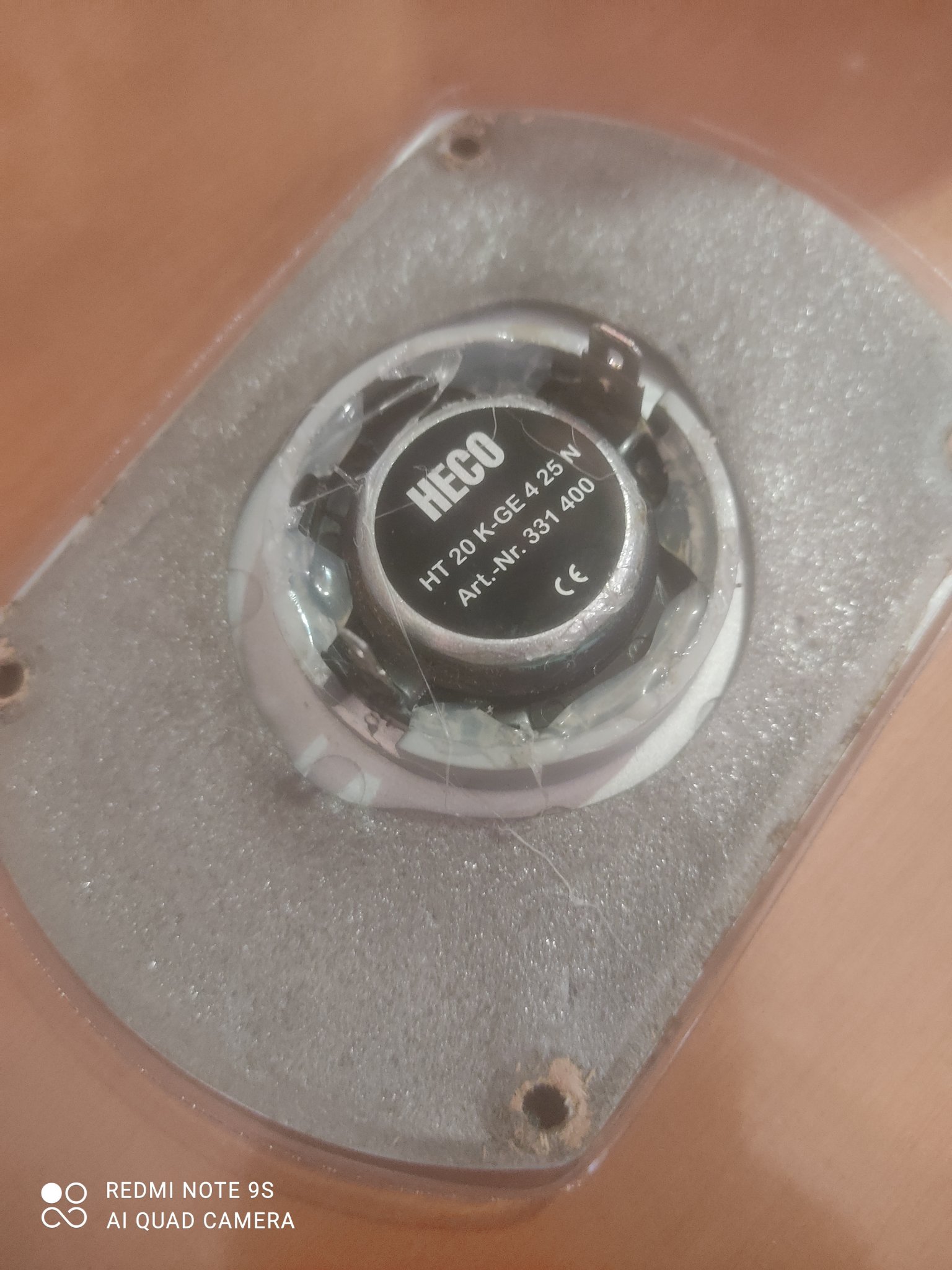

Hi everyone. Im new forum member, Im looking to repair my Heco Victa 500 with new tweeters. The old ones have burned out 2 times and and look very cheap. Im not willing to put them again so im looking for 2 new and must be matched and product at least the same quality of sound (why no better). Im from Greece...i could give 40-50€. Any suggestion??? (and sorry for my terrible english..not my first language..i will use ebay to order them..i think) And some photos which maybe help you with suggestions (last pic is dimensions cm*). Thank you

Are there any marks on the original tweeter that can suggest its mfg?

As a last resort try to leave the Heco sticker and have a look under, to see if there is a mfg logo and part number.

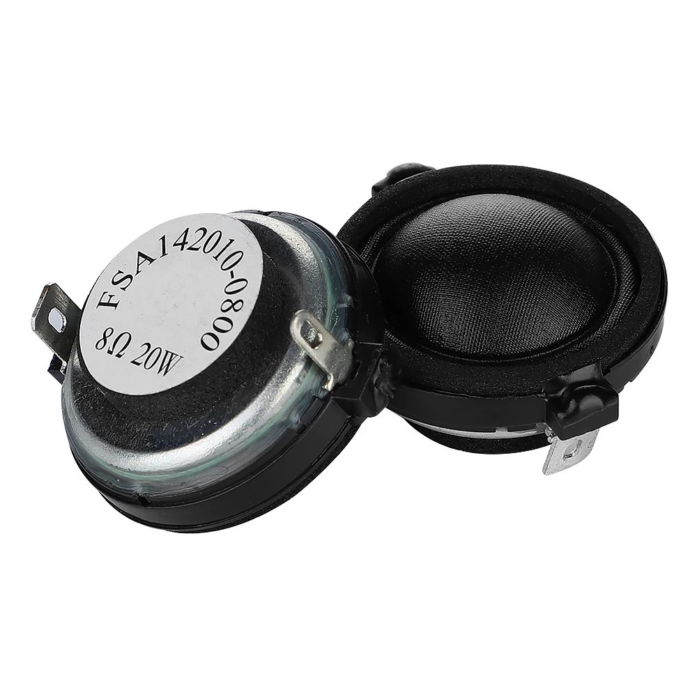

Thank you all for the help. So, to close the thread, what do you suggest between Monacor and Aiyima?
Aiyima is 20 watt max or rms? because monacor is 25 and 30 watt RMS (the 2 models)
Aiyima, Monacor dt-75 or Monacor dt-100?
If the original tweeter is a 4 ohm model it should be replaced with another 4 ohm model. Otherwise, you may have to make component changes in the HF filter.

Also, can you give details of the crossover - photos of the crossover board or photos of the individual components, if not mounted on a board.

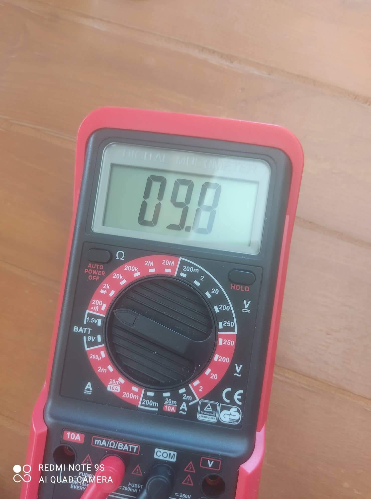

I measured it and it says numbers between 9,5-10 ohm. Im talking about tweeters

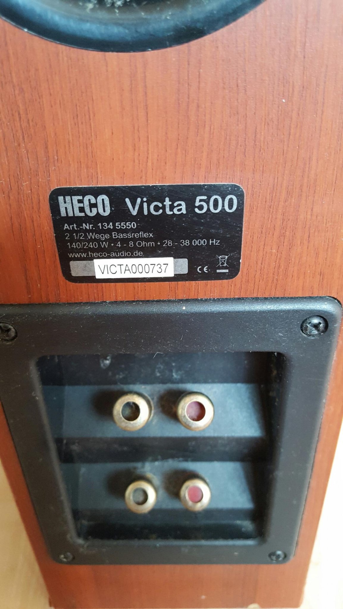

im working right now and dont have the speaker with me at the job 😛. I will measure it when ill go home. This is the speaker (from internet) and this is our multimeter. How i will measure it? what i will choose and where i will put it ? black/red up? or down? and i have send photos of crossover when i opened the thread..but if you need something more i will send you when im home. Thank you for trying help me(again)

OK. The label on the speaker says 4 to 8 ohm.
Your meter reading seems on the high side. Remember to subtract the resistance of the test leads themselves, although that should only be a small fraction of an ohm.
The terminals allow for biwiring. As there are no metal links between the top and bottom pair of terminals I presume you are, indeed, using separate cables from the amplifier to the top and bottom terminals?
