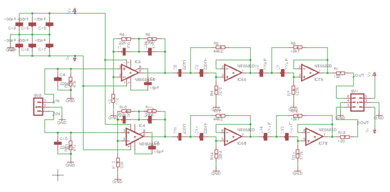

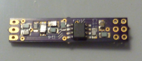

The new version features a lower noise front end, but is a bit more cramped as a result.
There is a NE5534A RIAA stage at the left, one on each side for L+R.
The board is 8mm wide and 95mm long.
Then two 2nd-order Sallen Key stages implementing a 4th-order Butterworth high-pass "rumble" filter, detail on one stage (two channels):
The opamp here is NE5532A dual.

Schematic:
Its a little hard to read, but the RIAA feedback network is 3.3nF || 22k and 12nF || 270k, with 330R to ground. Caps are PPS and resistors thin-film, 0805 and 1206 size
