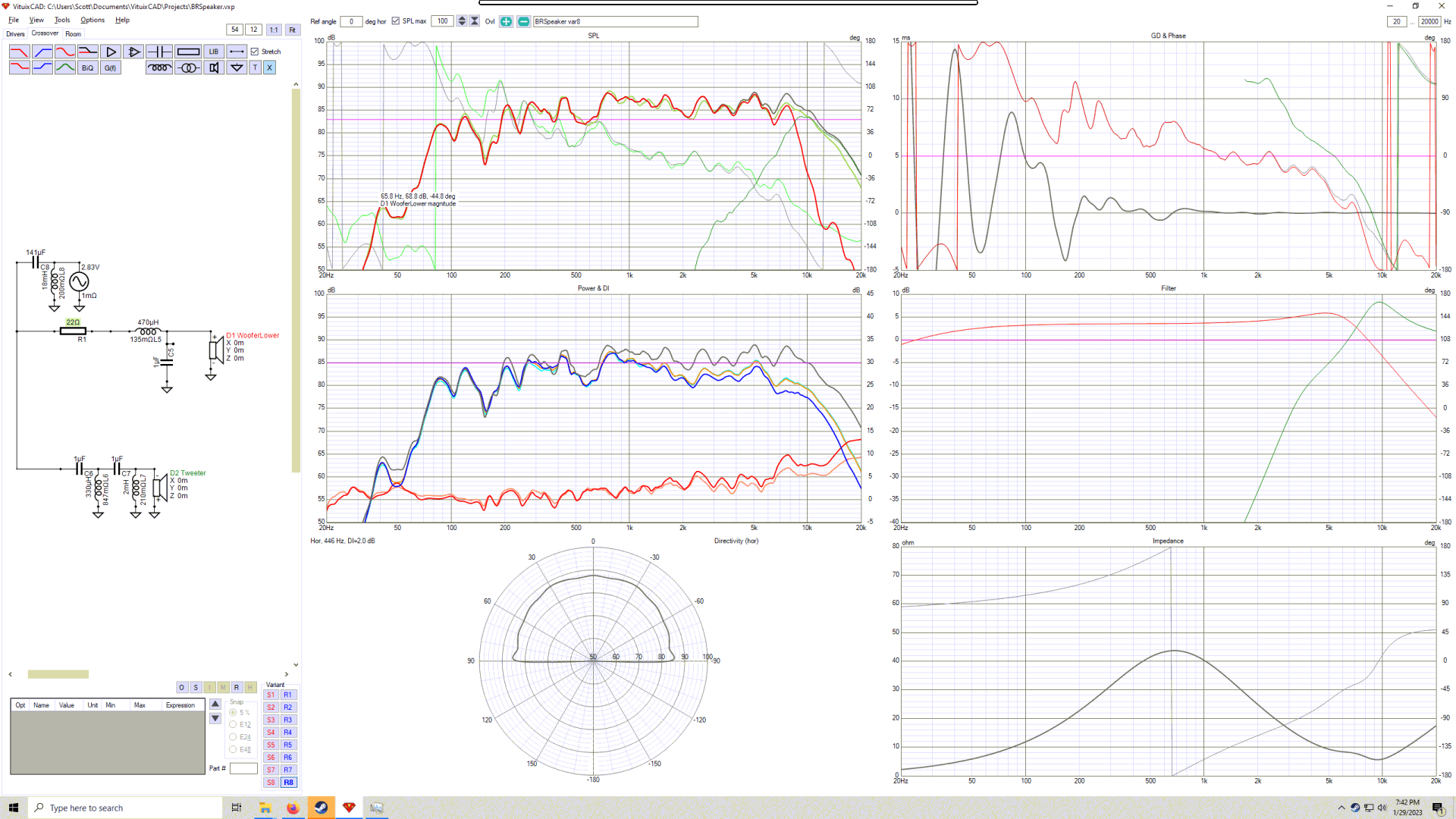

Built my first two-way recently, with an emphasis on aesthetics but with a careful eye on T/S parameters, FR response, et al. I attempted a crossover without measurement and didn't mind the results, but paled to some commercial (NHT) speakers in my living room, so decided to take the jump to measurement and CAD based crossover design. After taking 180 degree horizontal far field measurements of the woofer and tweeter and bringing them into VituixCAD, I have a response I like the look of.
Two things give me pause however, my original crossover modeled in V.C. didn't match my measured real world response, and while I used two ordinary filters: a 2 way LR low pass for the woofer and a 4 way high pass for the tweeter, the only way I could get a curve I liked was with a 22ohm series resistor ahead of the woofer crossover. While I like the response, I don't quite understand what happened with the design with the addition of that resistor, and I can't get a response I'm happy with without it.
Moreover, I worry that while the simulated FR looks good, there is some reason I shouldn't have that resistor there. Drivers are Visaton W100S-8 4" 8ohm Woofer, and Morel MDT 29 1 1/8 soft dome tweeter, also 8ohm.
Question is whether a series resistor on a woofer is odd, or otherwise what I could be doing wrong. Images below are the response curves with and without the series resistor shorted in VituixCAD.
Feel free of course to berate me for whatever other mistakes I may have made here on my first run. I'm happy with the cabinet, and just want to do my best on a passive crossover for non-perfect listening while also trying to learn as much as possible going forward.

What are L8 and C8 for? That inductor is shorting the amplifier for low frequencies.
A big series resistor only makes sense if the woofer is far more sensitive than the tweeter. In any case, it much increases the Q of the woofer, which is usually not what you want.

That's simulating the built-in 6db 100hz highpass in the 2.1 amplifier in my subwoofer. This won't actually end up in the speaker's crossover.What are L8 and C8 for? That inductor is shorting the amplifier for low frequencies.

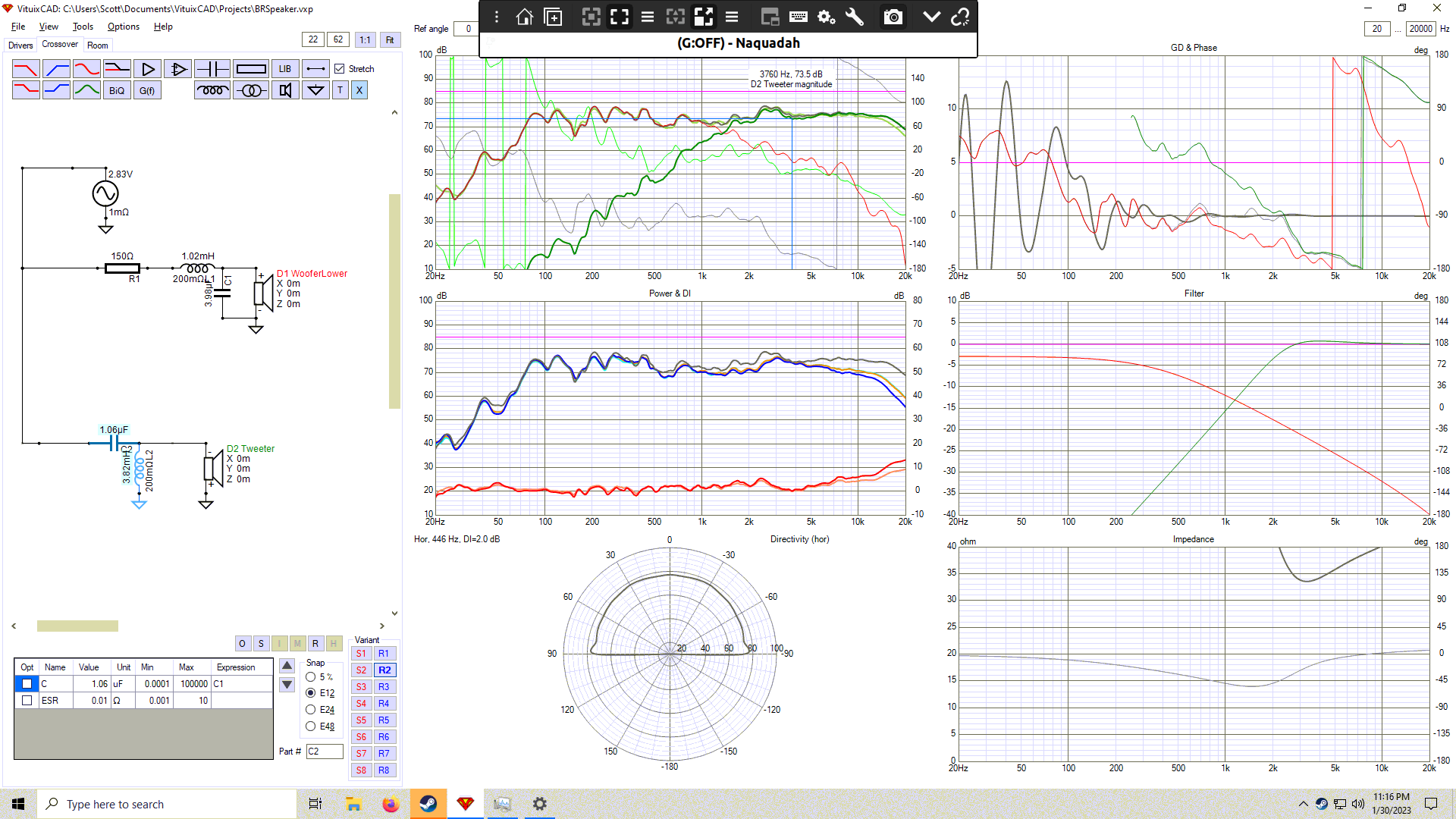

Okay, so playing some more, two 2nd order Linkwitz-Riley crossovers with a 2500hz crossover point. I added an L-pad after the woofer crossover to bring down the lower frequences to the level of the tweeter's. The tweeter's filter block was tuned with an impedance of 30ohm, which flattened an 8db peak at the crossover point. Visually looks great, but am I missing anything?
Which brings up another question. The woofer sensitivity is lower than the tweeter, I would have expected to have to attenuate the tweeter rather than the woofer. Did I measure wrong, or is there something else about modeling that I could have screwed up? In REW the response graphs have the tweeter around 77db average, with the woofer at 82db average, so if the measurements aren't wrong it does seem to check out.
A speaker that produces 82dB is MORE sensitive than a speaker that produces 77dB from the same input level, which is why you are finding that it needs attenuation.
Part of the problem here is your misuse or misunderstanding of terminology. As further examples, you said 'way' when you meant 'pole', and '6dB' when you meant '6dB/octave'.
That L pad just overloads the amplifier. A series resistor is sufficient. R2 is in parallel with the woofer impedance anyway, so any added precision is illusory.

Thanks on the L-Pad. I only asked because the spec sheet had the sensitivity of the tweeter at 89dB, vs the woofer at 86dB at same voltage and distance, and thus I expected more energy out of the tweeter than the woofer rather than the reverse.. And yes, as a newbie, right in the thread title, I'm likely to get terminology wrong. That said, I have a strong background in electronics, CAD, etc, so I'm trying to get up to speed here for a project but not a career. Bear with me.
Interesting. Can't seem to get anything like the CAD result replacing the L-Pad with a series resistor either before of after the crossover inductor and capacitor. May be my misunderstanding of VituixCAD, but not intuitive based on your advice.
If I add a 150ohm series resistor in front of the woofer crossover, but 150ohms feels like quite a lot. I get closer, but with a ~5db overall reduction in SPL. Which is fine, don't expect this to play loud. But still not as pleasing a flat curve. I probably won't notice it but it's a challenge at this point.
