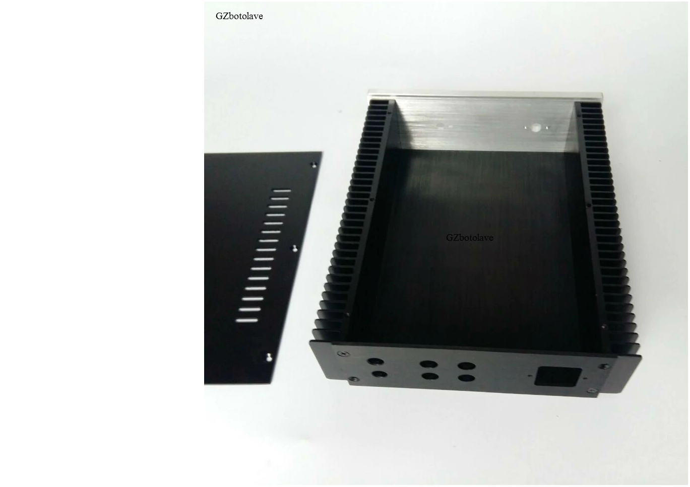

Basically putting Tom's Modulus 86 x2 (Modulus-86: DIY 65W power amplifier achieving -120dB (0.0001%) THD – Neurochrome), power 86 x1 and a toroidal transformer into an aluminum chassis with heat sinks on the side. I am still waiting for the parts so no legit picture from me yet.\
The chassis will be similar to the one I uploaded here but I am still shopping around.

I would get a couple short standoffs, which would be used between the two holes in the front of the amp board and the bottom of the chassis.
In a pinch, I've even used a few nuts instead of a short standoff.
You need to see what size screw fits through the board holes. In the US, it would likely be a #4 or #6, not sure if you guys up north use metric?
Standoffs should be positioned so that the amp ic can be bolted directly into the heatsink. I would drill the chassis holes a little large, so you have a little play to position the board.
Will make it easier to bolt it all together in the end.
You will need to drill a hole in the heatsink to use to attach the amp ic to it. If the ic has a plastic back, you don't need any insulation between it and the heatsink, otherwise you need heat conductive insulator.
I would make a tapped hole in the heatsink, so I could just screw into the hole. If you don't want to tap the hole, you can use a nut and bolt, just make sure the hole is between fins.
There are toroid mounting kits which are basically a big bolt and a big washer which will securely mount it to the chassis.

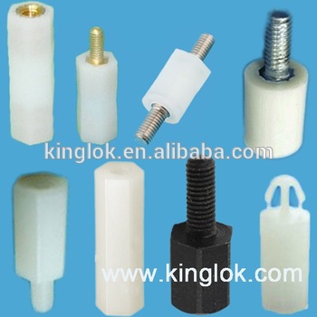

Large things (like a power transformer) of cause drilled and bolted (screwed) to the case.
For all other small things I use plastic or metal stand-off spacers (usually, like on the second line of the photo):
attachment.php
For thin metal, I'll use female-female spacer and screw (like 6th on the photo).
For thick plastic, I use male-female ones (like 5th or 7th one) and make screw-thread (usually M3, 2.4-2.5mm hole) in the case.
I don't know about that epoxy thermal glue. I know that these nylon standoff spacers, unfortunately, usually don't "take" a glue. Maybe there are exist some of them made of another type of plastic, which is glued ok. But usually they are nylon ones - they don't glued. 🙁
