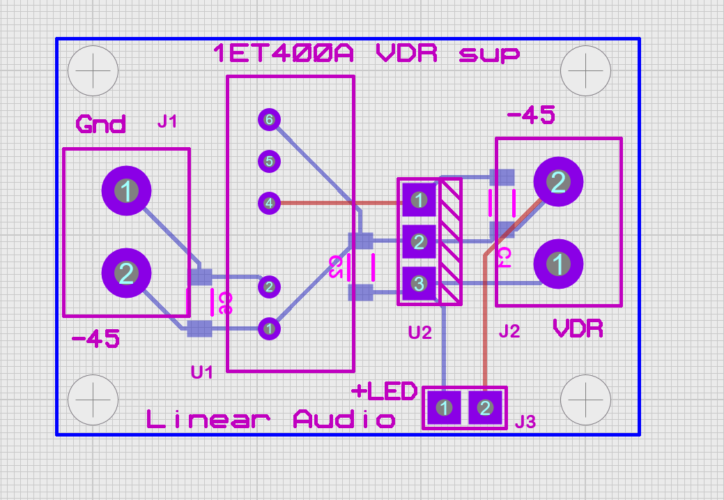

You could use a small transformer and a regulator for 15V , independend of the rest of the power supply. Not connected to ground or chassis!
If I get the data sheet right, then you connect the negative side of this aux supply to the negative feed (65V) of the main supply, it should give the desired 15V VDR reverenced to -VP. As it only has to deliver 35mA per amp, this could be a very small SMPS module, for example.
You can build your own VDR with a TL431 for example.It does not have the VDR. See post # 5.

Thanks so much!Attached. It generates 15V supply referenced to the nominal -48V.
Let me know if you want the Gerbers but it can easily be build on perf board.
