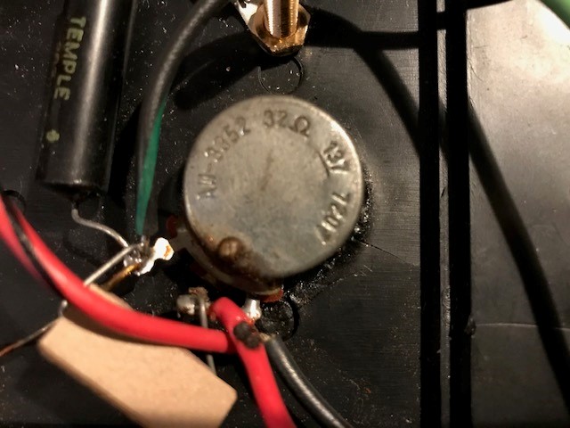

I decided to recap and install new binder posts in a pair of vintage Rectilinear speakers. I discovered one of the tweeter control potentiometers is shot (corrosion and evidence it overheated some time in the past).
I need help identifying appropriate replacements. While there is a lot of information on capacitor replacement, I am finding very little on this topic.
The current version appears to be 32 Ohm version. It's marked AM-3352 32Ω 137 7207 on the back. No indication or wattage. I assume it's an audio taper but, again, nothing obvious.
Finding no options available at 32 Ohms. Most start at 1K and progress to 5K, 10K, 100K, etc. 250K 500K seem typical for guitar tone controls. Closest I seem to be able to find new are either 25 or 100 Ohm in the 3 to 5 Watt range. I also have some old pots out of other speakers that measure at 16Ω, but no idea re watt limit.
I'm assuming I need audio taper and not linear taper, but don't seem to find any. How close do I need to be to the 32Ω of the original? How much impact will higher (100Ω) or lower (16Ω or 25Ω) values have on sound? Do I need to be concerned about Watts in this application. Are their other options/suggestions? Any recommended sources?

Does it have 3 legs? If so it's a L-Pad rather than a pot. Show us a picture or two please.
It does have 3 legs.

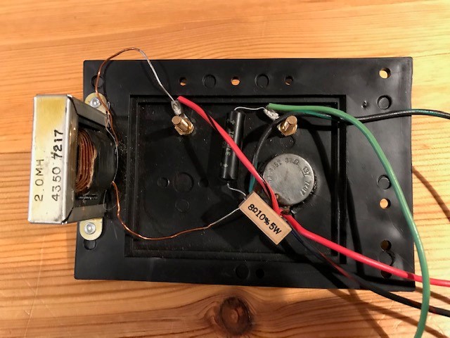

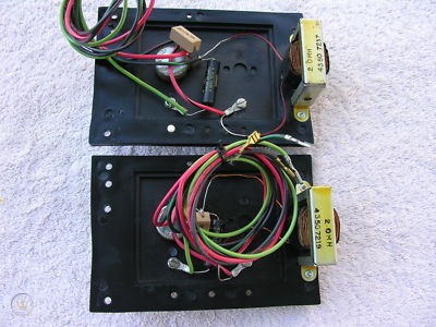

Here's a photo of the offending item, as well as the entire crossover.

4 tweeters per side? You might get a clue measuring the L-Pad at a few different points of rotation as it should tend toward the specified value, even when measured with a meter.

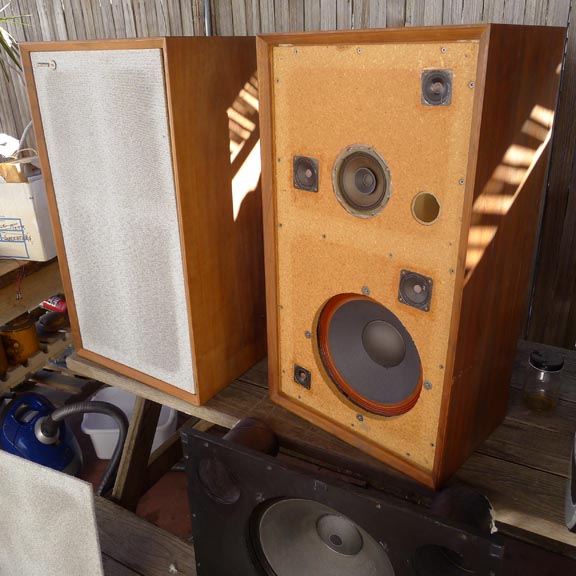

Just for clarification. The Rectilinears at issue are just the lowly XIs. Simple 2 ways, but I love them and they are far simpler for me to tackle than their top shelf offerings.
If you measure resistance all the way across a potentiometer, it won't change as you move the wiper but an L-Pad will.
Tweeter pots were commonly 50 ohm back in the old days before constant impedance L pads.How close do I need to be to the 32Ω of the original?

@Cal: I'd like to see more clearly how the 32 ohm control is wired in conjunction with that ceramic resistor.

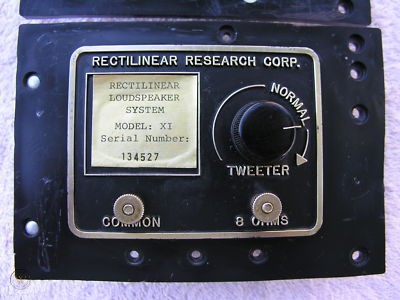

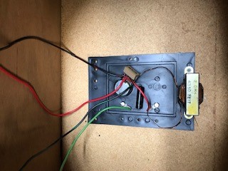

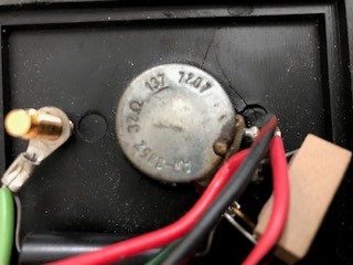

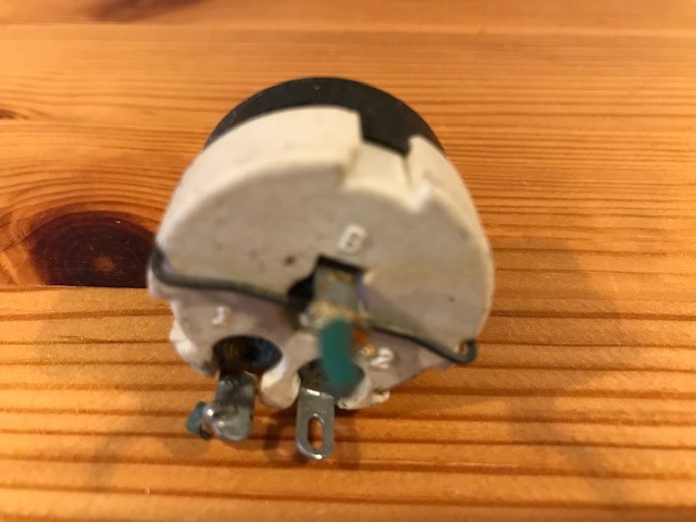

I'm attaching more photos in hopes that one of them clarifies things I am unable to express properly.
The fixed resistor in the tweeter circuit is 8 Ohm 10% 5Watt.
The capacitor is a 16mF Temple, which are reputedly quite bad.
The link to the item available in the UK is very helpful. I'm in the US and found one vendor that has something comparable, but it only handles 5 Watts. Would that lower wattage rating cause an issue?

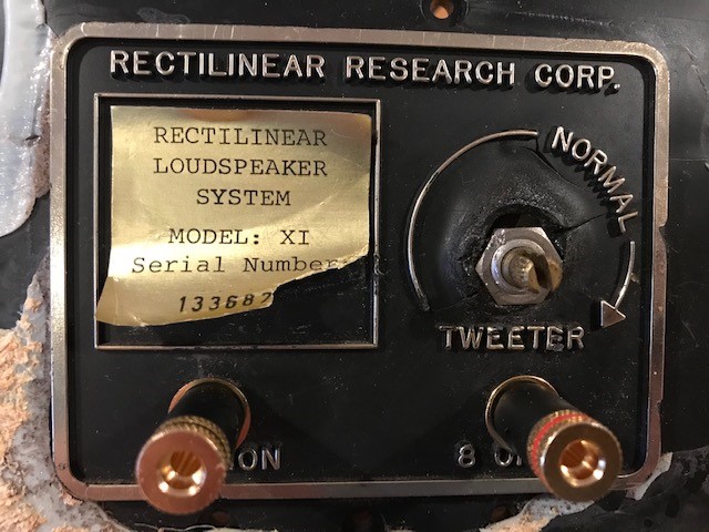

I ask because the existing pot appears to have overheated at some juncture. If you look at the picture of the label, you may see the crack and some distortion in the plastic. This is not present in the other speaker. Don't know what caused the overheating, but its certainly something I want to avoid.
Also, I have some old pots out of a pair of AR2a speakers I converted to 2ax configuration. They are 16 Ohm as opposed to 32 Ohm and have no indication of wattage rating. Would they work as a substitute?

Galu-
Those are precisely the crossovers I am working on.

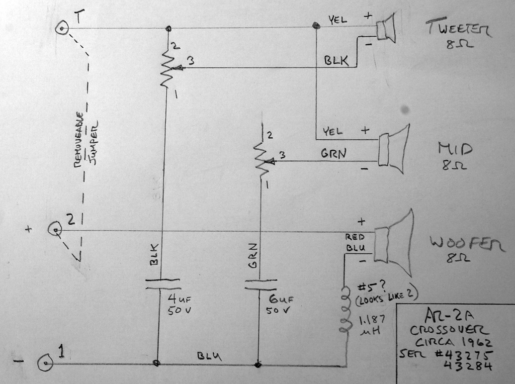

If you are not experienced in circuit tracing/modification, then the best course of action would be to replace the damaged 32 ohm control with your 16 ohm one and see how it performs. You won't damage anything with the substitution. I don't know why the fixed resistor is there and I've seen an XI crossover without it!
The 16 ohm AR-2a control is a potentiometer and not an L pad (see attached AR-2a crossover schematic).
I don't know what would have caused the original control to burn out so spectacularly, but a replacement control of 5W power rating is the minimum required to do the job.
If the 16 ohm replacement control works fine, then you may want to do the same to the other speaker cabinet to ensure balanced operation.

What I am more concerned with is the presence of the 8 ohm resistor which is placed between the top and middle terminals of the pot - so ending up in parallel with the tweeter.
I would be inclined to remove this resistor.

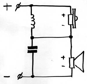

The cicuit is a series LC circuit with the basic form shown below.
The inductor (L) and capacitor (C) are connected in series across the input terminals. The woofer is connected across the capacitor and the potentiometer outer terminals are connected across the inductor. The tweeter is connected across the middle terminal of the potentiometer and the terminal connected to the LC junction.
A picture would be worth a thousand words if someone has the skill to draw it! 😉
