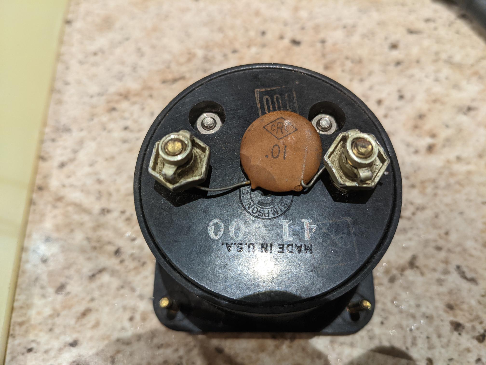

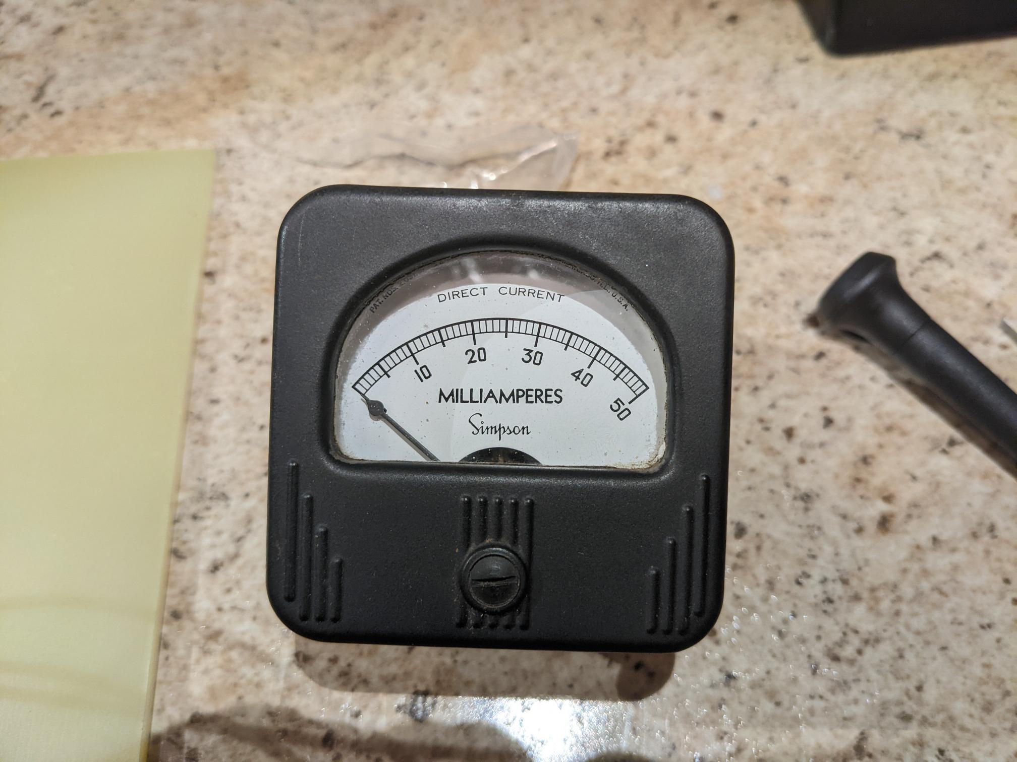

I picked up some nice analog Simpson mA panel meters from a swap meet so I can direct-wire them into breadboarding circuits without using a sense resistor and get the immediate response of an analog meter. Some of these meters had a .01 uF capacitor across the pins as seen in the photo. Now it's my understanding that the ideal voltmeter has infinite impedance and hooked up in parallel. And that the ideal ammeter has zero impedance and is hooked up in series. If an analog DC ammeter is to be hooked up in series why would someone have installed this capacitor? The meter is pretty accurate, I tested it against my Fluke, I want to use these to make things more visible while breadboarding and trying stuff out. Should I install a .01 capacitor across all of them? He sold me 1mA with centered needle. and full scale 5ma, 25ma, 50ma, 100ma and 150ma meters. See photo below. Just confused why the capacitor is installed.
Wild guess: the inductance of the coil of the meter disturbed some circuit downstream and this was a fix?
If the meter was originally used or intended for use in a radio frequency transmitter a capacitor like this would be commonly used to prevent RF pickup on the wires from affecting the reading or creating an RF voltage across the inductance of the meter coil. It should not be needed in an audio amp.
Makes sense since the swap meet was the Dayton ham fest and the seller was a ham! Thanks.
If it was part of the original meter circuit you'd expect some more parts or cut off wires on the meter.
Wild guess # 2: could it be for transport safety? Often you'd short a meter before transport to dampen wild pointer movement to avoid damaging or bending it. A short damps it, and a cap would have the same effect as it is a short for the AC resulting from the meter being thrown around.
RF across the meter would not have any effect on the slow and heavy mechanical movement.

RF across an inductor (the meter coil) may impose an RF voltage drop across the meter coil. As stated the RF will not affect the movement of the meter if that's the only components in a circuit. In a radio transmitter the meter is usually measuring current into or out of an RF amplifying device. Given the meter's apparent age, that device was likely a vacuum tube. Any element of a tube combined with any other element in an active tube is capable of rectification which will create DC or modulation frequency signals that are capable of interfering with meter readings. Many of the older (60's and before) ARRL handbooks recommended placing a cap across the meter and twisting the wires to the meter if it was on the top side of the chassis near the active tubes to reduce or eliminate this possibility. Further bypassing at the tube was also called for.RF across the meter would not have any effect on the slow and heavy mechanical movement.
Meter damping is another reason for the cap. This was common when trying to measure the average current in a transmitter that used AM modulation, but to be effective at damping a cap larger than .01 uF would be needed on a 50 milliamp meter movement.

Having the .01 uF cap across the meter will provide some damping and will likely not make a difference in an audio circuit, so it could be left in place. If there are some digital stuff like an Arduino involved the cap is a good idea if you are looking for average current measurements as a physical meter movement will not respond to the peaks anyway.
0.01uF capacitors are fairly good bypasses of high frequency RF.

That was my first thought also, but the value of capacitance is far, far, far too low to provide effective damping at the very low frequencies at which a meter movement wants to "ring".It is to provide damping to an moving coil style meter such as this.
Hal
On the other hand, the impedance of a 10nF cap at radio frequencies is quite low - Tubelab_com's explanation makes perfect sense.
