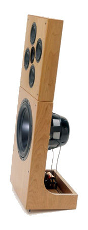

The arrangement is largely inspired by DNA Sequence speaker. From the patent:/url]
"Few conventional speaker systems approach an ideal of a high efficiency point source directional loudspeaker system. In fact, most conventional speaker systems are low in efficiency, lack phase coherency, and do not act as an apparent point source system. A speaker system in accordance with the present invention closely emulates a single point source. Embodiments of the present invention achieve this result by an advantageous arrangement of transducers. The arrangement of transducers minimizes the amplitude of the sound waves that can cause room reflections and the resultant distortion therein."

Here's an 18 Sound XT1086 driven by a Tymphany NE19
![3yEtv7H.png](https://imgur.com/3yEtv7H.png)
Here's the polar response
![1wHdYFd.jpg](https://imgur.com/1wHdYFd.jpg)
Here's Nexus One
![oBteKew.png](https://imgur.com/oBteKew.png)
Here's the Nexus One polar response
The Nexus waveguide isn't terrible, but the XT1086 is better
![y30RwNB.png](https://imgur.com/y30RwNB.png)
Here's what the XT1086 would look like with a ring of 55-1870s around it
![O1y80D4.png](https://imgur.com/O1y80D4.png)
And then we rotate the midbass array, Donald North style
![kphBWJV.png](https://imgur.com/kphBWJV.png)
![g4fE3hP.png](https://imgur.com/g4fE3hP.png)
Here's what the polar response looks like, using this spacing.
Much to my shock, I can actually move the midbasses even FURTHER out!
This is crazy, I'm surprised that such a wide spacing is working. If you look at speakers like the Snell eXpanding Array or the Horbach Keele array, the midranges and tweeter are right on top of the tweeter. Because when you make an MTM array, the midranges need to be REALLY tight.
Here's what I think is happening here. I know this is a long boring post, but this paragraph is the important part:
In an MTM array, we're going to get off-axis nulls at very specific frequencies. These off axis nulls put a hard limit on how close the mids need to be to the tweeter; it really needs to be tight.
The off-axis nulls are caused by geometry, and they're inescapable in an MTM. I describe how it works here : What Causes Off-Axis Nulls?
IE, you can tweak the delay on the mids, but all that does is MOVE the nulls, it doesn't eliminate them.
Now, remember, the nulls are geometric. They're caused by a pathlength difference between the top and the bottom woofer in an MTM.
So, I think what's happening here, is that the speakers to the left and to the right are behaving a bit like all the woofers are in a vertical line. IE, the top and the bottom woofer in this four woofer array, they're nearly eight inches apart. And if this was an MTM, that would be a problem. But the woofer on the left is only *six* inches from the top woofer, and because it's closer vertically, that's largely filling in the dip that's caused by the pathlength difference between the top and the bottom woofer.
This "filling in" effect seems to allow for a driver-to-driver spacing that's nearly double that you could achieve in an MTM. The fact that the DNA array has twice the power handling, higher efficiency and symmetry is just icing on the cake! (Why aren't more people making these DNA arrays?!)
![Xq5RpSv.png](https://imgur.com/Xq5RpSv.png)
Just to make sure that I'm not taking crazy pills, I modeled the exact same spacing as a conventional MTM. And we can see that it's upper limit is about 1khz, as expected.
![seqpic1.jpg](/community/proxy.php?image=http%3A%2F%2Fwww.dnaudio.com%2Fseqpic1.jpg&hash=1295cd7527af2d8c41128a12e9a93239)
Because we know that the DNA speaker is using an Aurasound 18, we know exactly how big the array is: 18.75" x 18.75".
So it looks like I can make my array much, MUCH bigger! I could probably even push it to 24" in diameter. (Because my horn allows for a lower xover point.)
(Donald North also holds the patent on Aurasound's "Whisper" driver, here)

My family is watching Christmas movies, I'm here on the couch doing Vituixcad sims
NRPE hasn't been developed in well over a decade, so before I go and make sawdust, I thought I'd get a second opinion from another piece of software.
Vituixcad seemed like the best candidate.
Here's the predicted response from NRPE, a piece of abandonware from over sixteen years ago. Thanks to Ron Ennenga, John Kreskovsky, Kristian Ougaard and Paul Verdone.
Here's the predicted response from VituixCad
The Vituixcad sim looks way crazier. But it goes out to 90 degrees off axis, whereas the NRPE sim only goes out to 45 degrees off axis. And if I'm not mistaken, Vituixcad isn't accounting for the directivity of the speaker, while NRPE is. (Vituixcad CAD account for the directiivty of the speaker, but I'd have to go out in the December rain and measure it, and it's Christmas Eve and I'm not going to do that. NRPE allows you to just set a diameter and it can treat the speaker as an ideal radiator of that diameter.)
Here's the arrangement of the drivers
