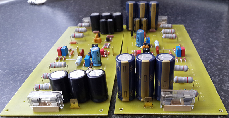

If size matters this is the size difference in Nichicon KW vs Panasonic FC.
They are 3x 470uF 100V per rail.
Regards
Which one do you prefer for power supply?
