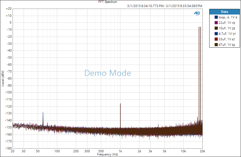

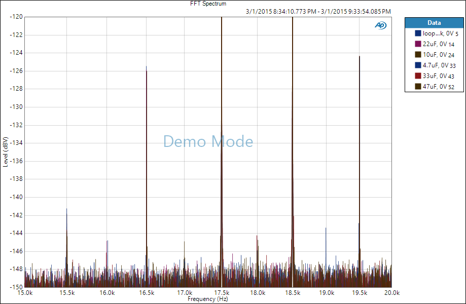

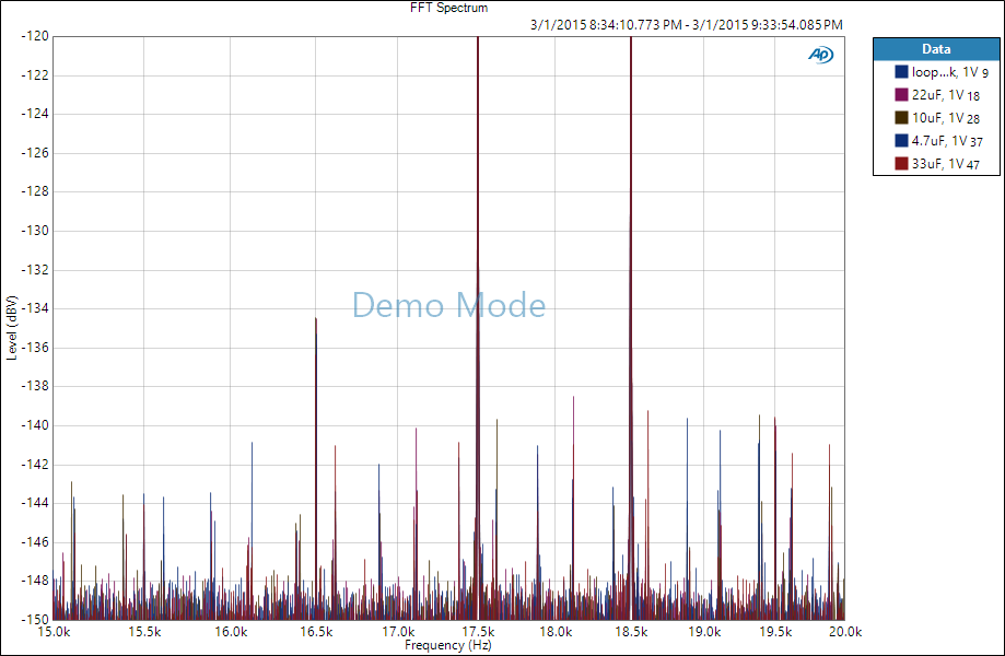

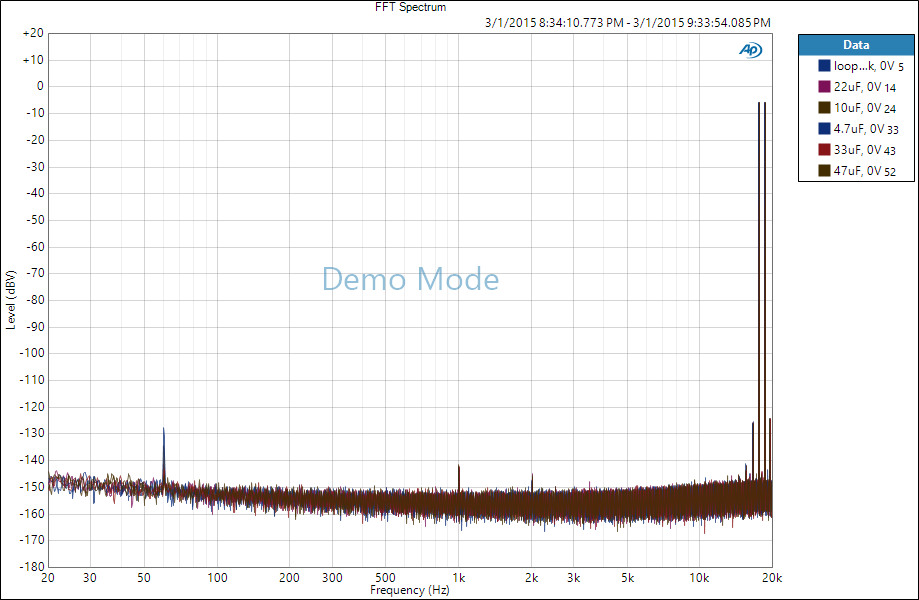

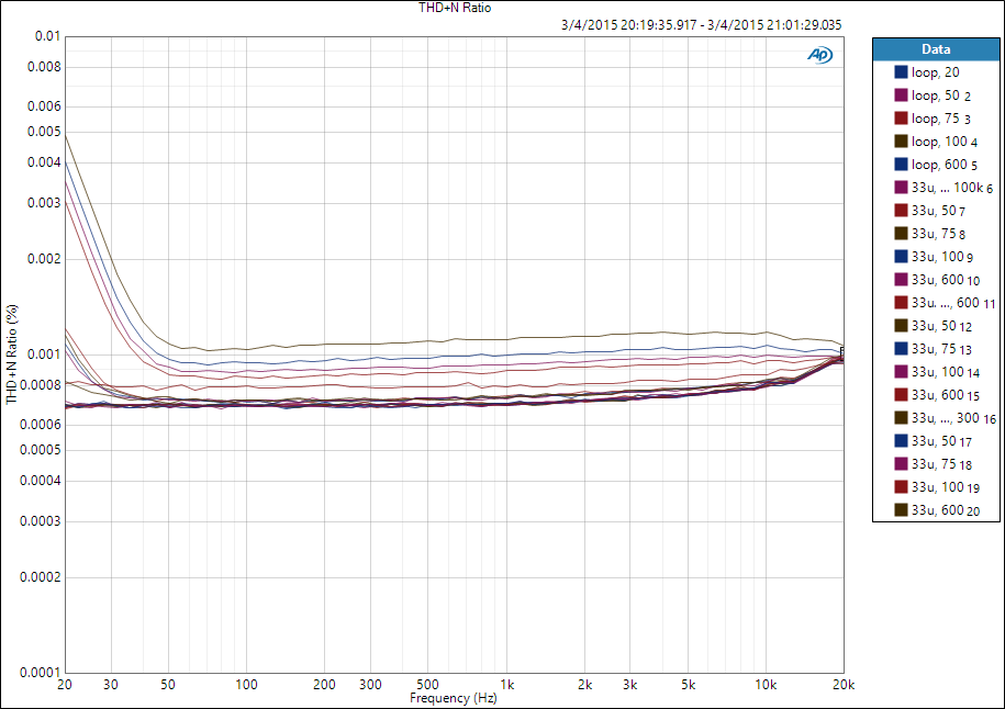

It happens I'm in Seattle on a business trip this week. So I made arrangements to visit Neurochrome Audio to get the caps assessed on Neurochrome's APx525 as part of the test services Tom offers. If you're not familiar with the APx525 it's a USD 12k or so audio analyzer which is (currently) the second best bit of audio measurement kit available---its performance is exceeded only by the APx555, which runs around USD 40k. (My current car is the best I've ever owned and I bought it new for USD 13.1k.

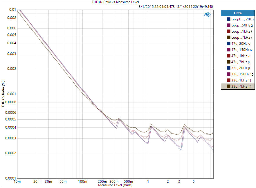

Nichicon's ES series is quite linear when there's less than about 400mV RMS developed across the capacitors. The graphs below show representative THD+N and IMD; at no point were we able to obtain results where the caps rose above the APx525's measurement limits. Below 500mV or so RMS THD+N is limited by the AP's approximately 1uV of audio band noise (20Hz-20kHz) and by the best linearity available within its range switching at larger swings---all traces including loopback on the AP group on top of each other, from 20Hz at the bottom to 7kHz at the top (loopback gets shortened to loop or loopb in the trace labels). IMD is also limited by the AP's function generator with the location of the spur frequencies shifting depending on the DC offset applied. 0 and 1V offset are shown; there's no discernable difference among the various traces as they're all identical within the limits of measurement repeatability. This held to the largest offsets tested, ±10V. Parts measured are the 6.3mm ES lineup; 4.7uF 50V, 10uF 35V, 22uF 25V, 33uF 16V, and 47uF 10V. Elna bipolars weren't measured as none of the distributors I use stocks them.
The thread title is conservative for the passband of DC blocking applications. Since the measurements don't budge when the cap under test is inserted one can infer the cap's nonlinearity is neither increasing or cancelling the AP's nonlinearities. In these charts the limit of measurement repeatability is a bit under 0.1dB on the -124dB spurs shown, corresponding to the -145dB or so noise floor (the test signal is 0dBV RMS so IMD can be read directly off the graphs). Therefore, the IMD of the caps is -145dB or better. Worst case THD is likely rather better than -130dB.

Hi Guys,
Very interesting test, and something I've been looking at quite a bit lately.
I performed similar tests several years ago on an APx585 when I measured some Nichicon Polymer parts (330uF, 16V Polymer) and some back to back 100uF UCC electrolytics. My results were the same as yours... no discernible difference between having a cap present or not present in the measurement loop. I was doing it more as a sanity check at the time, so I didn't save or publish the results.
As I got reading about it again recently, I was pretty surprised to read the articles from Cyril Bateman showing generally terrible performance from everything except film caps.
I think, however, that the big differences here aren't a result of a particular brand, type, or configuration of cap(s), but more the measurement setup.

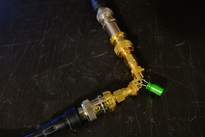

Can you guys clarify how exactly you measured in your setup? What was the source impedance? Did you use a load after the cap, or was it just the input impedance of the AP? I would assume you were measuring the cap in series configuration, not shunt?
I had the cap connected in series (as it would be in a coupling application) and used a 600R load after the cap (external to the AP) to simulate a worst case scenario amplifier input impedance. I didn't use anything to change the source impedance, so the probe came straight from the AP and into the cap.
I think the issue with Bateman's measurements is that they are effectively done in "shunt" configuration where he develops several volts AC across the cap under test. This to me is a better representation of a shunt application (supply bypassing) than a series application (AC coupling) where you aren't going to see any appreciable voltage drop across the cap if it's sized correctly. The strange part is that in shunt applications distortion is usually meaningless, and things like ESR and ESL are really what matter. The only time I see distortion being an issue is in coupling applications where the cap is generally (hopefully) subjected to a DC bias, and there is little or no AC drop across the cap itself.
Can you guys verify your test setup so I can confirm some of my suspicions?
I will be sure to repeat this test next time I have an AP in house.

Yes, measurements are in series as DC blocking's the application (I've a jig photo to add to post 1 but haven't had a minute to download it from the camera yet). The figures are with a 20 ohm output impedance on the APx525. AP input has a 100k pulldown---very much what you'd find in a standard audio AC blocking configuration---and, other than the expected subsonic rolloff, we didn't find any difference between AC and DC coupling on the input. (Post 1 data is with AC coupling as that was running a bit quicker on some of the loopback THD+N sweeps and the AP was just left in that configuration.) Typical sanity checks were done, such as measuring a short on the cap jig versus the AP's loopback and verifying frequency response against DC coupling and higher output impedances.
20 ohm series impedance is a bit on the low side for RISO management of capacitive loads but should be pretty representative of the 25 ohms used in line drivers such as the THAT 1606 and 1646. I doubt things look much different with the common 47 ohm choice. There may be differences with some of the line driver arrangements with output impedances of several k.
Agree Cyril may be measuring different things. While the composite amp driving the cap in his jig should be quite solid it may not be representative of a more typical DC blocking arrangement. I can't obviously put a hole in it but neither can I get away from the sense the cap may behave differently depending on the effective pulldown impedance---10k versus 100k may well not matter but I could see Cyril's arrangement of essentially zero making a difference compared to 10k. More measurements would be required but Tom and I spent a lot of time getting to where we were convinced we weren't missing anything and the caps really were transparent to the AP.

to see cap distortion you really need (AC) Vdrop across them - working on/near the slope of either hi or low pass
I've seen distortion in Nichicon Gold audio coupling caps in a multichannel SACD player that was worse than the "lesser" grade caps used in the surround channels
measured with a Lynx Audio card - but only visible for signal frequency near or below the 3 dB low frequency corner

That's where twest and I landed last night. He took more measurements at various load and source impedances with the cap in series with the signal path. A preliminary look at the data did indeed show a THD rise as an AC voltage developed across the coupling capacitor. Some of the THD rise is due to the roll-off of the fundamental, but even when accounting for that, there was still a quantifiable difference between the series cap and a loopback measurement. I'm sure twest will post the data when he's had time to process it.
For fun, I compared the 33 uF Nichicon ES to a Solen 47 uF, 630 V polypropylene capacitor. They were line-on-line until the 33 uF hit the high-pass rolloff.
The executive summary is: If you want low THD, avoid excessive voltage across the coupling caps. This is pretty easy to do by using a relatively high input impedance, such as the 10-100 kohm commonly found in audio gear.

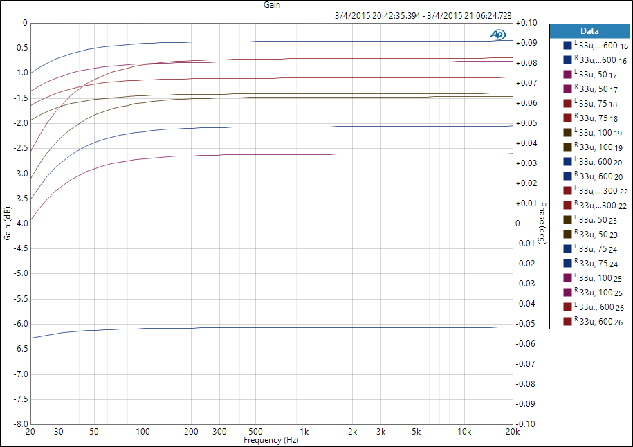

Some transition band data attached which I've been meaning to post for a while. Also, pic of the measurement jig.
These aren't source and pulldown resistor combinations one would use since the corner frequencies are in the audio band and a fair amount of voltage is developed across the DC blocking caps. But the data is still kind of interesting. Note highpass filters accentuate THD+N slopes in their transition and stop bands. If the fundamental is attenuated but the harmonics are not then the THD increases as (fundamental attenuation) * (number of significant harmonics) from filter rolling off the fundamental even though there's no actual increase in the size of the distortion products. In the stop band THD goes as sum_over_harmonics(harmonic + 6dB * log2(harmonic order)) for a first order filter. E.g., 9dB boost if the third harmonic is dominant.
It's also straightforward to throw together a spreadsheet for the pull down resistor size required to keep the voltage across the DC block caps below some value at some frequency limit. Example attached. The common choice of a 100k pulldown isn't a bad one for electrolytics, though some attention to the input impedances of the op amp or diff pair beyond is warranted.
