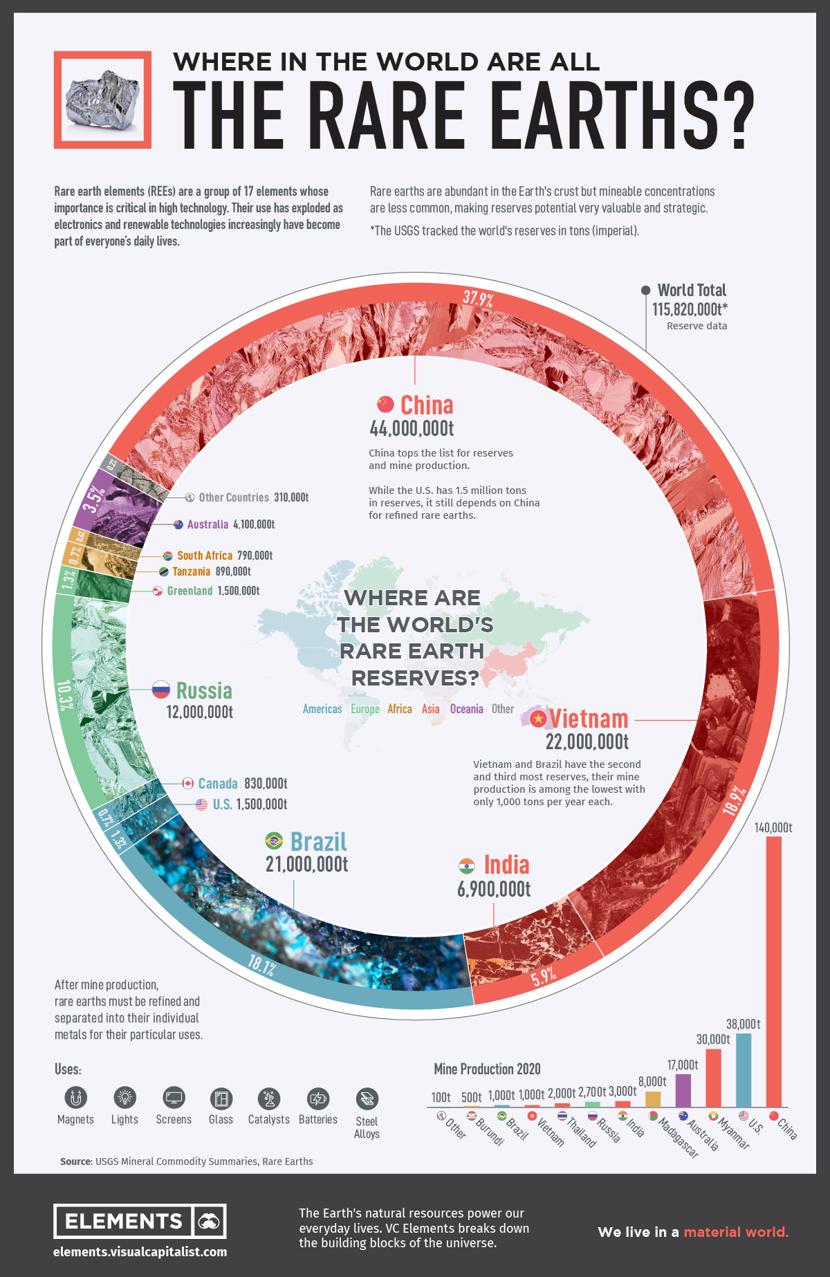

Quite a few countries have sizeable rare earth reserves, but China still does about 85% of the refining. Tighter environmental regulations and higher labor costs make it difficult for many other countries to compete at refining (from a strictly commercial standpoint).China seems to be the largest producer / exporter
https://www.visualcapitalist.com/rare-earth-elements-where-in-the-world-are-they/
"In the rare earth industry, China’s dominance has been no accident. Years of research and industrial policy helped the nation develop a superior position in the market, and now the country has the ability to control production and the global availability of these valuable metals.
This tight control of the supply of these important metals has the world searching for their own supplies. With the start of mining operations in other countries, China’s share of global production has fallen from 92% in 2010 to 58%< in 2020. However, China has a strong foothold in the supply chain and produced 85% of the world’s refined rare earths in 2020."
