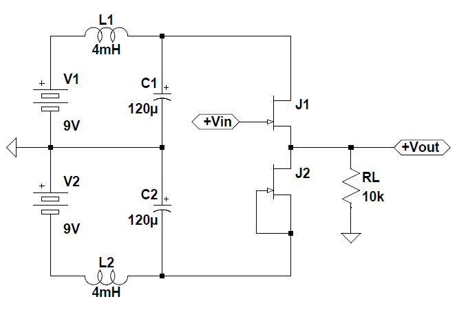

A small test setup was prepared to test various (Toshiba low noise) N-JFETs in a source follower buffer circuit.
The circuit consisted of 2x 9V alkaline batteries as power supply.
This was further filtered by 4mH Fastron inductors, followered by Panasonic FC 120μF capacitors.
Each of the N-JFET pairs used in the testing was matched to <10μA in Idss.
The output was loaded by a 10k ohm Vishay S102 bulk foil resistor.

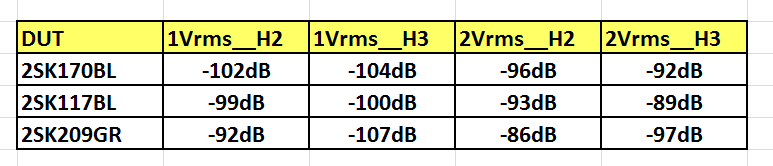

The JFETs tested were
a. 2SK170BL at 8.2mA Idss
b. 2SK117BL at 7.5mA Idss
c. 2SK209GR at 3.8mA Idss

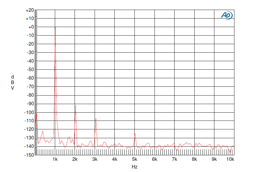

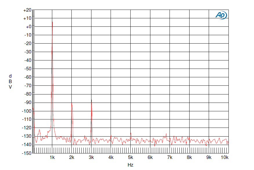

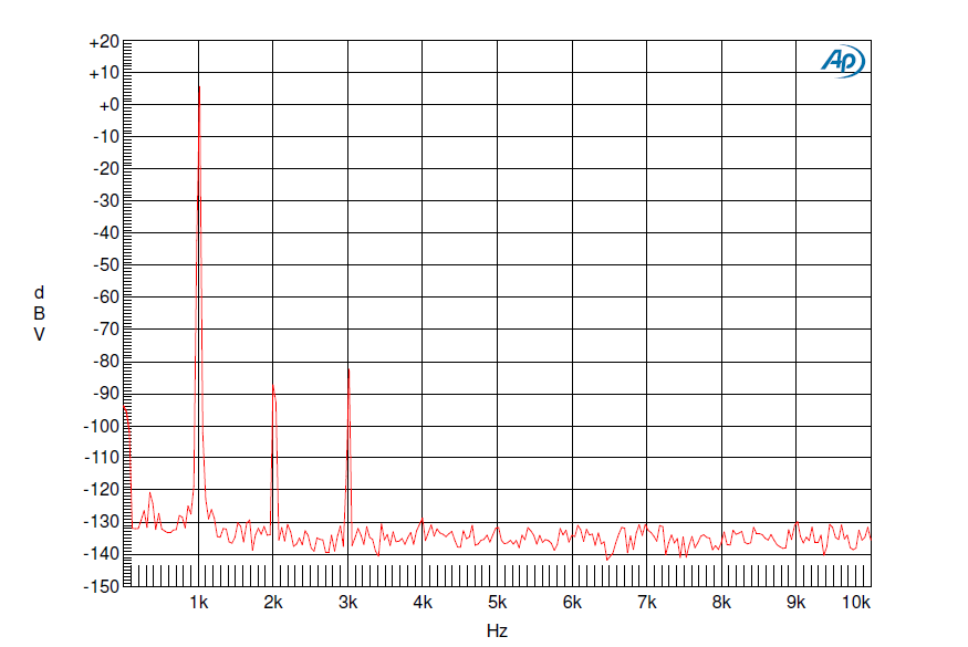

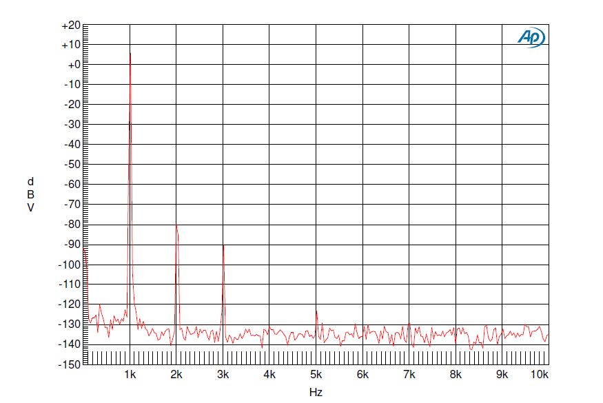

Single-ended input signal was 1Vrms and 2Vrms at 1kHz from the AP built-in waveform generator.
The results can be summarised.
DUT 1Vrms __H2 __H3__ 2Vrms H2 __H3
2SK170BL -102dB -104dB -96dB -92dB
2SK117BL -99dB -100dB -93dB -89dB
2SK209GR -92dB -107dB -86dB -97dB
As can be seen, there is very little performance difference between 2SK170 and 2SK117 (= 2SK209 in SMD) at the same Idss; on average about 3dB.
Halving the Idss push up the second harmonics by so 6dB, in return for 7dB lower third harmonics. The latter result (with the low H3) was rather unexpected and interesting.

Do you have an explanation for the increase in H2 but significant decrease in H3 for the GR grade ?
Patrick
Looking into it.
Note that 2SK2145 is NOT specified as a matched pair as e.g. 2SK389.
There is no specification on the datasheet as to how well the match is.
In my experience can be as bad as > 5% in Idss.
You can read Samual Groner's article on his Low Noise Amplifier regarding the effects of mismatch in paralleling devices.
In that amplifier, he was using 8x BF862's, but from a noise instead of distortion perspective.
Patrick
Patrick
Looking into it.
Nothing conclusive, seems that secondary effects come into play at these levels. -90 or so dB is pretty good.
