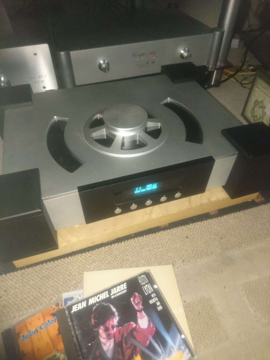

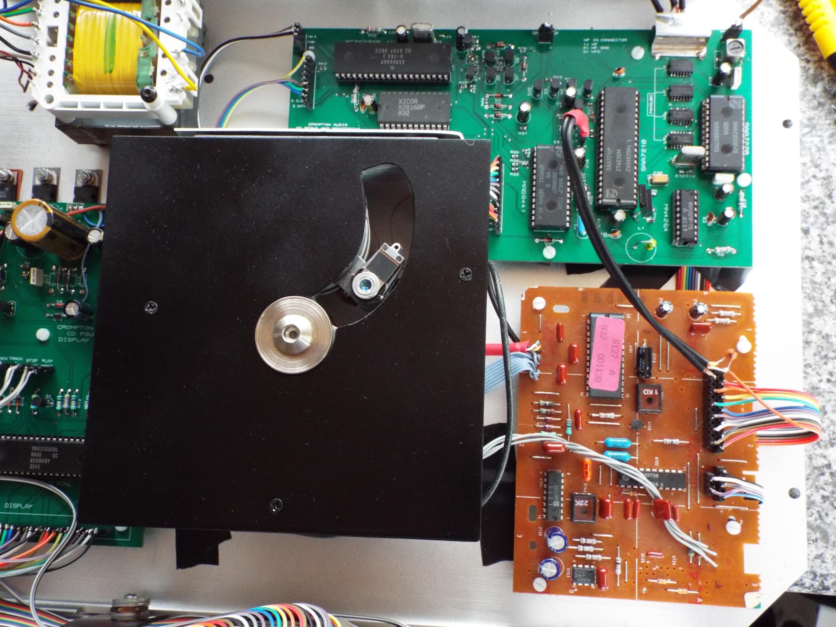

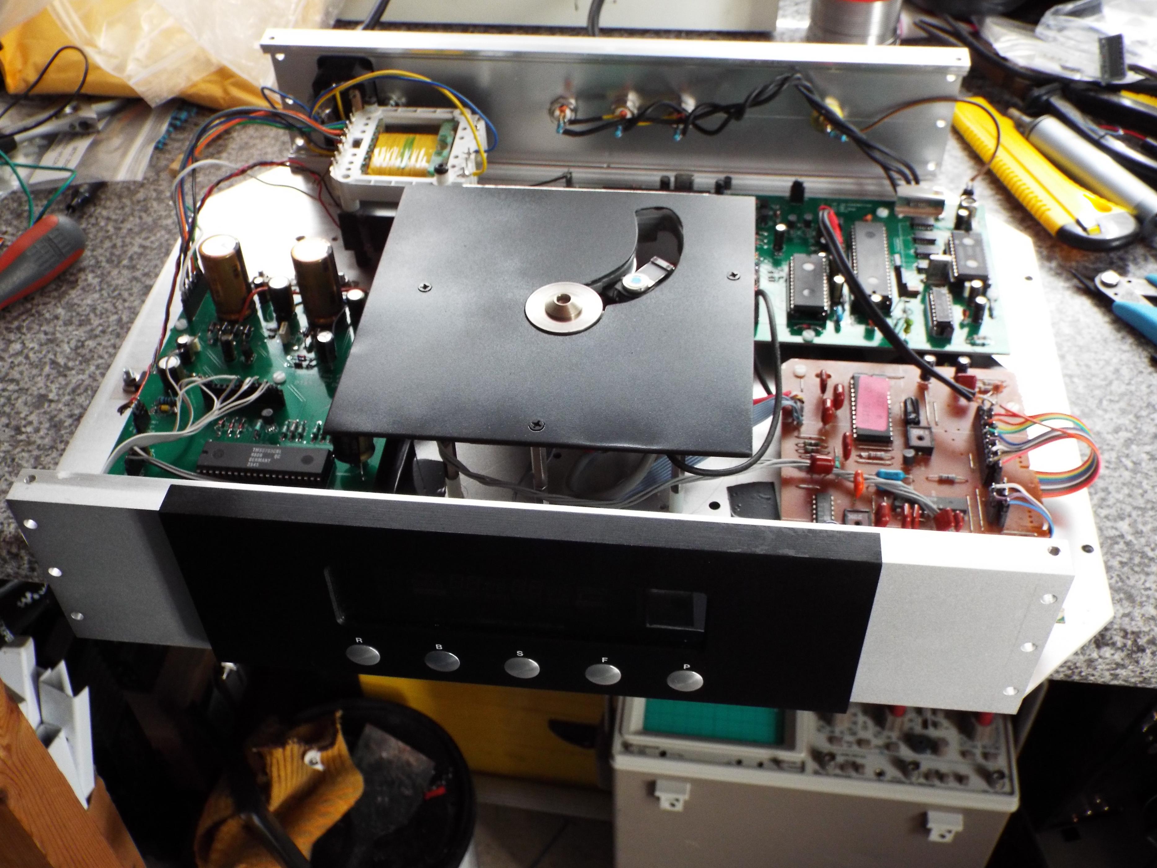

With what I said about old technology I decided I'd use a Philips CDM-1 as my starting block for my project which then used the electronics from a later Philips unit to give the control and processing.
I've ended up with a Transport with SPDIF and i2S out which works quite well.
It has a few little quirks not wanting to play some discs (which I can visually see no faults with) but on the whole it plays well and sounds great.
It's not 100% perfect and requires a donor machine so I wouldn't feel happy offering this as a project for others.
But here's what I came up with.
Case from eBay.

The thing with my 'design' though, is it's not MY design. It's a Philips design and all I did was to design PCB's for the schematic which fitted into the case I had chosen.
I wanted to use the CDM-1 because they're such a good well-built Laser mech and seem to go on forever, I've yet to see a worn out one, in 31 years of Hi-Fi servicing, the only faulty ones I've seen have been caused by a bad enginner or an end user 'having a go'.
I tested the concept that it could work with a CDM-2 RF Amp PCB, it did, so I then set about drawing the PCB's out to fit in the casework.
