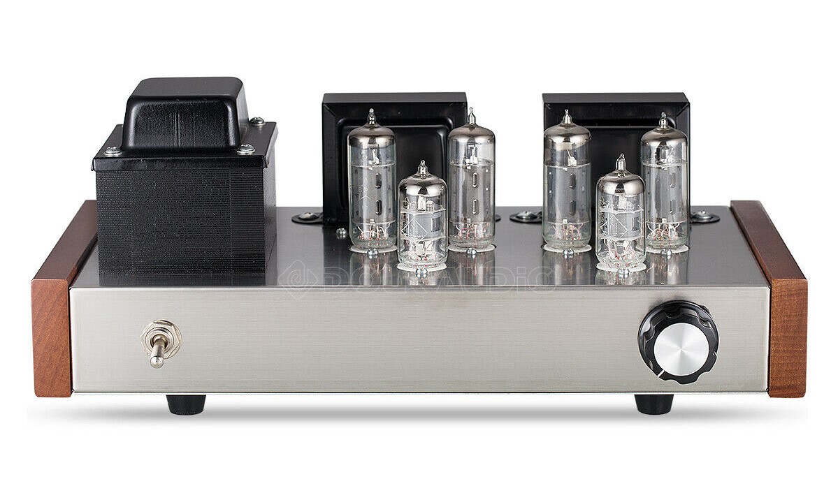

I am thinking of buying the Nobsound 6p6p+6j8p so I can have some fum tube rolling and making some upgrades.
I can get it on Europe for 220€ delivered I think is less than the price of the components.
Anyone as experience with this model?

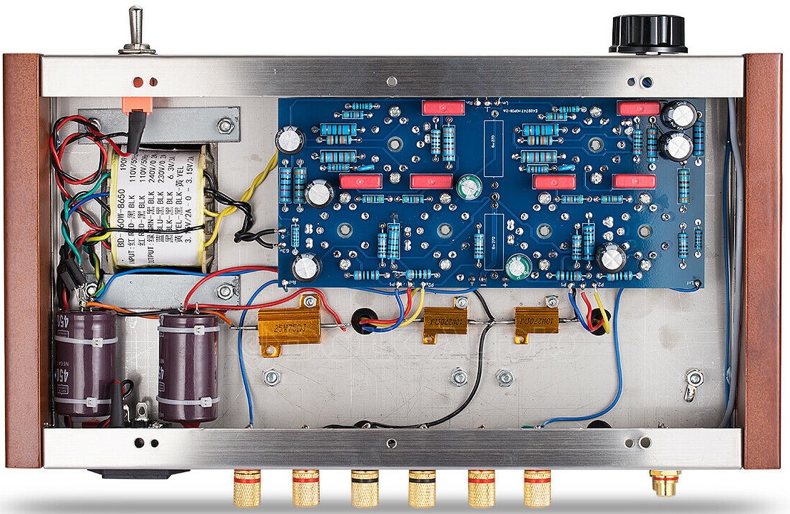

I have direct experience on other low-end tube amplifiers from this seller. This kind of low-end amplifiers seems a bargain at first, but they are not. I would avoid the NS-03D kit because the chassis is poorly made: the filter choke is directly beneath the left output transformer, and the sides are made of wood. There will be background hum and noise. The NS-02D amplifier (5Z3P+6H9C+EL34B) is basically the same circuit but with better transformers and a bigger chassis. Output power is almost exactly half as advertised. Power transformer is never CE/UL compliant. Compare prices carefully because it is sold by several sellers, but even with discounts, there is still a premium over a DIY build with slightly better transformers. I bought my NS-02D as "damaged" customer return from Amazon, and I paid 40% of the original retail price, so a lot less than the price of the amplifier referenced on post #1. It does come with EL34 tubes but it does have a tiny power transformer, smaller than the one fitted in vintage stereo Saba radios from the '60 with noval tubes. It performs poorly on stock configuration and I had to do several circuit modifications and use smaller output tubes. That would have been a very poor purchase choice at the original retail price.

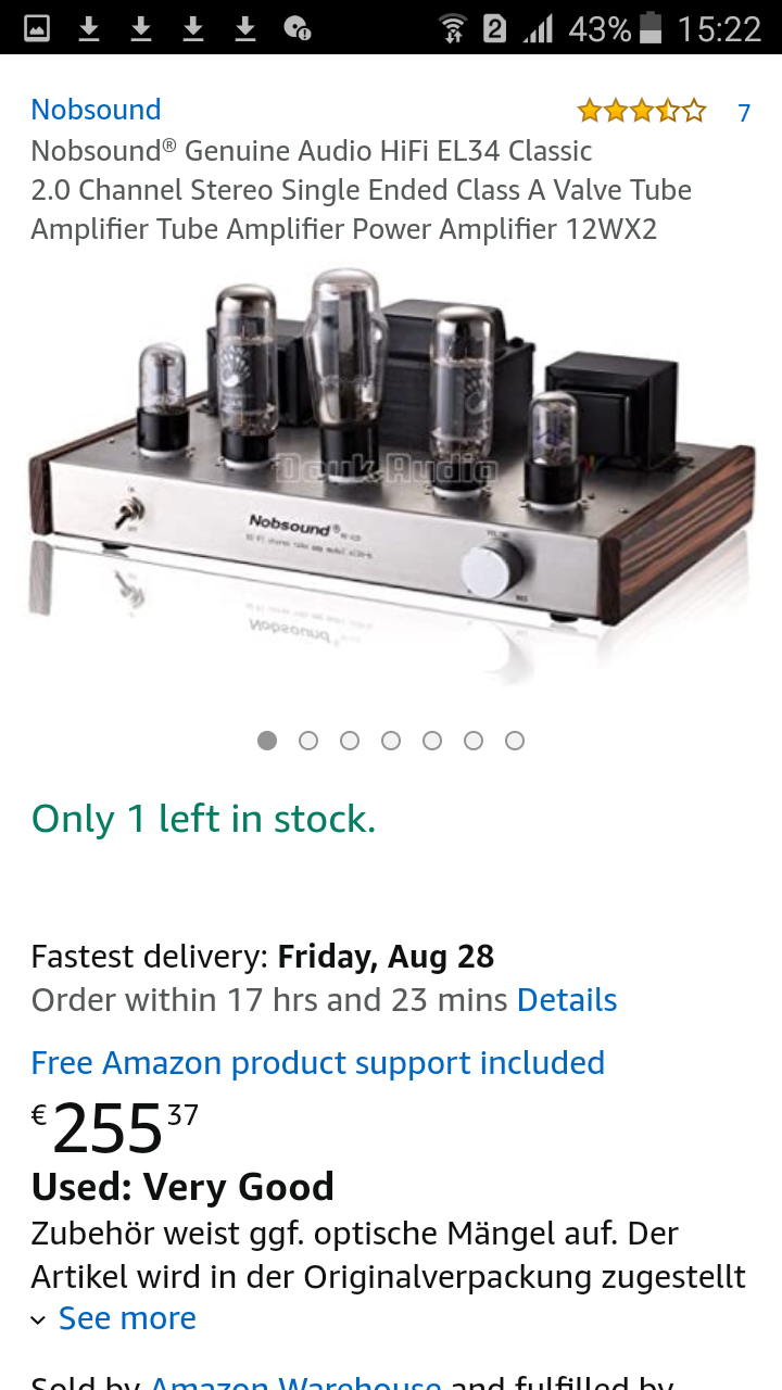

Could you be so kind to share the modifications, I am already targeting a "Amazon Used".

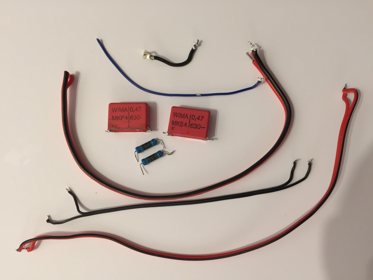

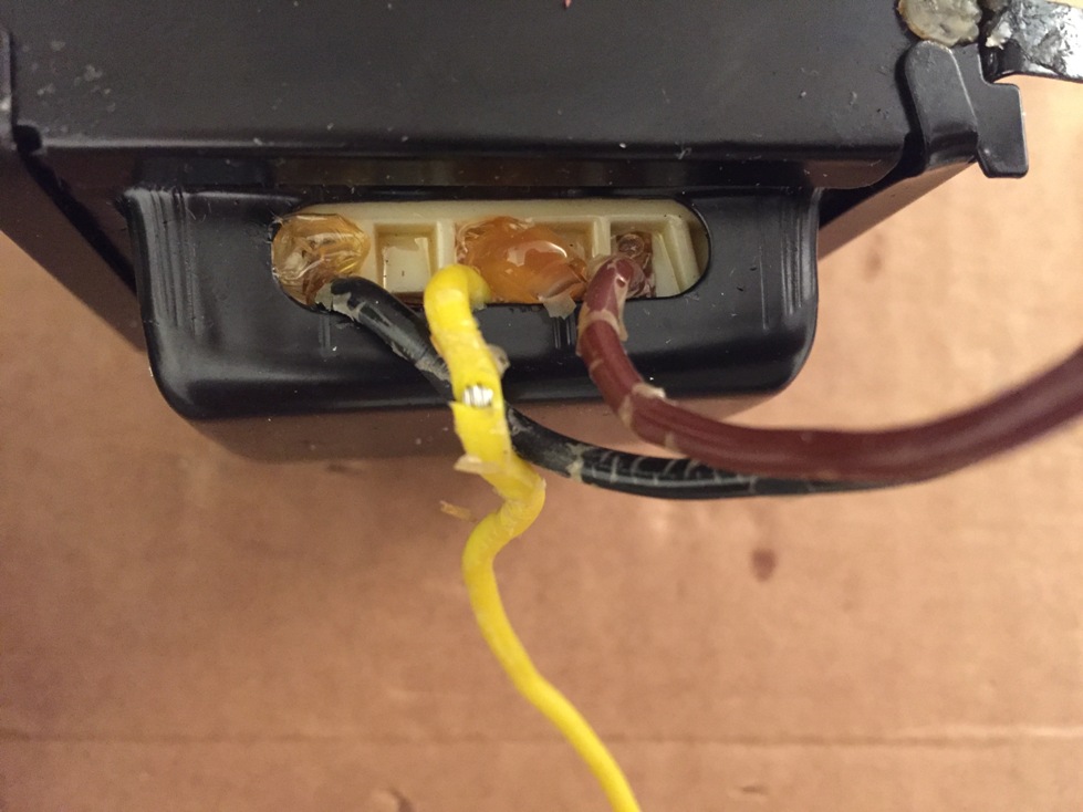

I paid less than 200 euro, but on my specimen the base of one EL34 had a broken spigot due to rough handling by the previous owner. The EL34 tubes are not matched, but they are both working fine. On the picture you see the parts that I had to exchange immediately. Leaky, recovered Wima coupling capacitors and the toasted EL34 cathode resistors. The black/red low voltage speaker wire was connected to the 230V mains power switch. The short black wire was soldered to safety ground mains power connector. I think you may already get a picture of the quality level of this build. See the output transformer wiring for more hints - no grommets were fitted of course. The long, untwisted black wire was for the heaters. It was neatly tucked underneath the terminal strip board and was a contributing cause of hum, togheter with a ground loop that I removed by rerouting and shorting the blue wire (signal ground). The manufacturer tried to solve the obvious issue by increasing to 220 uF the first filter capacitor: it was directly connected to the rectifier tube, before the 4H choke. I was amazed to see no arcing inside the rectifier. The B+ value with the factory 5Z3P rectifier tube was 310V; it is 340V now with a GZ34 tube and a 33uF capacitor. I then made further modifications, but the amplifier was at least working at this stage.
I am perplexed with the build quality, are you sure you didn’t buy a DIY kit that was assembled by the previous owner?

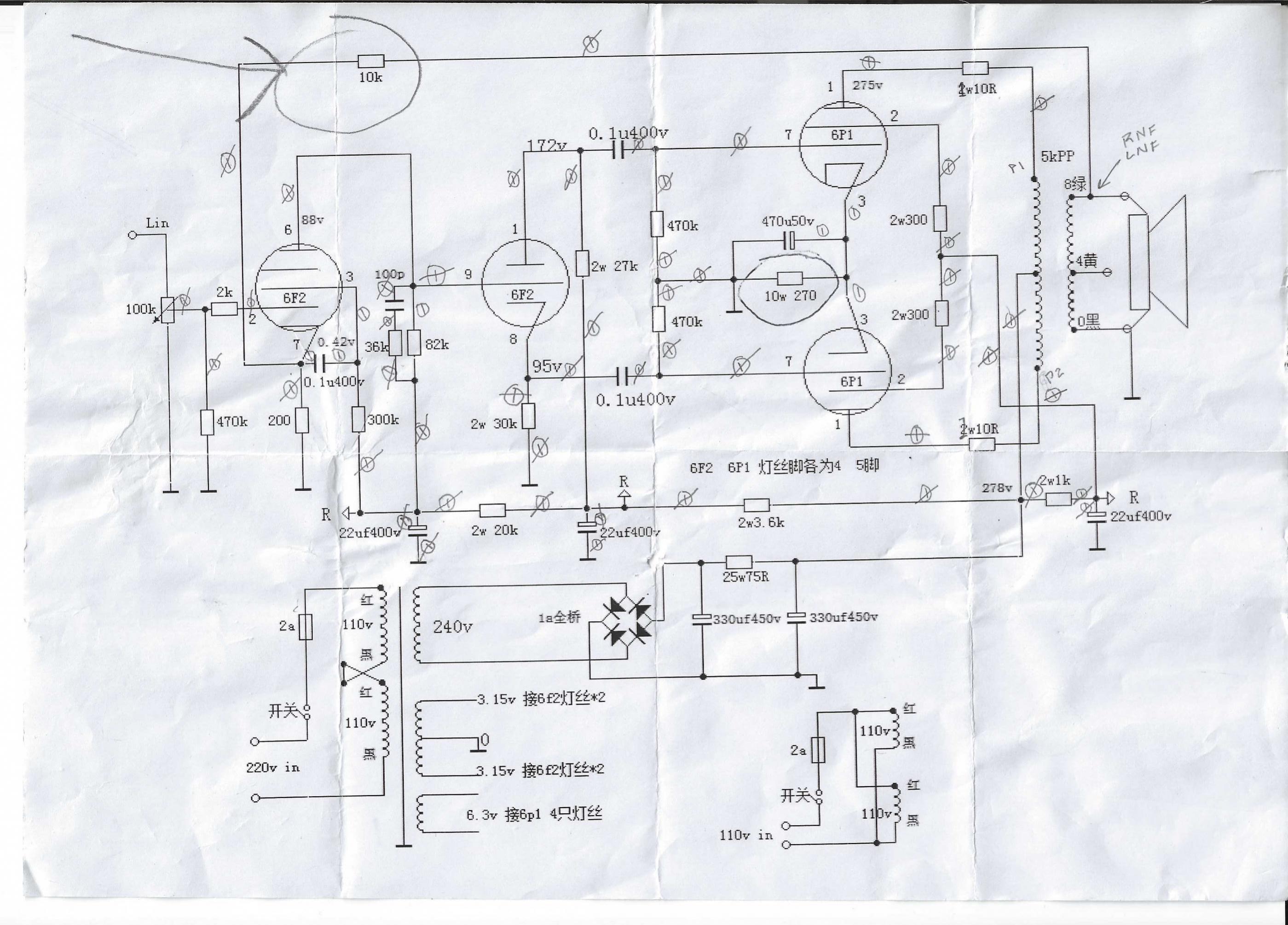

I purchased Nobosound 6P1 / 6F2 P-P 12W amp as DIY kit last April.
Initial sound impression was very flat through Brit Cambridge Audio Minx XL's, which are good bookshelfs- IMO. Added silicon preamp / tone control on front end, which helped. 'Rolled tubes' of moderate cost using US and Russian versions of original. Found original ChiFi tubes were best w/ for low noise, but 6U8's better for sound quality. Supplied parts did include WIMA coupling caps as posted earlier, 5k output transformers.
Not unhappy w/ this product- bought it for ongoing design change platform. My advice if you buy ChiFi- get DIY kit to control proper assembly, based on what was posted earlier... otherwise, go over work w/ fine tooth comb.

The amplifier was inside the factory package and all the solder joints were covered with a spot of white silicone to discourage tampering, so it was a factory build I presume. I cannot be sure because it was a open box item. I tried 6F6 tubes (VT175 actually); to use this tube the cathode resistor value must increase, and input stage should also be modified to get more gain.
And how were the words "Nippon Chemi-con" spelled on the power supply caps that came with it?Not the same amp-
Not sure markings on those caps; Amp is disassembled at my shop- will check
Letters on 330uF / 450V power supply caps reads: NAPFCM CEBNVCON. I can see 'Nippon Chemicon' in those words if I squint- lol

Yeah, so those are counterfeit trash caps. They can't even spell the the words properly when they make their copies, would you trust them to be able to properly make an electrolytic cap?
