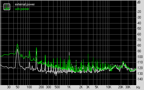

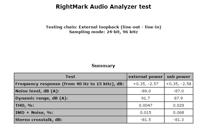

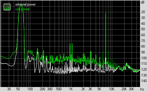

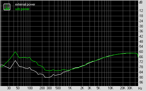

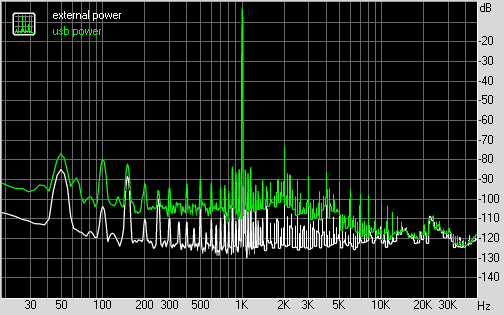

here is some fresh measurments:
output schiit modi usb dac, input soundblaster xfi pro usb ,input/output 24/96
to be noted ,my power supply is tuned to usbs max 5.25V.

Also, there is a rather significant amount of ground loop noise to be seen in your measurements, probably because both the DAC and the recording card were connected to the same computer. So your ground goes out one USB port, into the DAC, from DAC to recording card, and back into another USB port. That's a first-rate ground loop if I ever saw one.
You should definitely get rid of that before going into the fine details like power supply noise, either via a good ground loop isolator or a balanced frontend.
The easiest way may actually be using two separate computers for playback and recording, at least one of which must be battery-powered and as such floating.
It is interesting that your comparison did show a difference already, but it would be very useful to know how your external power supply setup is constructed.
