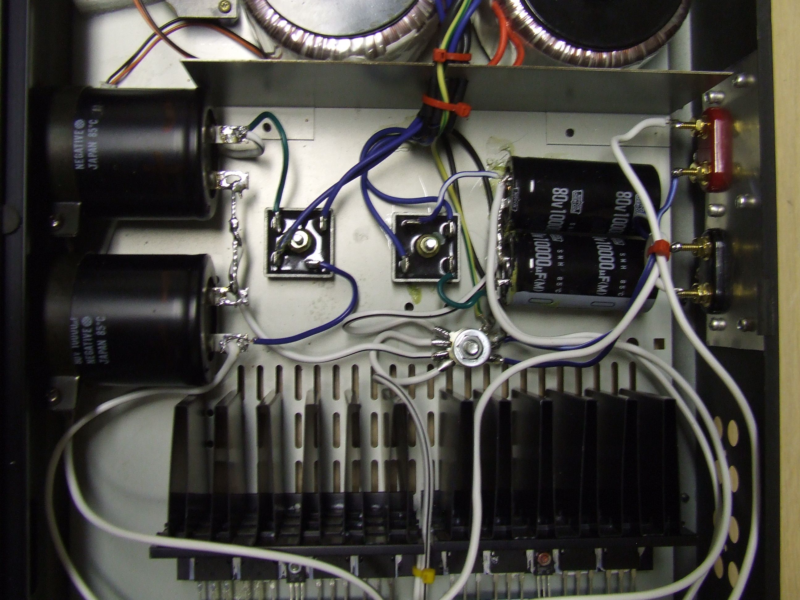

Okay, here are some pics:
(It's my first amp, didn't build it to look pretty. Was doing it for experience... the next one will be much more "as it should be")
Construction looks neat (unfortunately that is no gaurantee of good sound or low noise!). To kick off, here are some pointers to your questions above and from what I can glean from the pictures
1. Your input connectors must not make contact to the chassis other than via the screen cable back to the pre-amp PCB's. Unsolder the connections to your board, and measure with a meter to make sure this is the situation. Same for your speaker connectors and headphone connector if you have one fitted.
2. It looks like you have single PCB's for each channel, both for the power amps, and pre-amps. The 0V of each of these boards must be wired separately to the star ground - but see notes below for the detail on how to do that.
3. The order of the wiring connection to the star ground is important if you want the lowest noise. 'T' off about 0.5cm of thick wire from the exact centre where the main filter caps are joined. Wire the power amp OV lines to this 'T' point. Then make a second 'T' off from the star ground (again about 0.5cm of cable, also thick), and connect your pre-amp boards 0V to this point.
4. The above approach ensures you have no common ground impeadance coupling between the filter caps, the power amp and the pre-amp boards and gives the lowest noise.
4. From the star ground where the main filter capacitors connect, run a solid piece of cable to the chassis. This must be the ONLY connection to the chassis from the 0V.
5. On the incoming earth cable, connect it solidly to the chassis in one place only - usualy this is done quite close to the mains inlet receptacle. This must be the ONLY place the incoming earth is connected to.
6. Speaker 0V returns. The 0V returns from the speaker should be connected between the where the filter caps join (to form the 0V) and the power amp 0V 'T' point.
7. The two wires comming from the transformer that go to the 0V point should connect right where the filter capacitors join, and nowhere else.
8. Remember to twist tightly together the secondary wires coming from each secondary. In the picture above, you have a bunch of wires loosely hangining together, very long and connected via a 'chocolate block' screw terminal to the rectifier and filter capacitor board. There are large capacitor charging pulses flowing in these wires (with harmonics up into the KHz range), and because source and returns wires on each winding are not tightly bound together, they form a great radiator - which is probably getting picked up by the input wiring. You need to look at this part of your amp.
9. Heatsinks don't need to be earthed, but if you are using isolating heatsink washers, then I think its good practice to earth (to the chassis) as part of the mechanical construction.

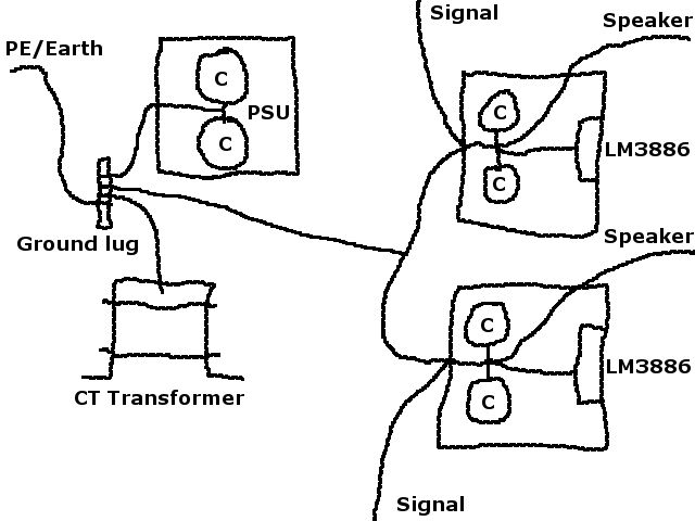

Here is how my ground is done. I have no ground lift and my system also passes the 'ear in cone' silence test.
The signal connects where the ground comes into the amp boards.
The speaker connects directly between the largest caps on the amp boards.
There are 2 smaller electrolytic and 2 film caps between the largest caps and the LM3886's.

Thats not a bad arrangement.
I would do a few things differently personally to reduce common impeadance distortion (which only manifests itself when there is signal)
1. Instead of joining the grounds of the two amplifiers and then running a common 0V to to your ground lug, I'd keep the grounds separate. Another way of looking at this is simple keep the bottom of the 'T' connection very short. The reason is to minimize common impeadance coupling between the amps.
2. Speaker returns -assuming the amps are single ended - I'd bring those all the way back to the ground lug - and preferably right to the filter cap 0V connection points.
By the way, in my earlier post I refer to two 'back to back' diodes. Some people may read this as two diodes in series facing the opposite way. What I meant was 'anti-parallel' connection so the current can flow in both directions once the voltage across the diodes is above about 0.6V.

Neither of those would work in my case, as the PSU and amps are in separate cases. The single ground between them is in the cable connecting them.
