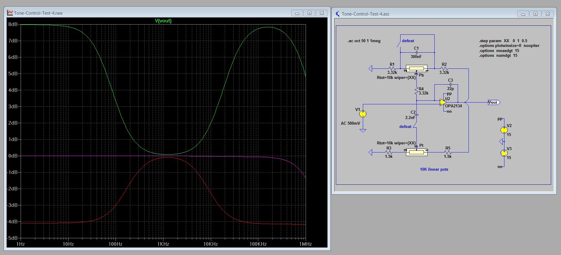

Actually you can put the exact same configuration of the tone stack into a non-inverting config, this just increases the gain (hence mid-band gain will be always be significantly greater than 1). With a little tweaking of the values, you can make a perfect tone control with +-6dB or more.Active tone controls need to be inverting. If they were not then the tone control feedback would appear as positive feedback and the stage would oscillate.
A long time ago someone here posted a +-20dB non-inverting amplifying tone control with the additional feature of a full disconnect of the tone stack with a switch (true bypass), EDIT: but not the one Paul posted.
The only point that is really different is that you can't have unity gain in non-inverting, either it's less (buffered passive) or greater than unity.
EDIT : I recognize Paul just said the same 😉
With a low boost/cut range of +-6dB or less you can get away with linear pots and some added resistors to center the curve at mid position of the wiper.

Found : http://www.diyaudio.com/forums/analog-line-level/194119-high-end-tone-control.html#post2688984A long time ago someone here posted a +-20dB non-inverting amplifying tone control with the additional feature of a full disconnect of the tone stack with a switch (true bypass)
That's the coolest non-inverting tone control I've seen.
It should be obvious that an inverting tone control is easier to figure out, and the circuit is more symmetrical. Of course it comes with well known caveats.

.... aha! I see - the stage will have the required "flat" amount of gain - with a +/-20db control, the "flat" gain will still be 20dB..... a bit much in some preamp applications.....
+/- 12dB gives approx. 4x which is a bit more more normal, ballpark, at least in hi-fi....

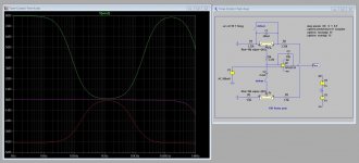

If anyone is interested, I'm really pleased with this one...http://www.diyaudio.com/forums/chip-amps/199130-usable-tone-control.html
The later versions (a few pages in) have improvements that really make it better than the usual Baxandal types in my humble opinion.
Warning: Some unabashed self promotion may be detected here. 😉
