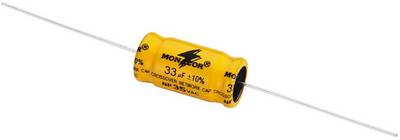

Is it recommended to use NP caps in xovers which ask for big value caps in the woofer section?
1. What about the sound quality as compared to MKP or other usual Caps used?
2. If they blow (being small in size) is there a risk that the driver speakers blow simultaneously?
I will need to use 68uF in series with the woofer and 82-100uF for the mid. Any advice an example of such cap can be viewed as attachment.
My amp is rated at 50 w /8 ohms per channel, and printed on the cap as follows; 35 VAC. Will that do?
p.s just read on the datasheet
LSC-330NP
Bipolar electrolytic capacitor, 33 µF
LSC-330NP
- Voltage stability: ˜ 35 V/ DC 100 V, 150 W/8 Ω, 300 W/4 Ω
I have read somewhere that there is need to add in series a small polyester or MKP MKT cap with the NP cap . I do not remember the reason why. Is that true?

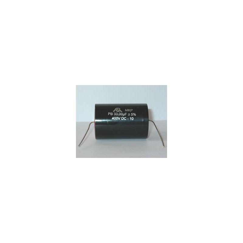

If electrolytic capacitors are the only feasible type for your low frequency XO, then you'd surely be much better off with an active XO or DSP for that freq (the mid-range and tweeter can be OK on the same amp together and a passive XO for them).
Electrolytic capacitors have widely inexact values and also age. Like using duct tape on a water leak.

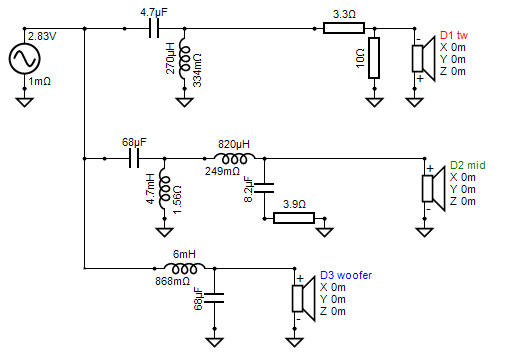

I just opened my bookchelf speakers JBL E20 Northbridge speaker and found that JBL uses only such NP caps in the xo (9 uF bass and 5uF tweeter)
To come back to my project, I intend to use 68uF NP caps for mid and woofer sections.
Another question: can I mix NP cap and polyester MKP types in parallel to achieve this value?

His 50W into 8R amp probably works on ±35V rails (if it is a chip-amp) or even more. I'd go for higher voltage caps, for the peace of mind.Not necessary in my opinion.
50W into 8R means E = sqrt (P x R) = sqrt (50W x 8R) = sqrt 400 = 20VRMS or 28.2VPK so 35V is fine. But:
I = sqtr (P/R) = sqrt (50W/8R) = 2.5 ARMS.
So check your cap can manage such current safely, otherwise it will overheat and explode.
But in the speakers outputs, only speaker voltage and current are important. Rail voltages is an internal problem of the amplifier. You can do it with +/- 35V or +/- 4000V if you want, but while the amp gives 20V and 2.5A rms, a 35V cap suffices. Moreover considering musical program where full peak voltage is sporadic. And I doubt the guy uses 50W all the time. Probably 3 or 4W no more.

@ op :if you have not the tool to measure capacitance of the caps, just go for mkt or mkp with 5% precision minimum. SCR or Jantzen or monacor first prices are cheap enough. electrolythic NP for speakers have easily till 10/15% precision only whatever the % claimed by the brand.
