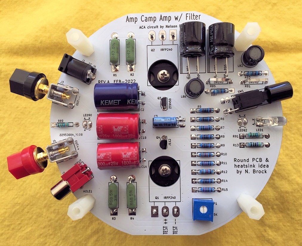

Nelson Brock created a bloody wonderful implementation of the Nelson Pass "Amp Camp Amp" (ACA) and unveiled it a Forum thread: (here)
I liked it so much that I copied & reimplemented it, creating my own PCB layout, including a couple of new features (in post #57 of his thread). I called it "RACAM".

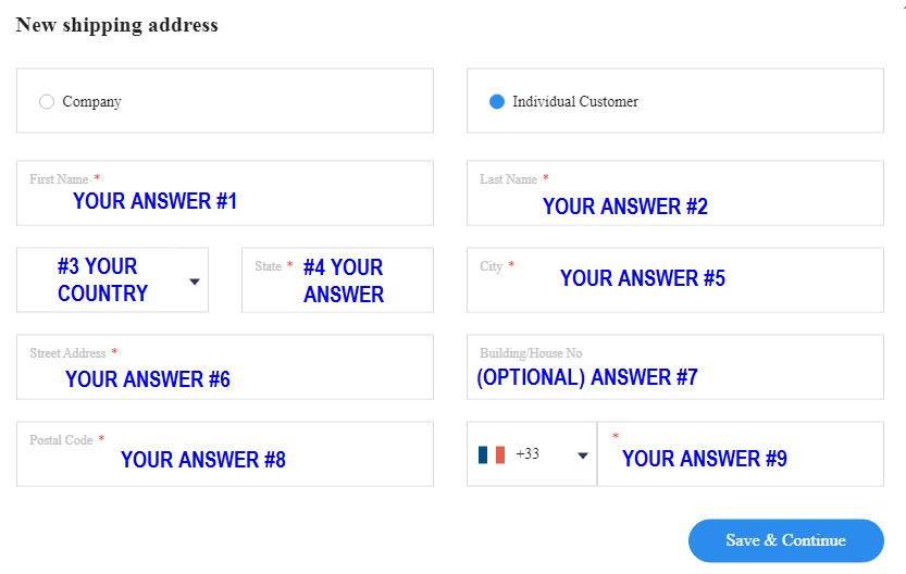

  1. Send me a Private Message "conversation" containing your ship-to address EXACTLY AS JLCPCB WANTS TO SEE IT (attachment #5 below -- boxes with red asterisk * require a nonblank answer). Please answer all nine of their questions.

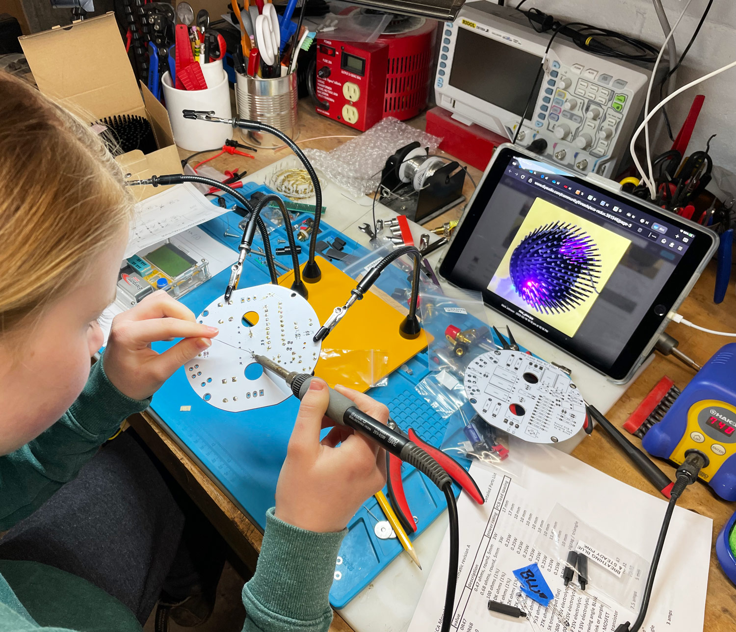

6. This isn't a dead-simple project suitable for absolute beginners. However, Patrick Farrell's 11 year old daughter did successfully build a pair of these, there are photos in (post #80) . She and her Dad have built other amplifier PCBs before this one.

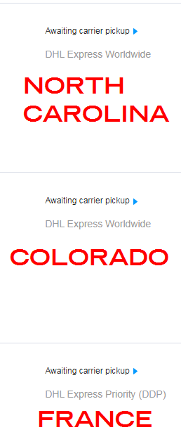

Joined 2011
Three of the orders are now complete, boxed up, and sitting on JLCPCB's loading dock, waiting for DHL to pick them up and ship them out. Two more orders are still In Production. The sixth has been delivered in Italy.

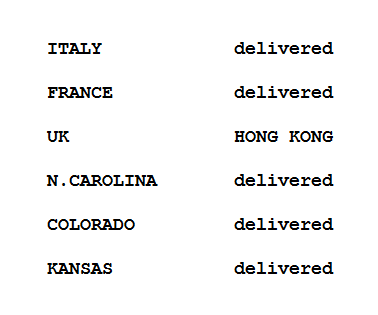

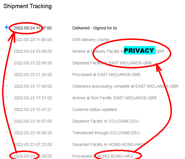

Joined 2011

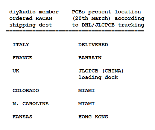

The first six batches of RACAM PCBs have completed their trip through the manufacturing line, and are now en route to their destinations via DHL. As of this morning, the status of each shipment is shown in the table below. Each of the shipments includes qty=10 RACAM printed circuit boards. So, pretty soon, the informal and worldwide RACAM distribution network will have an inventory of sixty RACAM boards. For sale or trade or barter or gift or opportunistic severe price gouging.
And of course any diyAudio member can join this network & become another distributor, at any time. Just follow the instructions in post #1 of this thread, and I will order ten RACAM boards to be delivered straight to your home. When they arrive: give them away, or trade them, or sell them; however you wish.

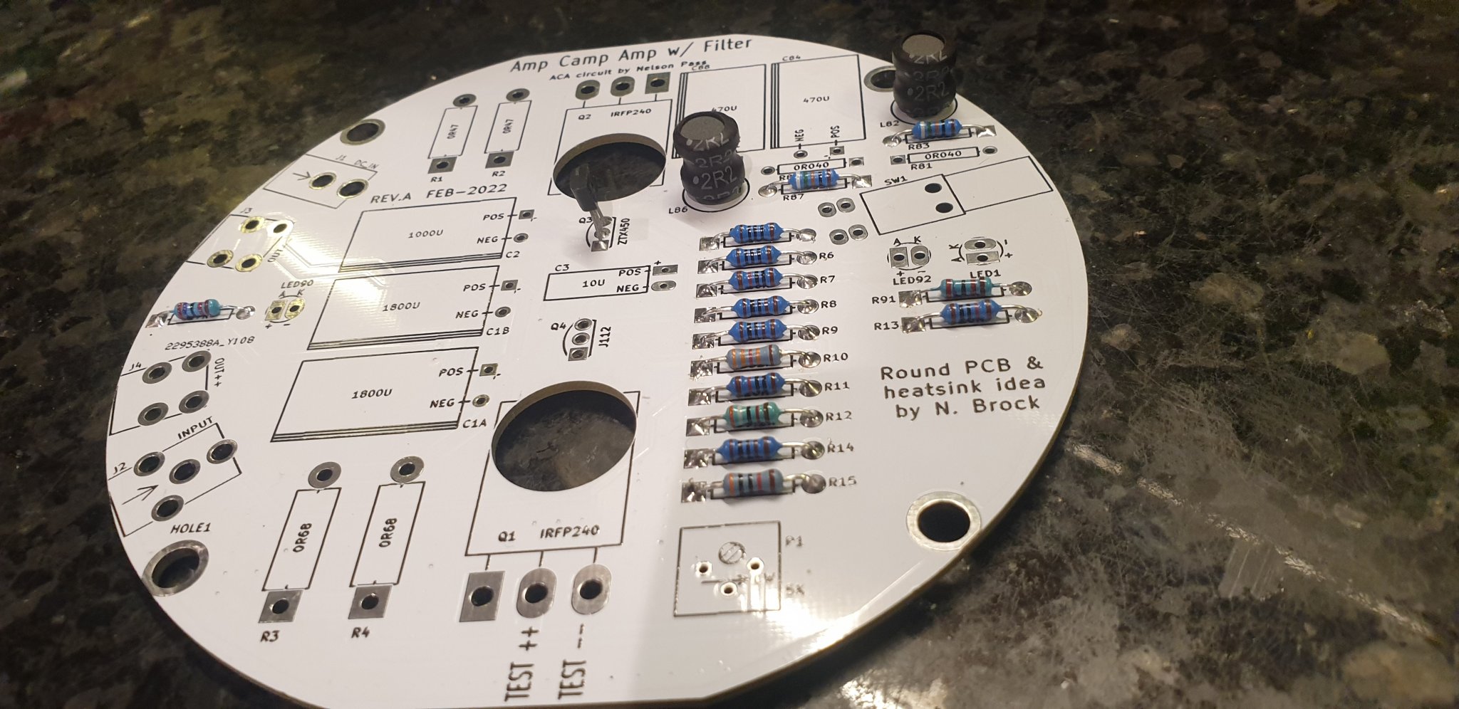

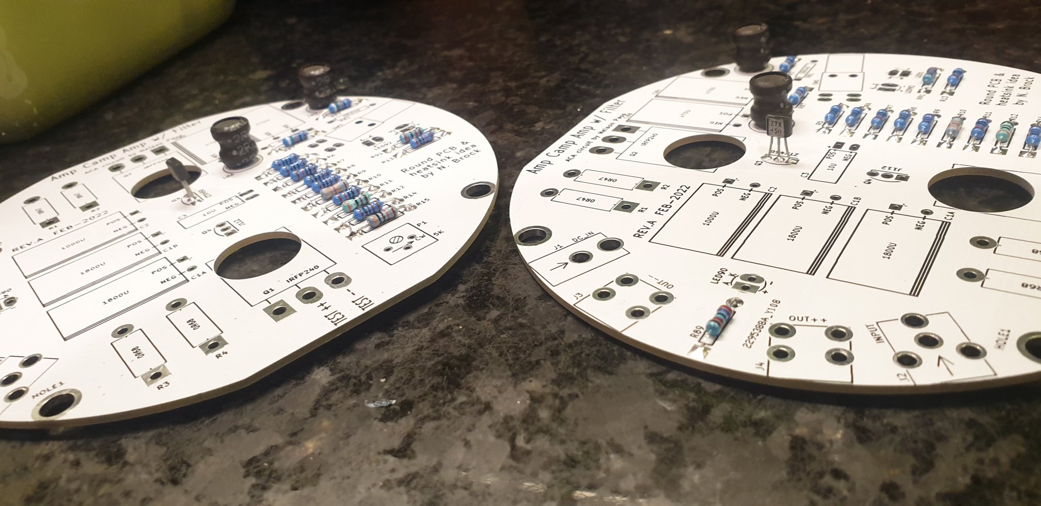

Joined 2018
Boards received via the UK 'agent' and partially populated.
Came up with a parallel solution for 2.21k. Think I'm within 1%.
I have most parts here amd I also built some of Mark's smps filter so good for those parts.....I notice the Racam psu input doesn't have the 'big diode looking thing'! And also thought I was lucky with some board mount RCA but unfortunately the pins aren't compatible.
Ordered the heatsinks.
Great project. Thanks Mark and N.Brock

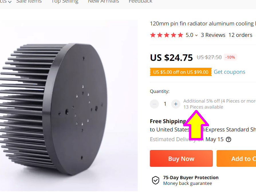

I do have one problem, sorry if it's been discussed and I missed it, but I can't find a source for the 120mm heat sink. It's not in stock at Aliexpress or Amazon. 133 mm's are available. Does anybody know of a supplier?
