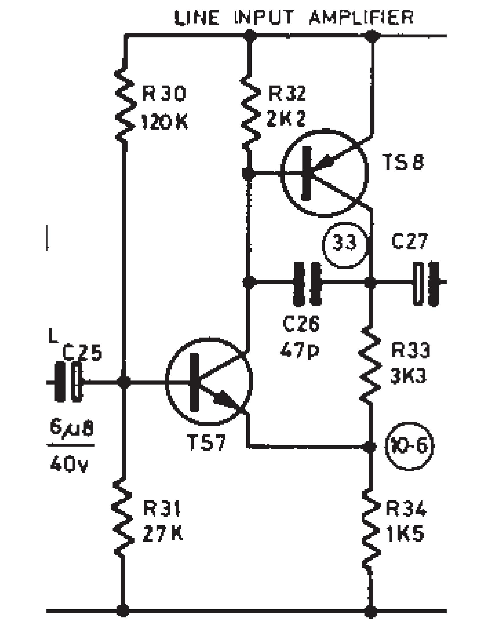

I would like to take profit of your kindness and knowledge 😱
I am attaching a schematic i cannot get out of my mind for a simple question
The question: do you think it will work just fine with
R32=R33=R34= 2K2 ????
I would like to reduce parts number as much as possible an buy nice ones.
I have already bought npn and pnp
Then i would buy a PS kit based on tl783 chip.
Maybe i will be able to build my first line stage ever
Thanks a lot indeed
Kindest regards, gino

Is that from a Radford ? That's a classic (and great sounding) two stage amp
Hi yes Sir ! You are right 😉
Someone pointed me to this file here 🙄
http://www.acousticpsychos.com/Files/Radford-HD250-ZD22-int-sm.pdf
On page 15 the schematic of the line stage can be found
Not needing the tone controls section and the ouptut section, i am focusing on just one gain stage, the input one.
Vsupply is uncommonly very very high at 60V, single supply.
For this i will use the tl783.
But i would like to simplify it even more reducing parts types.
Using all 2K2 resistors it would be easier to build.
It is my very first attempt to build something.
Do you think it could work with the following values
R 32, 33, 34 = 2K2 ?
What could be a good Ibias value the npn bjt "TS7" ?
I am using overrated parts anyway ... avoiding in this way the need of any heatsink on bjts.
Thanks a lot and kind regards, gino
