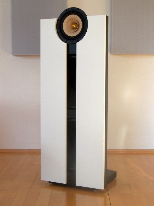

I'm thinking of building a speaker with this design, (2 x 15" + 8") but maybe with a coax instead of a widebander.
Also the bass could probably be like in the XSD design? 8 x 6,5" in a SLOB.
What would be the pros and cons bass wise? The SLOB has an advantage of force cancellation? Other differences? Is there a difference in dispersion around the crossover point (400 Hz?) with these two bass setups?
I said I probably would use a coax, but has anyone heard the actual Tang Band? If it (or any other widebander) has "good enough" tweeter response, I could use my 4 channel miniDSP Flex. Otherwise, I have to swap it for the 8 channel version.

What about 2 X 38 cm (sub) woofers and a 20 cm nominal diameter wideband speaker?

Those are probably custom made woofers. You can commit a low Q big membrane enough stroke.

2x15 will have Sd around 1700cm2.
8x6.5 will have Sd around 1100cm2
I’d go with the 2x15 for the extra surface area.
A slob design will give you some amount of boost in low frequency sensitivity, which can be helpful. But it does act like a short transmission line/resonant chamber, which can affect frequency response. Personally, I prefer direct/front radiating drivers on a flat baffle. Either design can work.

I would think that's quite a gain for whatever tradeoff. Cabinet vibration or in the case of an OB, panel vibration. Plus all that mass and stiffness of the SLOB structure, that's supporting the front facing panel.The SLOB has an advantage of force cancellation?
Ah, hide all those woofers in the back! Nice looking speaker.It has a design that visually appears smaller than it actually is. Higher WAF. ; )
