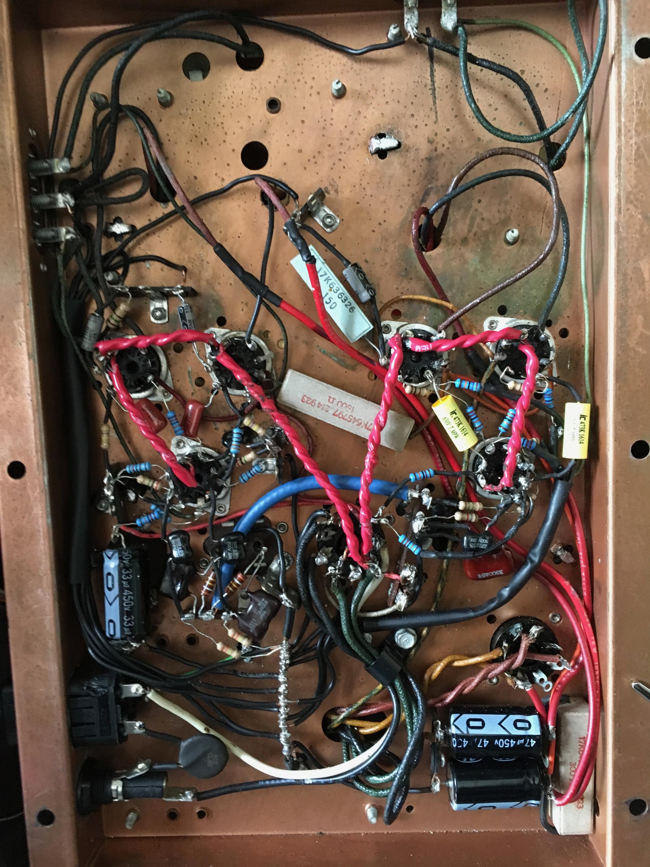

I've been struggling to eliminate a nagging low-level 60hz hum in the power amp section of a 1960 Motorola console (left and right channels are SE, the bass PP). So far I've replaced almost all the components except the transformers and power supply resistors. Most significantly, I've reworked the original chassis grounding into a star/busbar scheme, and installed a 3-prong plug for a safety ground. (yes, still hums with ground lifted)
The hum is better, but still there. However, the amp will now motorboat under an odd array of causes:
Going inside the amp, most voltages check out, however the motorboating often commences when the meter probe touches pins in the left channel circuit (most often the plate and cathode of the left el84, but sometimes also the grid of the 12AX7, and rarely the left input jack itself). The motorboating usually stops as soon as I remove the probe, but on occasions where it doesn't, it is sometimes stopped by simply contacting the busbar ground and the chassis with the multimeter probes.
So my suspicions lay with a bad ground and/or a stray, wandering capacitance in the left channel. However, all the grounds appear to check out, the socket pins have been cleaned and retensioned, a suspicious wire to the left OT replaced, tubes substituted, resistors and caps check out. There is no short in the OT. Anything else I should check out that could be the cause? Do I need a scope and/or variac to diagnose?

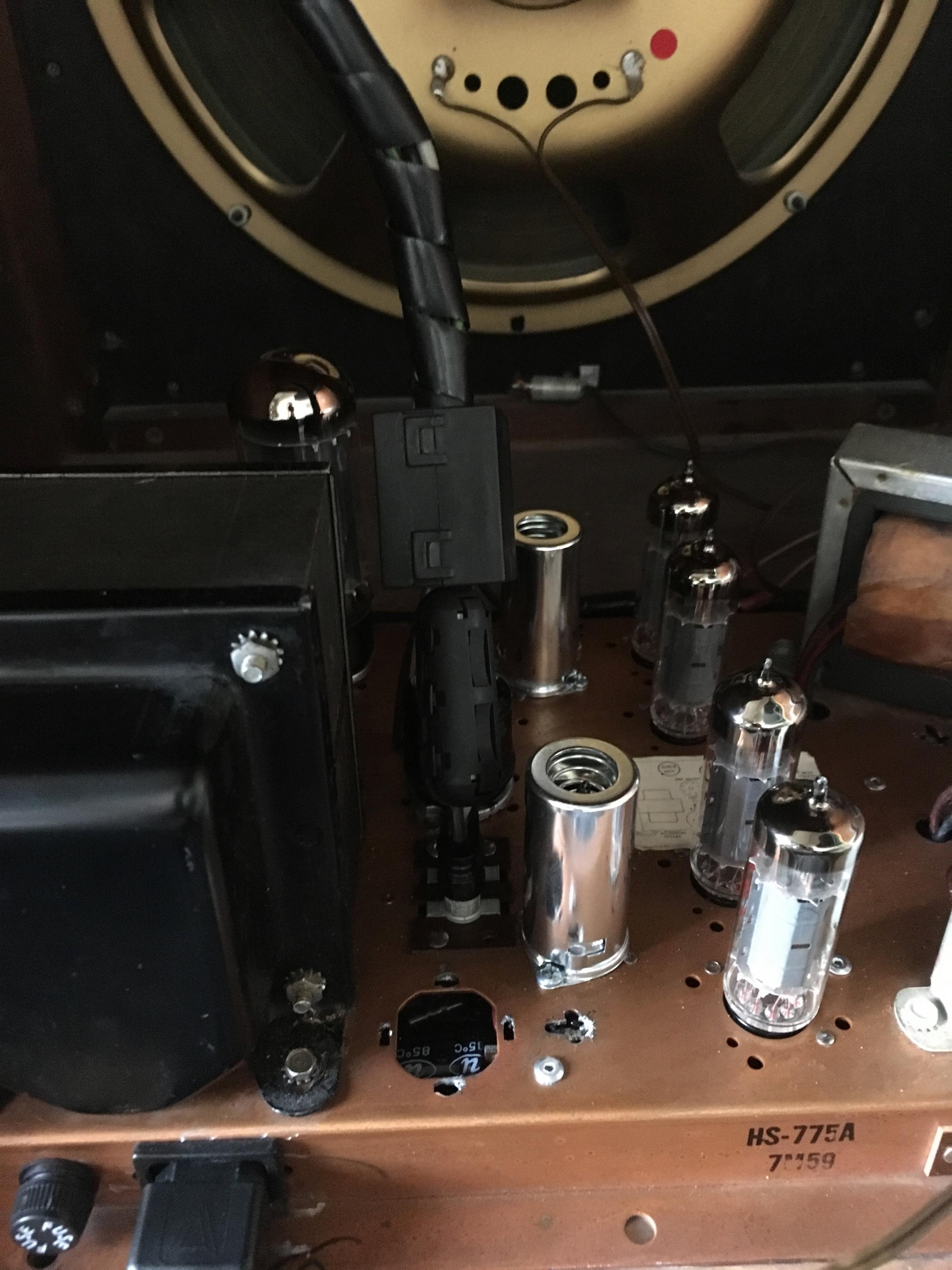

Schematic and photo below. Left and right channels on the left, the right channel is closest to the left edge.
- when no input (separate rca cables) is connected
- with shorted inputs (shorted rca cables)
- when the left and right input cables are separated by any distance near the input jack (which is inexplicably next to the PT, which can induce hum)
- does not motorboat when a long combined input cable is connected to the amp but unconnected at the other end.
- whenever the left channel power tube (el84) or the wire to the left channel OT is wiggled.
Thanks for any help!
