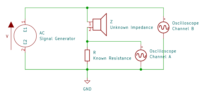

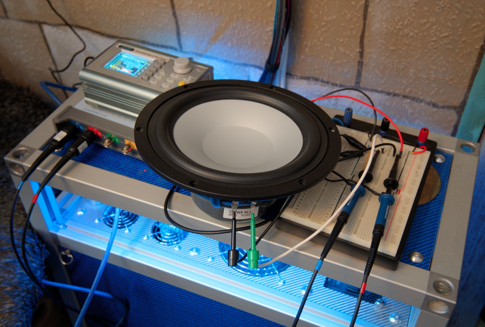

You need a setup like this:

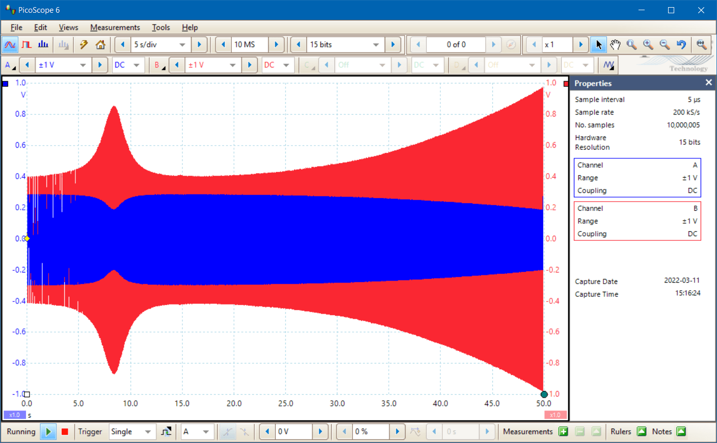

To capture a frequency sweep like this:

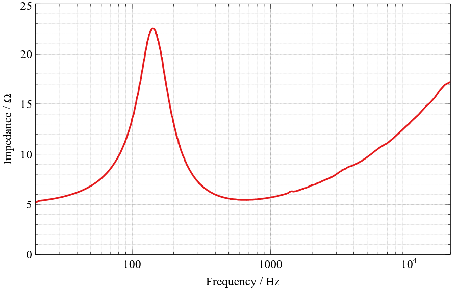

Which OIC can process so it can be turned into this (actually not from the same speaker as the above image, but you get the idea):
