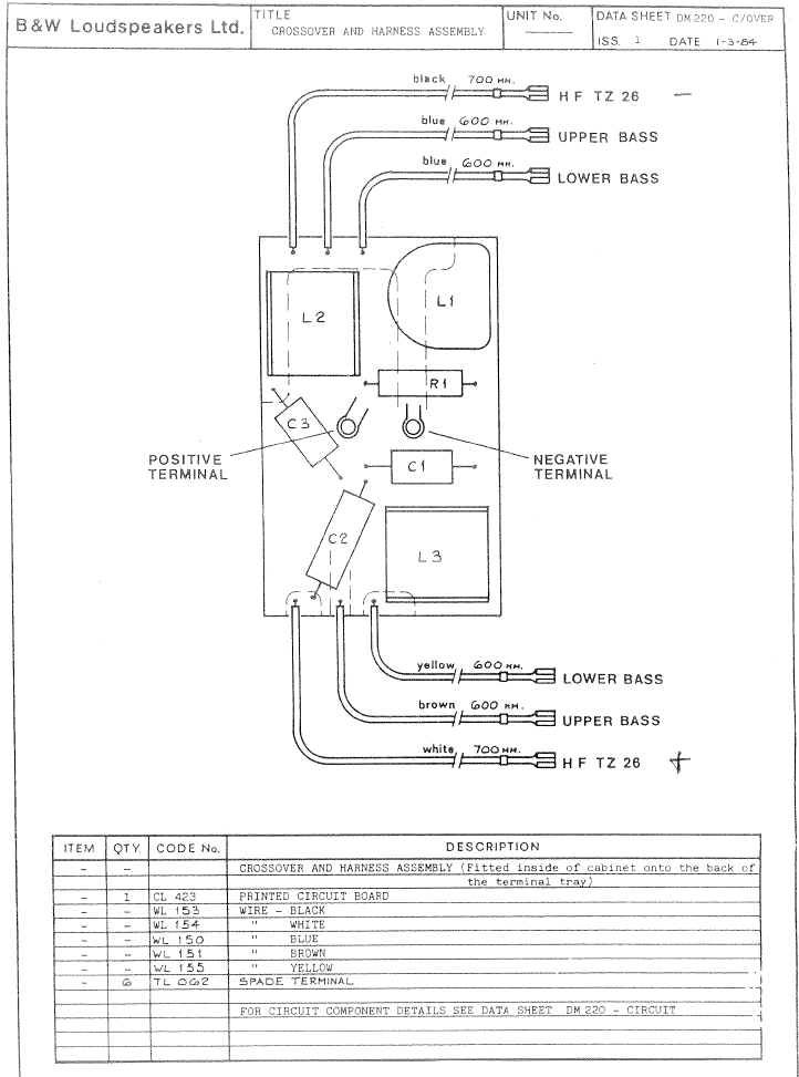

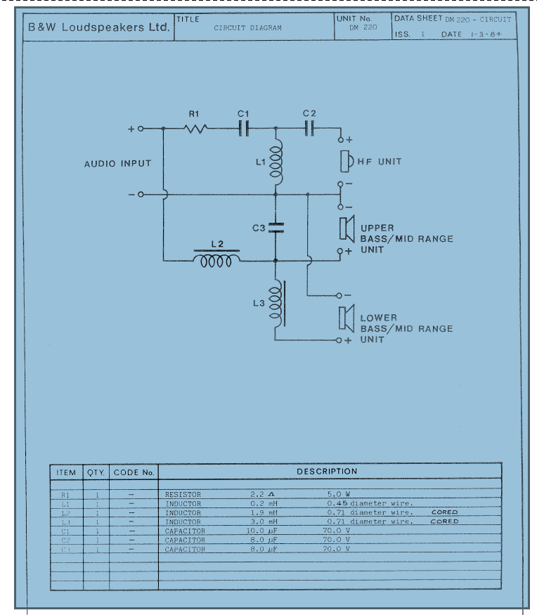

Don't know if the crossover is 2 to 2.5, I have attached the pics of the crossover info sent to me by another forum member. Crossovers are a black art to me at the moment...

Okay, then: this is 2.5-way. You can see that the lower bass driver has an extra inductor in series. Start by using the connection for the upper bass driver, and match tweeter level by tweaking the resistor. My guess is that this configuration will require some baffle step compensation. If you can get the schematic of a DM110, it will bring you a step closer wrt baffle step compensation.
One more thing: now that it has been ascertained that the driver are the same, I would recommend a bass reflex enclosure as per the original DM110. From what I recall, the DM220 has a tighter bass, but the DM110 had a bit more kick. If you could get the Thiele-Small parameters, you could model a design design that goes lower than the DM220, but still control the Q such that it is not boomy.
