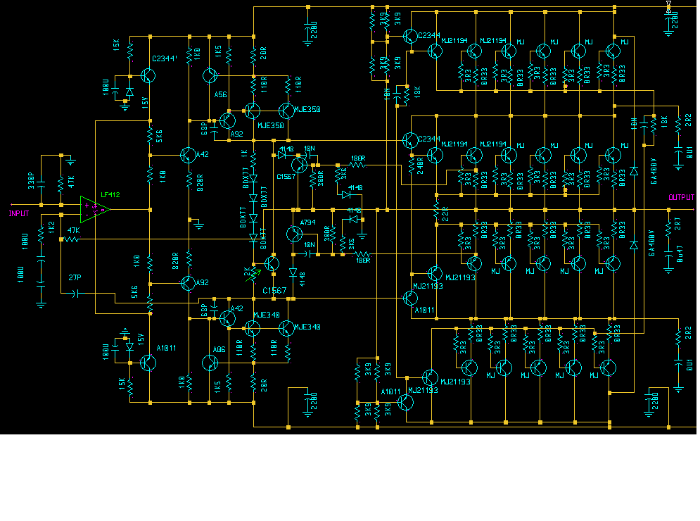

Hello, maybe question can be to what point to increase power supply voltage, of course completely changing transistors output stage(MJ15024,15022,...), preserving quality and increasing output power?Yes, it is similar to Bose 1801 but is not same,..

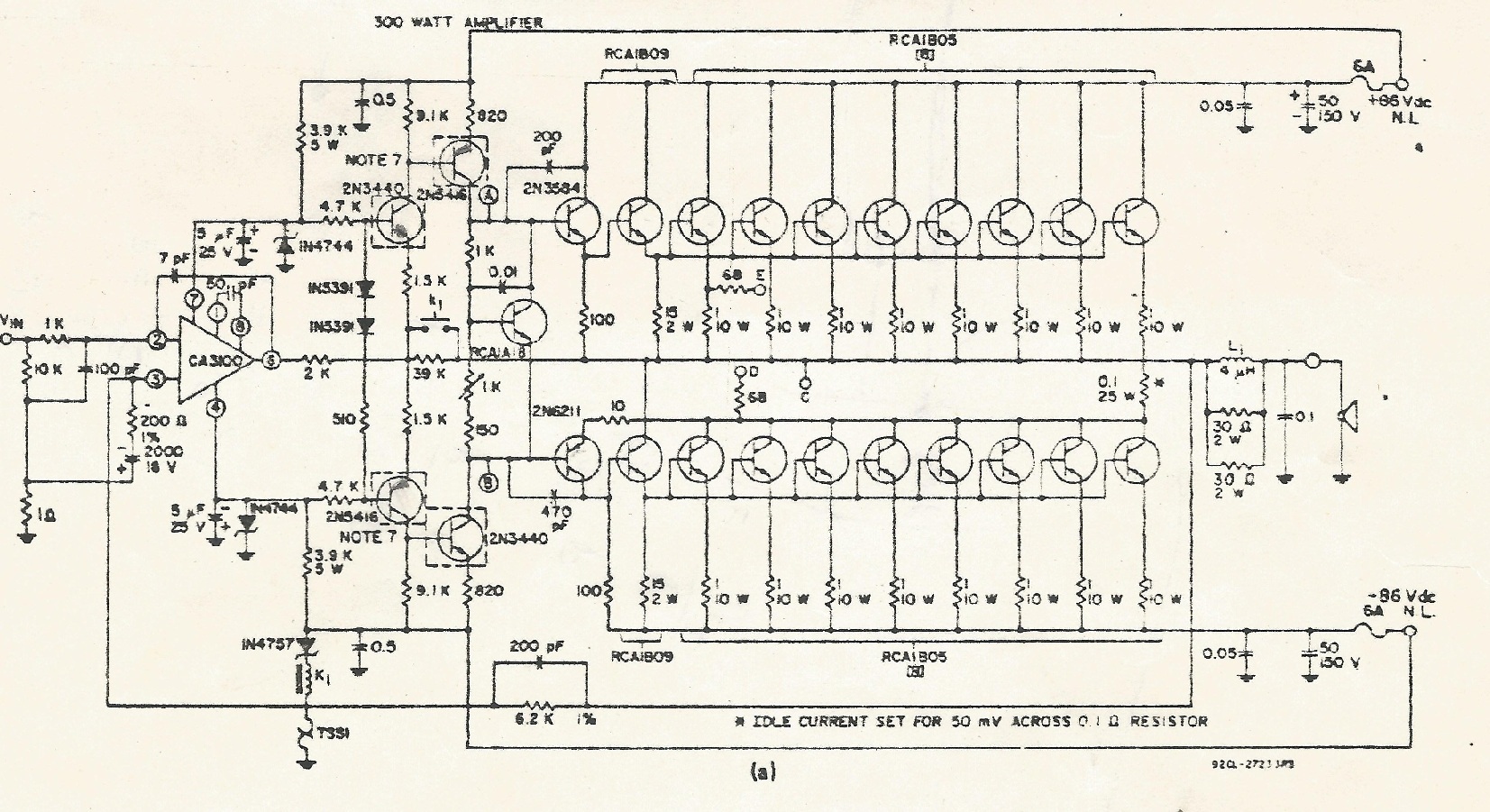

Schematics is suggested design from old RCA power transistors datasheet book.

Similar to Bose 1801, similar to BGW500/750. You can't increase the supply voltage by much, even with more modern devices. They all run up against the same limitations at elevated voltage. +/-85 or so is about as high as you can go, highest I've seen successfully is +/-93 (QSC USA1310) with MJ15022/4's.
The same kind of front end can be put on a S-Leach cascode OPS. I've run this off +/-127V with two lab horns in parallel (about 1.5 ohms). Other than a ridiculous AC current draw, it runs fine.
Thanks wg_ski for suggestions, i think this RCA schematics can without problems run at +/-100V with MJ15024, only i dont know what output power it will be on 8ohm due to emmiter resitor value1ohm transistor working point decision,..
About 350 watts at 8 ohms. Careful with 4 ohms, and don't run 2 ohms at those VCE's.
You don't need 1 ohm emitter resistors with modern transistors. 0.5 or even 0.33 is fine if you use transistors with the same batch code and made after 1990.
If you could keep the supply rails fixed at 100V, sure. The USA1310 produces 325W at 8 ohms from +/-93 unloaded, reducing to +/-78. Claims 400W, but that's at 1% distortion, which is clipping. The old PL700 produces 380W unclipped from +/-110V until it explodes 🙂. Most practical power supplies just aren't much stiffer.
The 1700 is the same as the USA1310. Minor schematic updates and a change from Toshiba outputs to Motorola - but it's the same power supply.
Looking at the datasheet for RCA1B09 (R.C.A Solid State Power Devices 1978) I see that increasing the supply voltage from around 86 to 100 halves the current that can be safely conducted. That implies doubling the number of output transistors for this particular device.
If you are going to use ON Semi equivalent parts the number required would have to be capable of handling the same current as the 16 R.C.A power transistors needed in each supply rail. You would need to double the current handling ability of the driver stage as well.

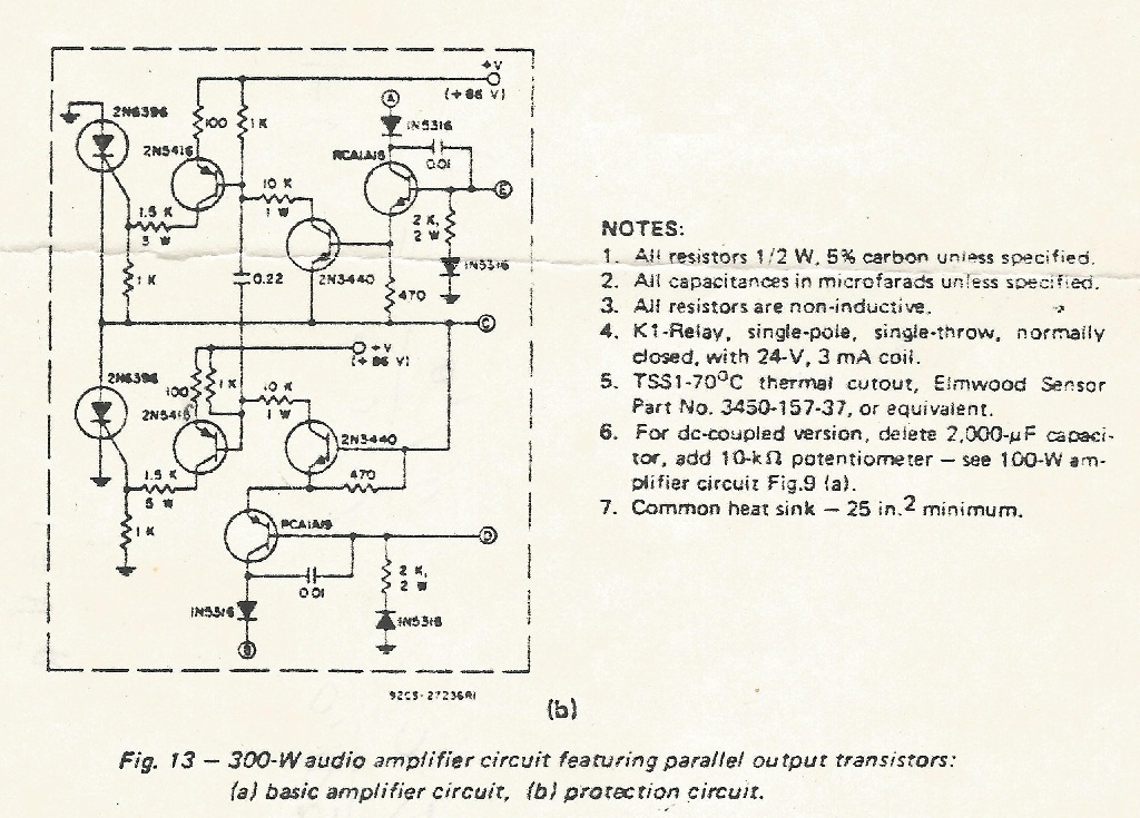

There is a matching safe operating area protection circuit. This is scaled to work with 1R emitter resistors and any reduction in that value will marginalize the safe operating area of the output stage in proportion. Extra devices will also have temperature implications - there is a temperature cutout device and if you are to make use of the hoped for extra power you would not want this cutting in before the power potential is reached.

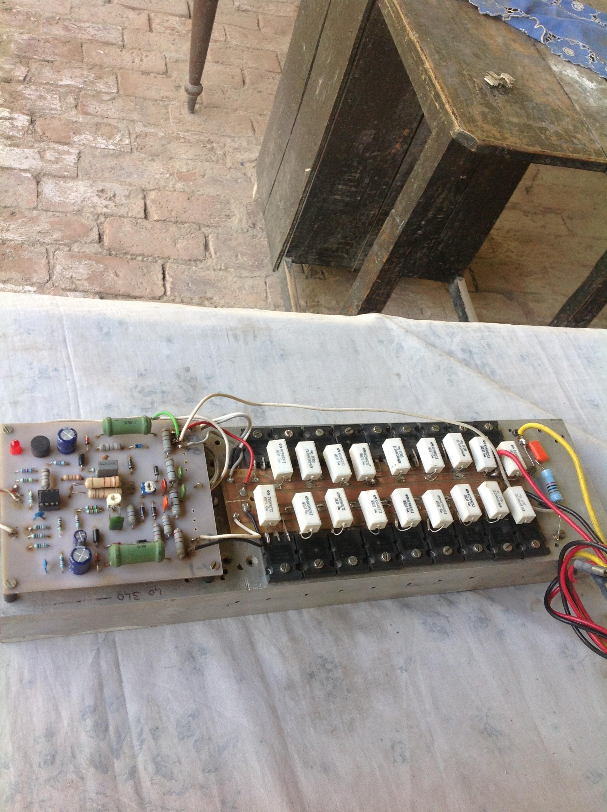

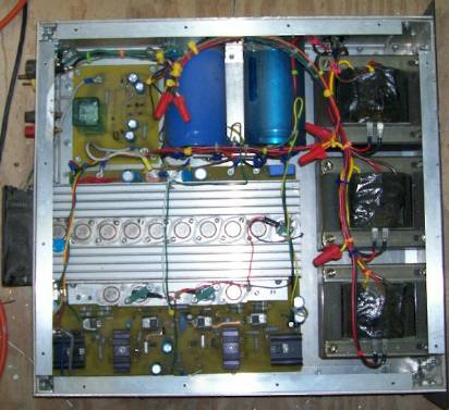

Of course, changing 1R emitter, to R39 causes different protection result, must also be calculated to lower resistance of protection circuit input. When increasing power supply voltage is in project then i compare Phase Linear 700 series II with these RCA one output stage, diy PL700 with 10xMJ15024 chanell and voltage +/-110v capable to 500W RMS/8ohm-approved, and this RCA with 16xMJ15024 with same voltage +/-110V must be capable to run 1000W RMS/4ohm(8ohm?-maybe 550W) Also diy copy of phase linear 700 series two output stage operates on tunnel fan heatsink, without that- thermal overload,..

If you reduce the emitter values to 0R39 you might consider installing low value resistors in the base feed to each output transistor so the output currents are evenly shared. With 16 output devices there is a greater chance of encountering one which for some reason will have more current gain than the others and hog more current leading to failure. Temperature effects increase current gain and with a fan blowing to the opposite end in a tunnel you might consider accumulation of heat in the airstream down the chain of devices.

Considering the original R.C.A. with 1R emitters, a voltage drop of 50 m.v. across each, would result in Iq (quiescent current) of 400 m.a. It would be a good idea to reduce the emitter voltage drop to 25 m.v. if you were to double up on the output device numbers.

i Will not touch 1R emitter resistors, they are not projected by stupid engineer,...

QC triples often have stability issues. Run one on +/30V, and it is stable with absolutely ANY bias current. From full class B to full class A and everywhere in between. Crank it up to the +/-80V range and everything changes. They are stable in class B (aka PL700) and at high bias (like the RCA circuit and its variants). But try to bias the output stage at something sensible - like 3 to 5 mA per devcie (which would result in a class AB with reasonable idle dissipation) and they break into oscillations on the negative half cycle. Sometimes destructive, but not always. But always VERY annoying and usually hard to get rid of any other way than changing the bias. Use a full complementary, which is possible with moden MJ2119x devcies and you can pretty much bias it anywhere. With mine I usually run around 3-5mA per devcie, which would normally be considered "underbiased", but with as much loop gain as these topologies have at 20 KHz crossover distortion isn't an issue. Obvioulsy so, because you CAN run them class B.

I note the output devices 66546 are RCA410's relabeled -these heavy duty but low fT of 2.5MHz. I notice your choice of complementary replacement devices have fT values of 4MHz which would no doubt enhance loop stability. I think NPN versions would do the same in a quasi complementary amplifier.
By way of comparison those in the RCA amplifier have fT values of 5MHz.
