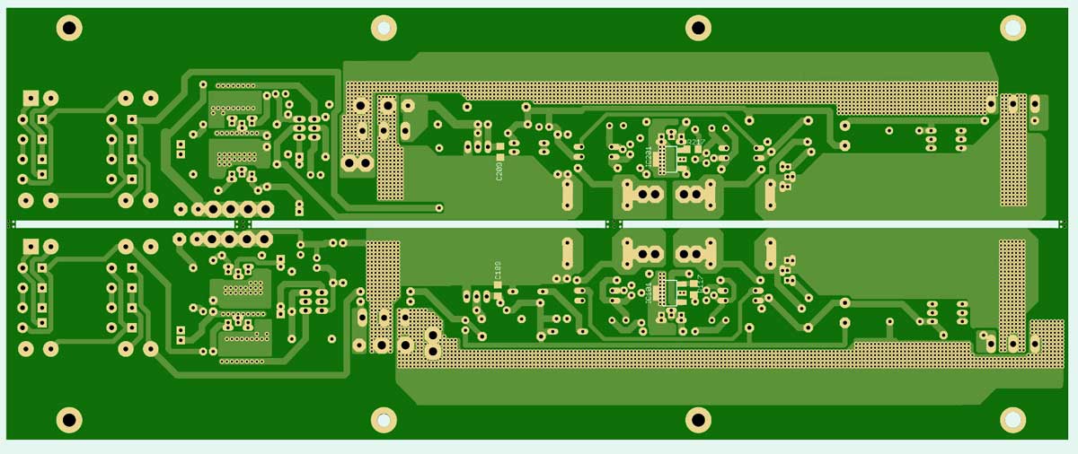

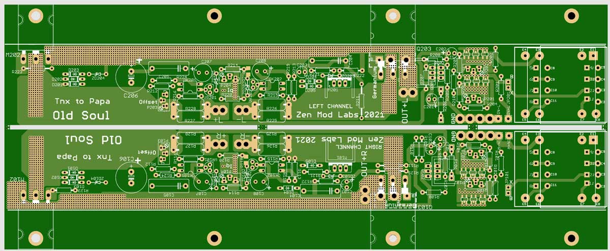

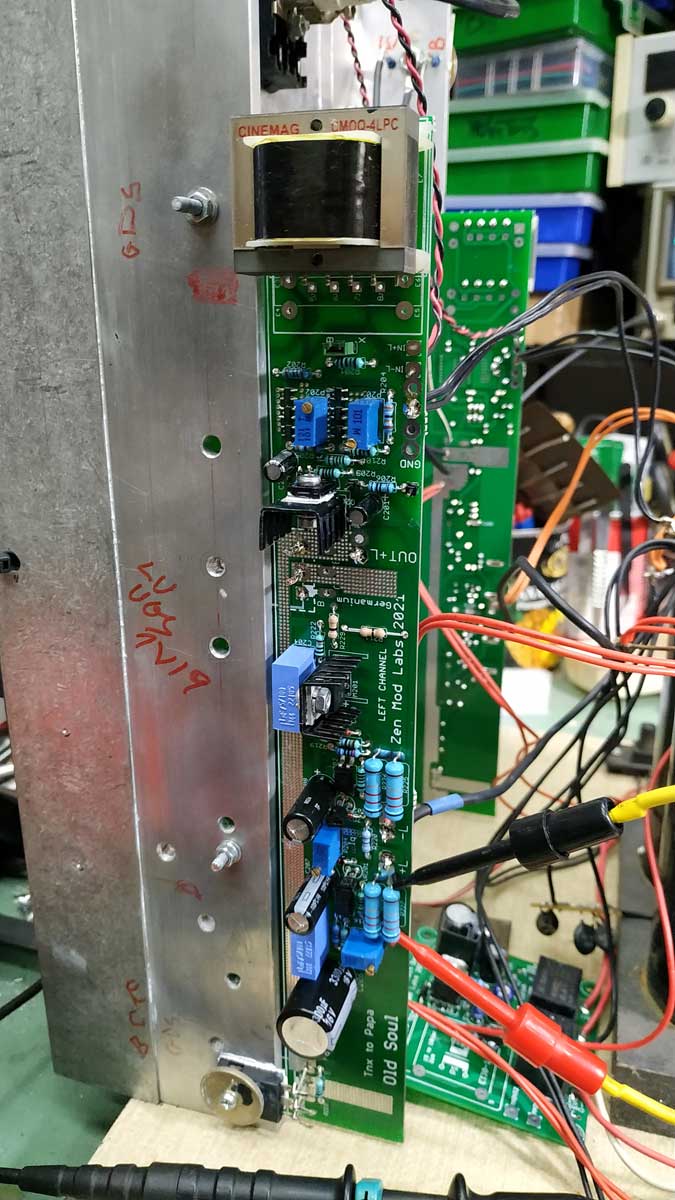

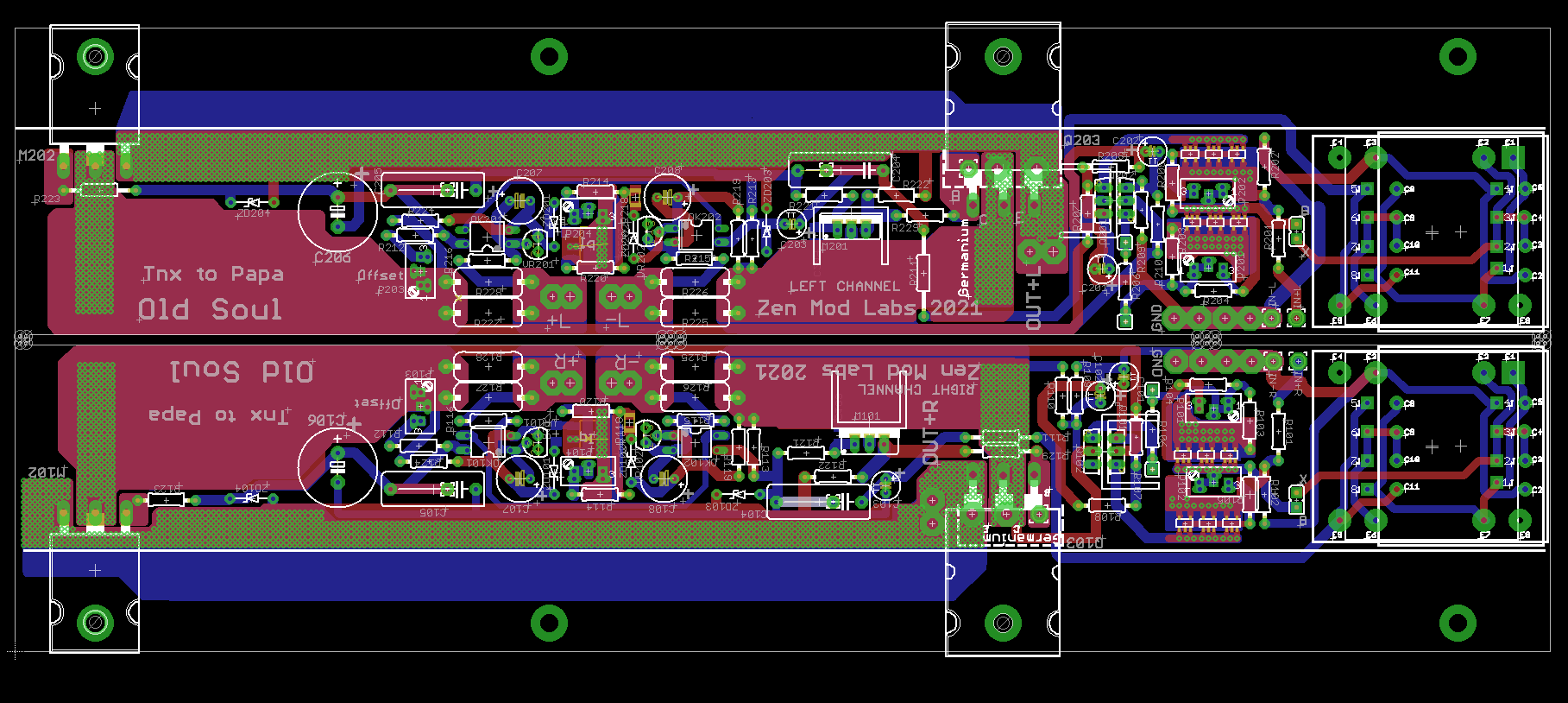

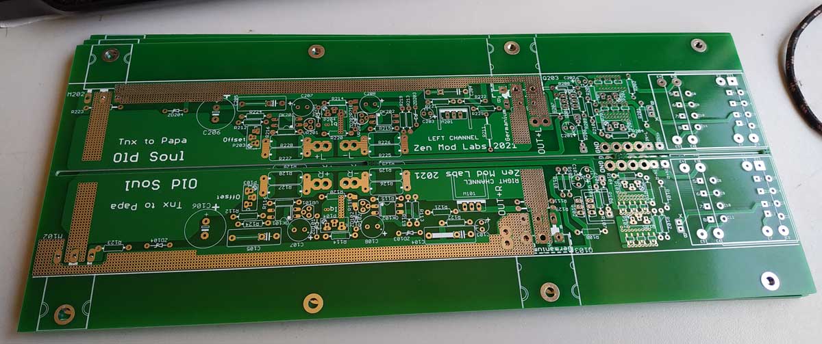

Objective: make it before Pa, and (normally) make it more complicated than Pa

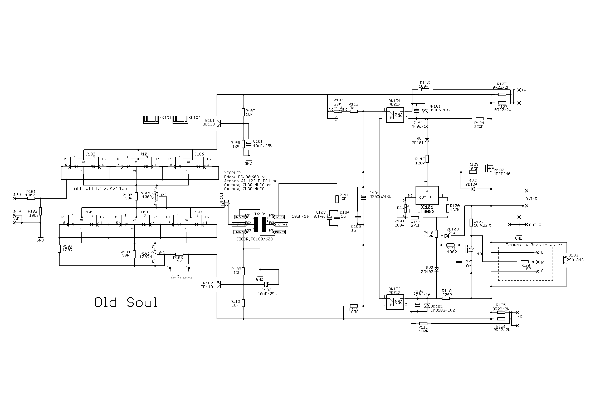

What: amp using Germanium Biguns
schm:

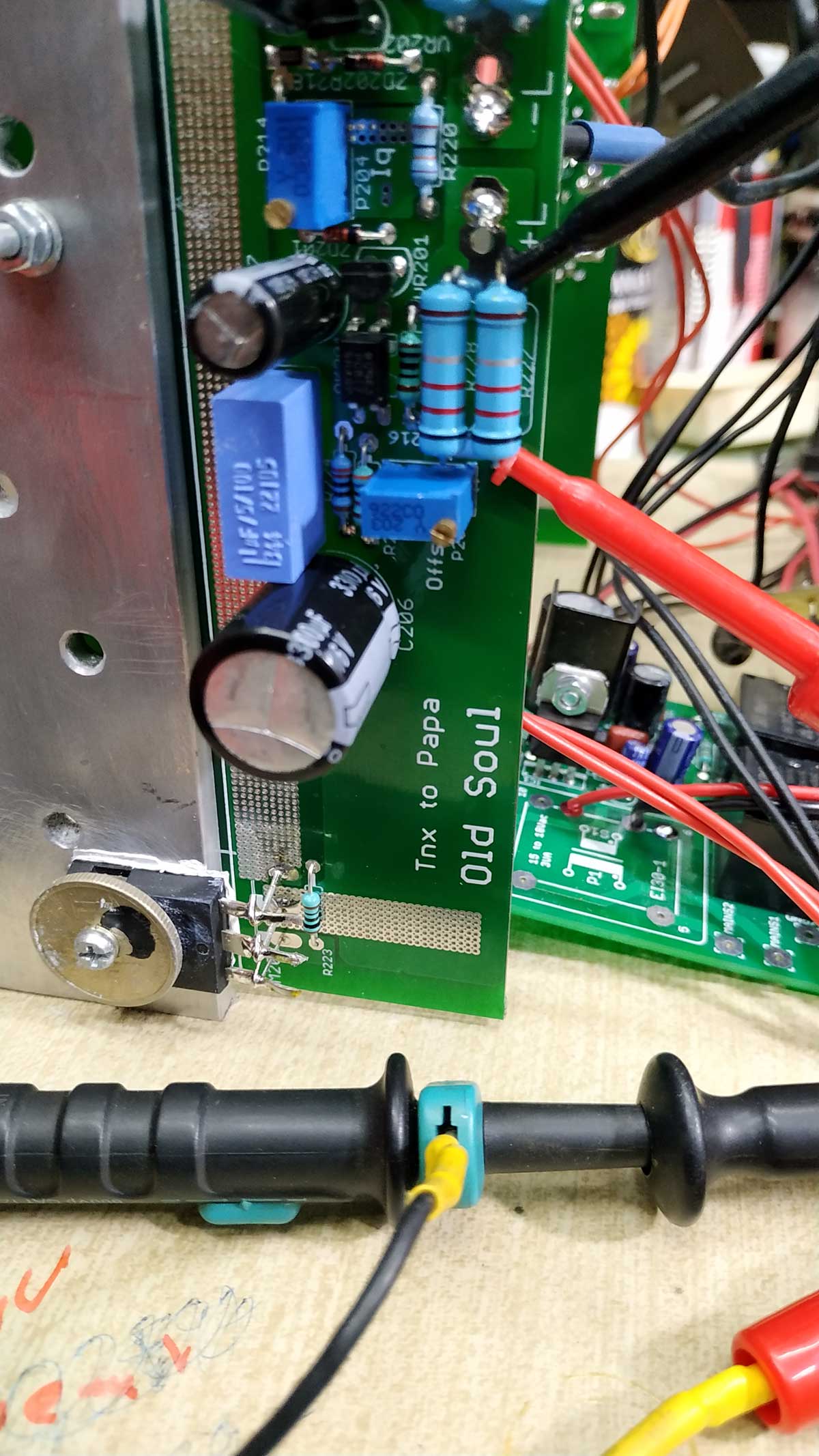

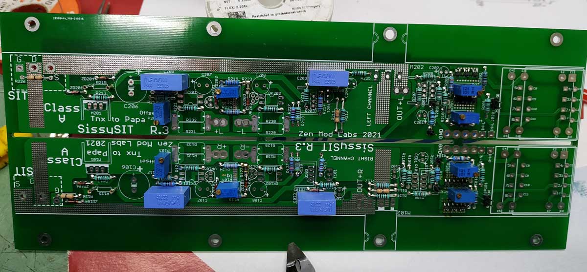

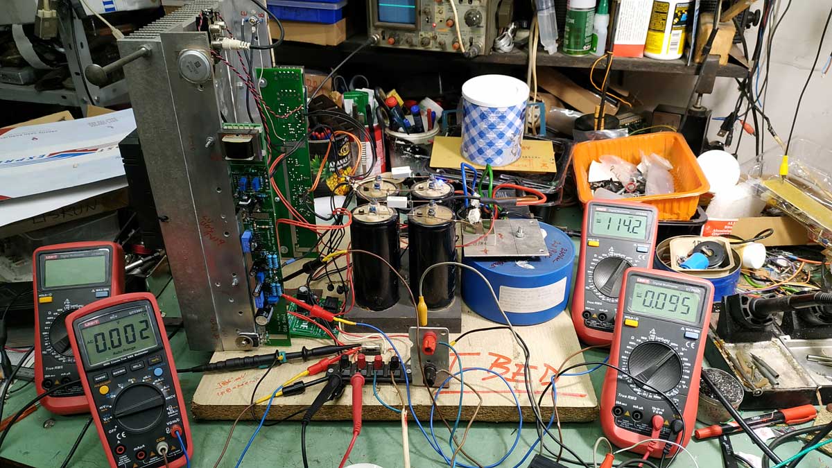

edit on 15.09.2021 - few general setting procedure tips and tricks; be sure to read to the very bottom of post:
-will not teach ya how to solder everything properly - as always -Assembly of Japanese Bicycle Require Great Peace of Mind
-prior to powering up, be sure that you have trimpots set properly:
P102 (P202) - irrelevant
P101 (P201) - set to max; confirm with ohmmeter across R104 - in vicinity of 28R
P103 (P203) -irrelevant
P104 (P204) - set to min ; confirm with ohmmeter - improvise where to put probes
- jumpers JP101/201 - open/not mounted
-as always - best to work with one channel connected to PSU at time; in fact - first step just one channel , in second step - you can freely leave powered/connected already set first channel
- one VMeter across output ( DC offset) , second VMeter across any of current sense 0R22 resistors; use mini-clips/probes
- no load on output, input shorted to GND
- power up thingie; observe DC offset - it will rise slowly and everything up to several volts is normal in this moment
observe VMeter across 0R22 resistor - it will be Dodo reading for some long time; after 60-90-120sec - if you don't see any substantial reading , start fiddling with P104 (P204), one turn at time; of course - you did remember where you rotate itr to set to min value, now rotate in counter direction; - don't ask me which - I don't care, I can't remember, simply because I'm always trusting in DMM, not in my memory how to orient damn trimpot to have screw in proper place ....... and my logic what needs to be decreased and what needs to be increased is always ooked, vs. overall consensus![rolllaugh :rofl: :rofl:](https://files.diyaudio.com/forums/images/smilies/rolllaugh.gif)
allow 30sec or so between 1-turn steps, to observe when and how much mV you're getting across 0R22
goal is , , say for 1A of Iq - 1A * 0R11 = 110mV
keep fiddling to get mV creeping up, and once when you see steady rise for each turn, set da thingy to - say 80mV
(if you're using Si Bigun in place of lower output, feel free to go to 1A5 as target, pre-set to 1A3)
once when you're there - fiddle with P103 to get as close to 0mV of output DC offset
that would be preliminary setting of OS, now to input buffer setting :
- power off , put mVmeter across R106(206) test pins ; put second mV meter on jumper pin marked "B" and GND
power on, fiddle with P101 to set 20mV across R106(206) ; done - fiddle with P102(202) to set as close to 0mV for buffer output offset ( second
mVmeter) ; when done - power off, close jumper
*************** connect second channel to PSU, repeat entire procedure******************
when done with both channels , power on , re-set Iq of both channels to have 1A ( thinking mostly of life of venerable Ge - but don't fret - Square Law OS is crazy thing) somewhere in temp equilibrium, check output DC offset
slide of both Iq and DC offset - cold vs. hot - is really minimal, but I'm mentioning thermal equilibrium more thinking of importance of final temperature of heatsinks - observe, observe also temperature of outputs , that will give you info/confirmation how good and uniform is thermal interface between parts and heatsink
when done, connect signal, speakers, flip da switch, and enjoy
don't forget Da Porn - no Porn, no Glory

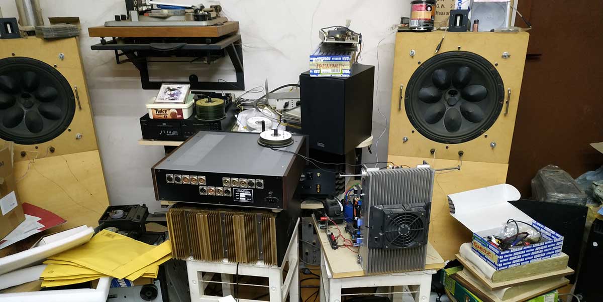

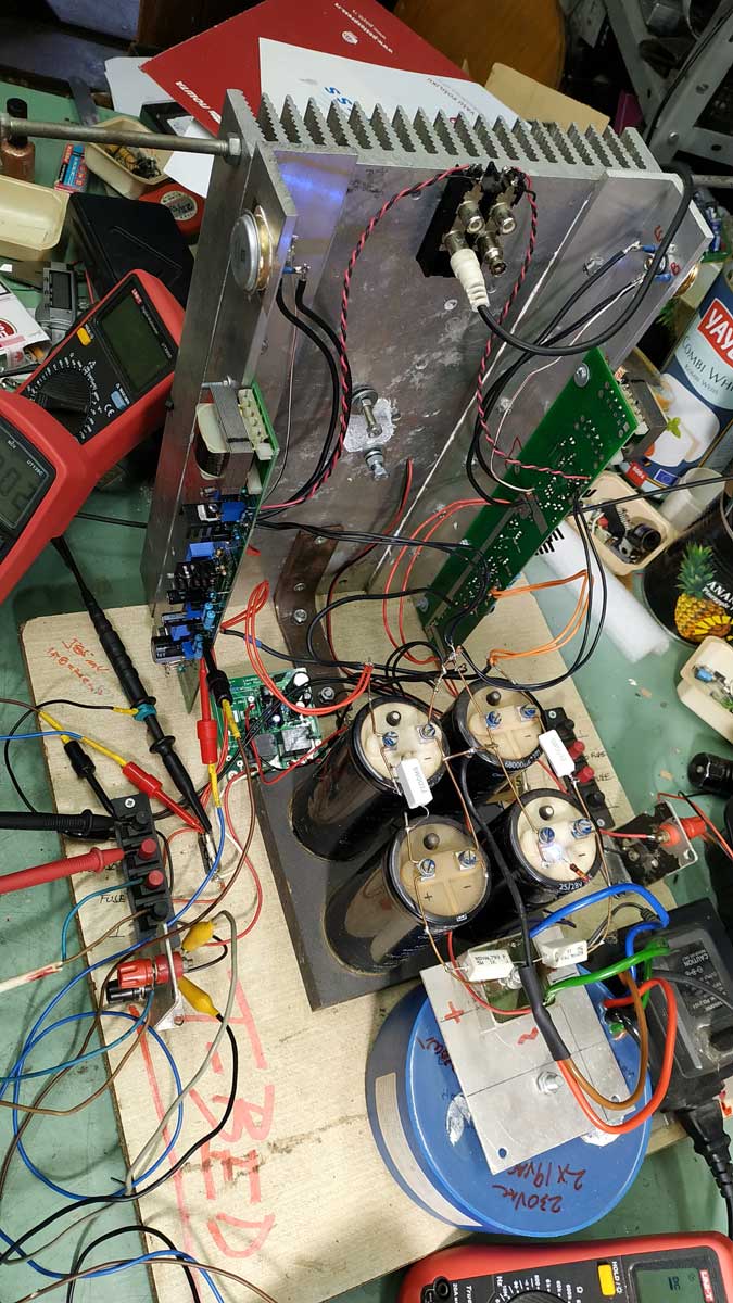

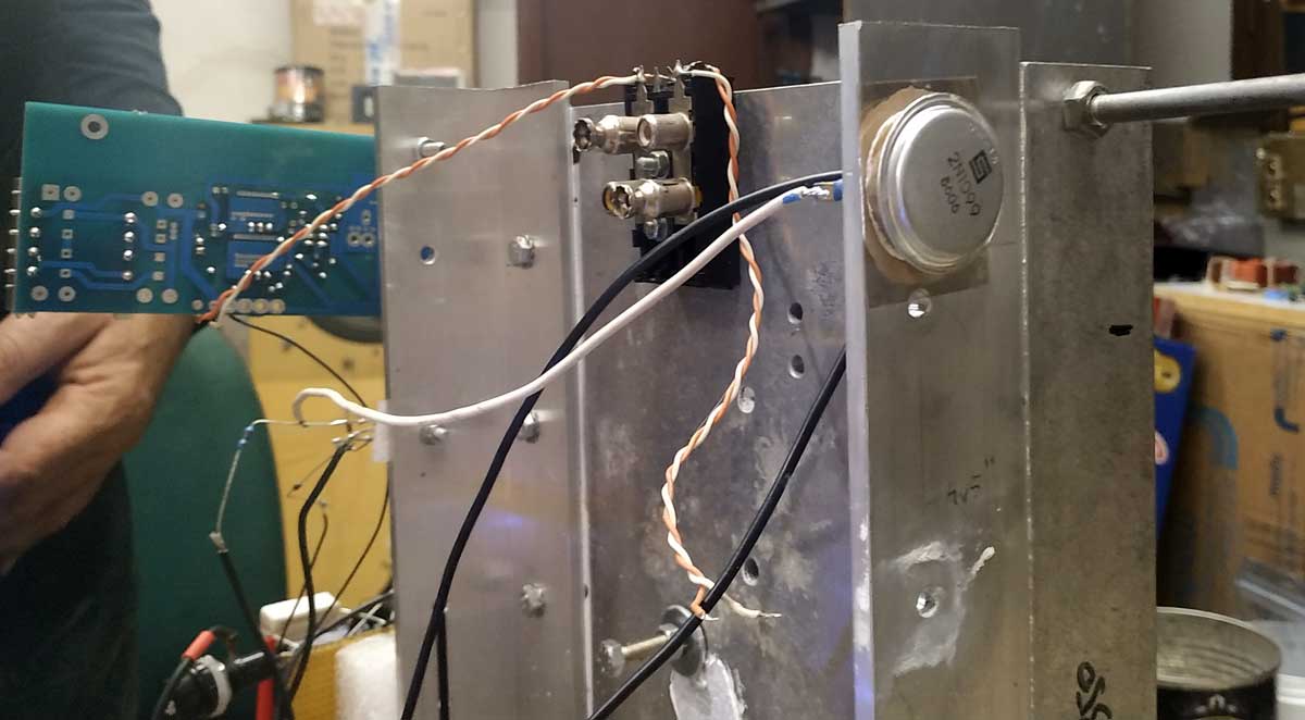

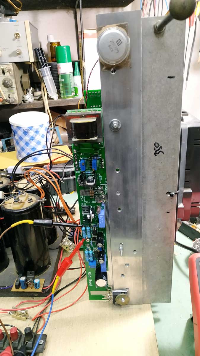

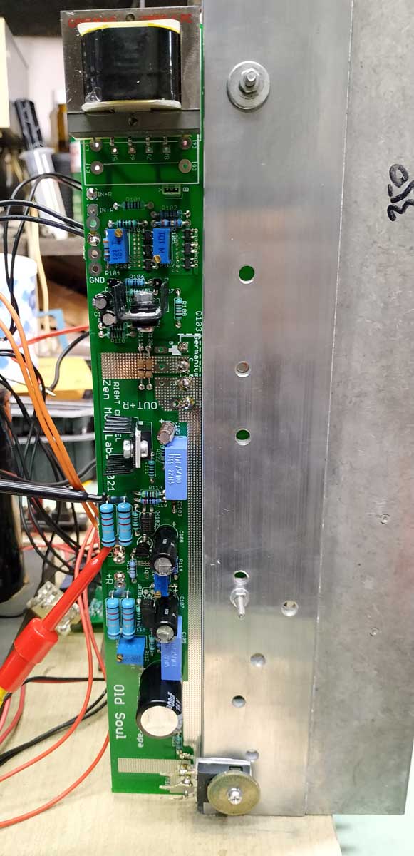

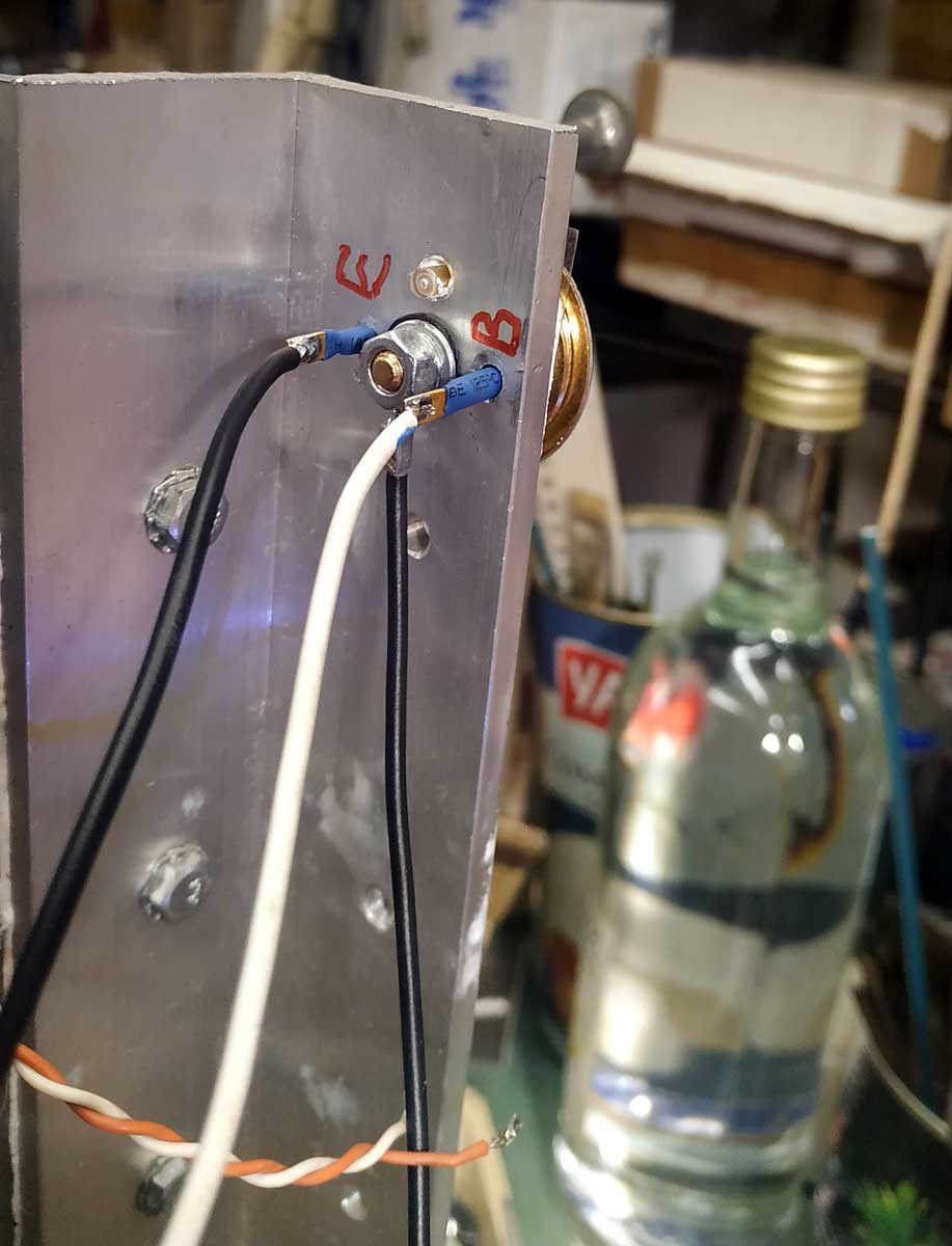

LuDEF out of T-Bed, Old Soul on T-Bed

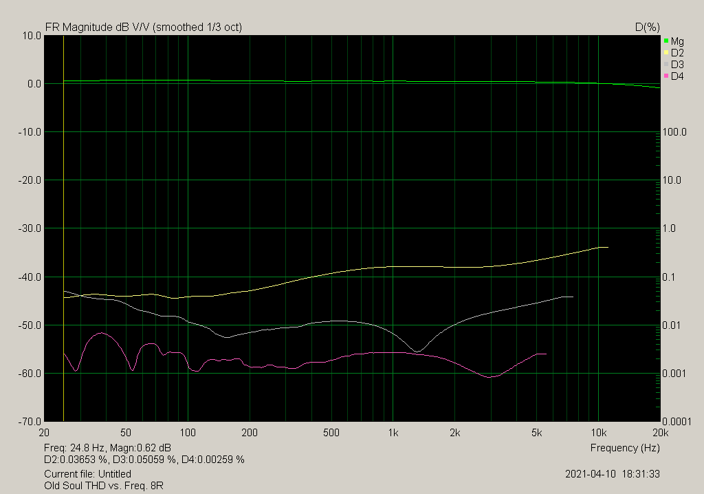

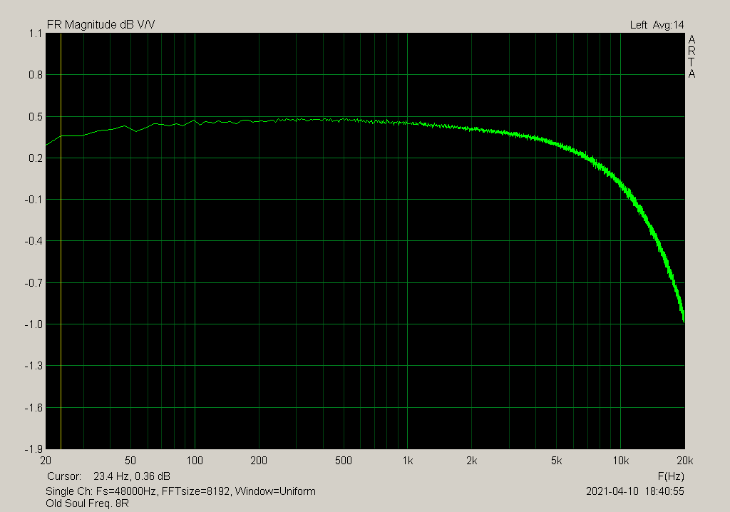

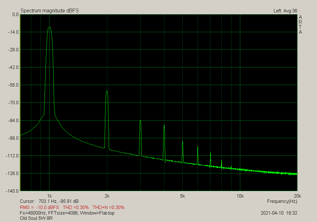

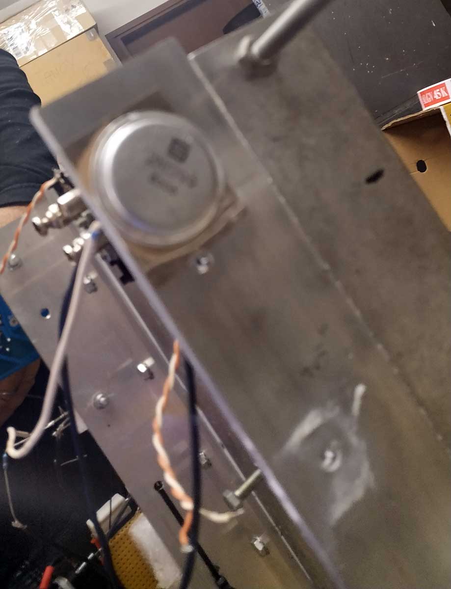

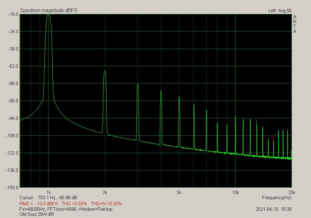

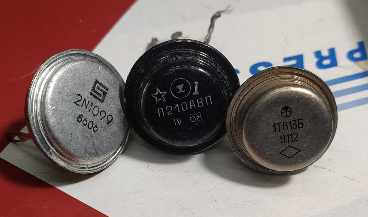

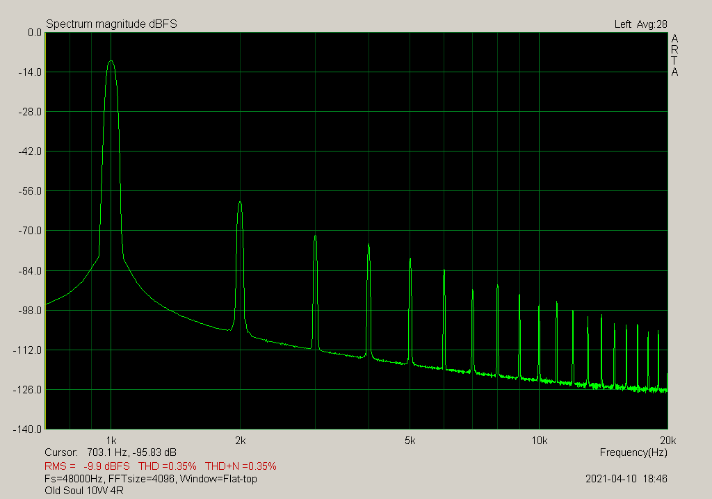

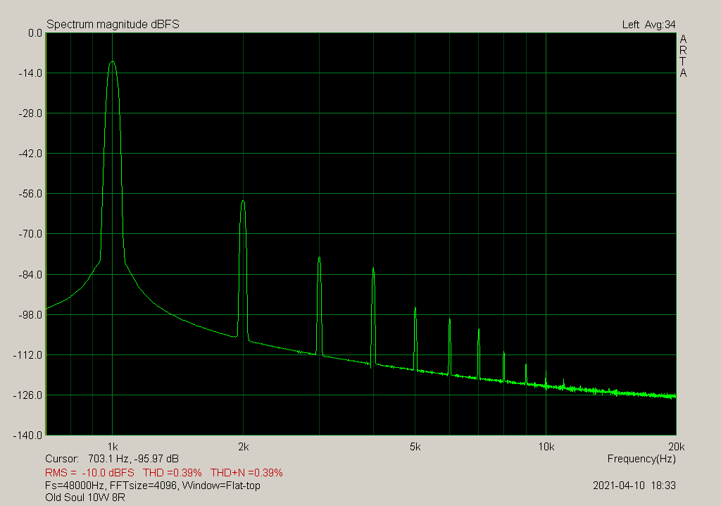

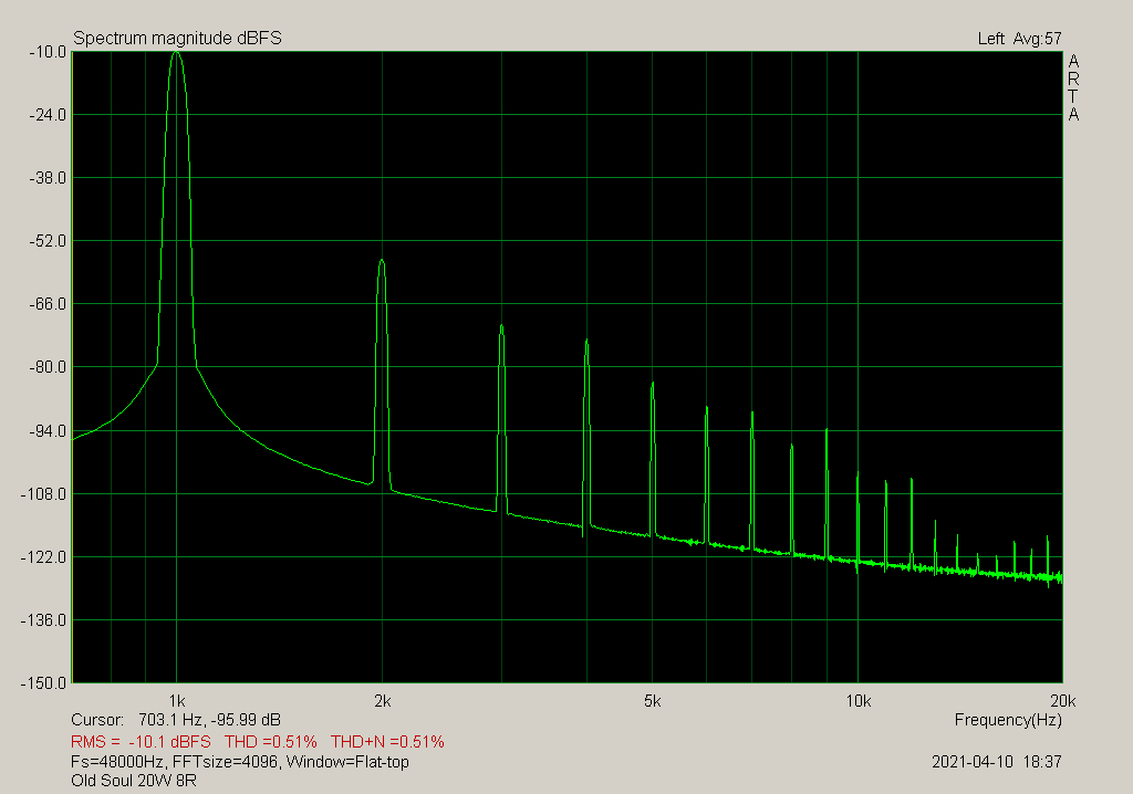

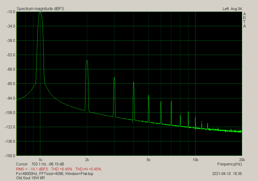

hard data, 8R load
rails 24Vdc, Iq 1A (yes, just 1A; ZM Chicken, want to preserve that funny Ge, to have long and prosperous life)

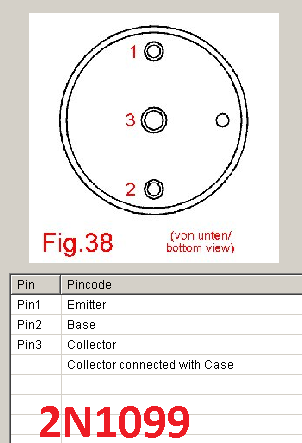

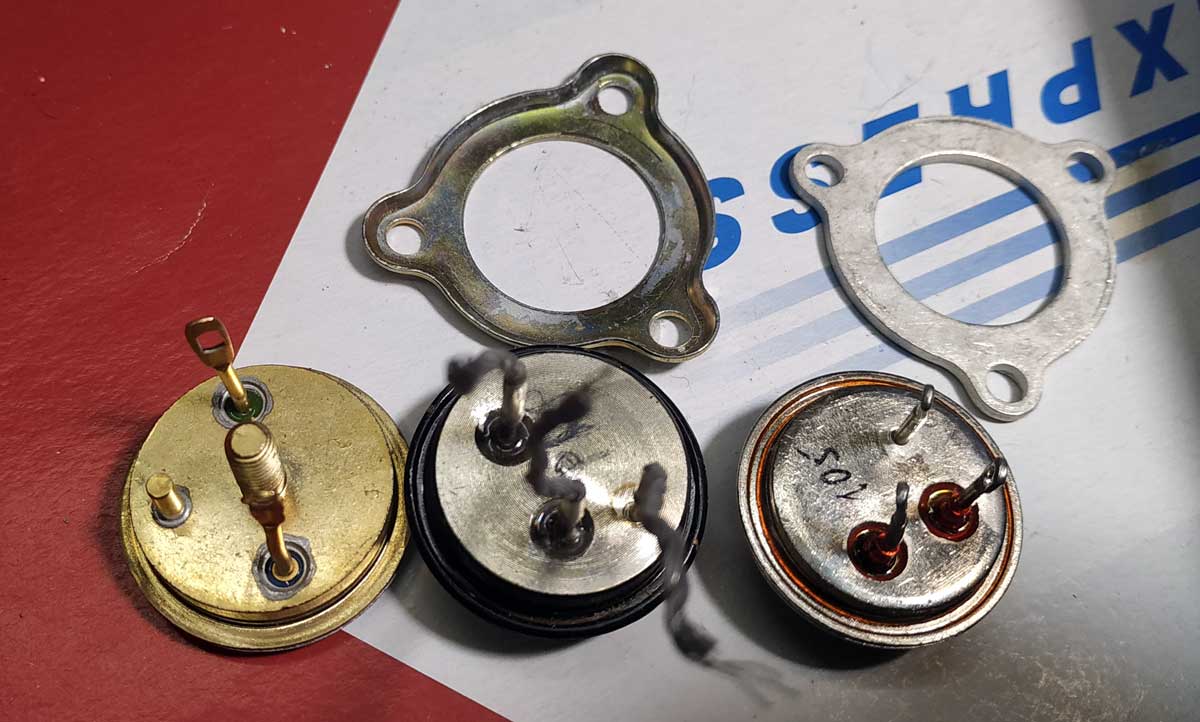

a seen on pictures, Ge used 2N1099

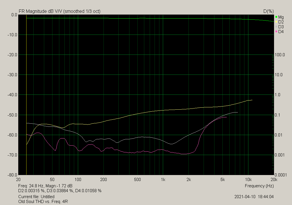

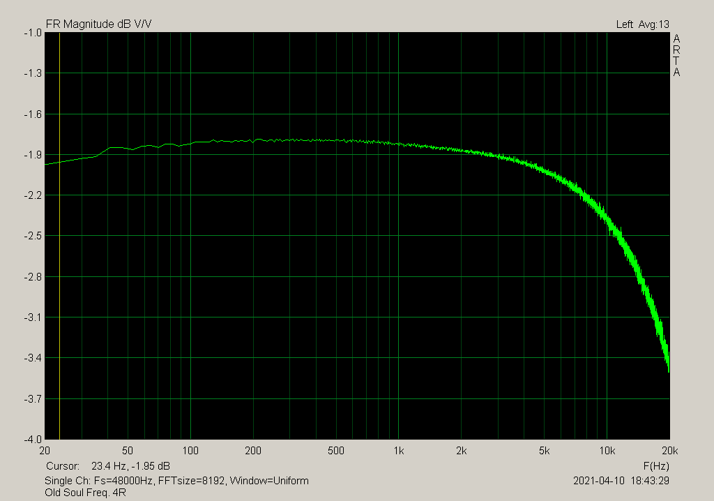

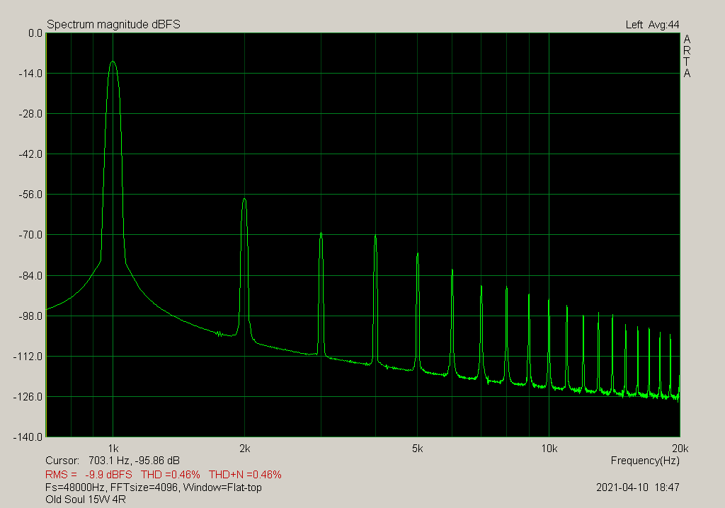

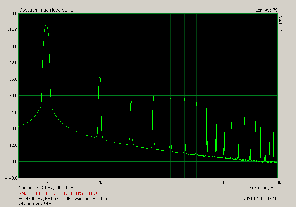

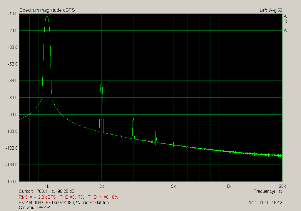

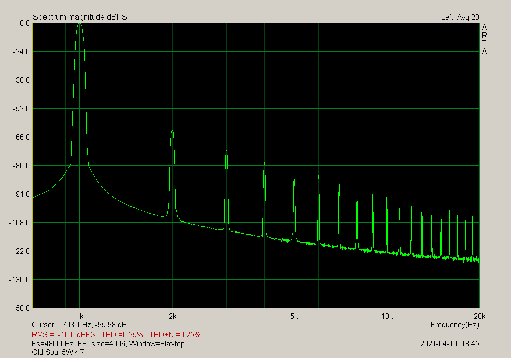

hard data, 4R load, same conditions as previous
how it sounds - SIT-ish; Blasphemy; Surprise; insane Summer amp
will post measurements with other two Russian Ge Biguns, and also with 2SA1943 in place of Ge (as viable and worthy option)
that last one working and resulting in surprisingly funny foot-taping sound

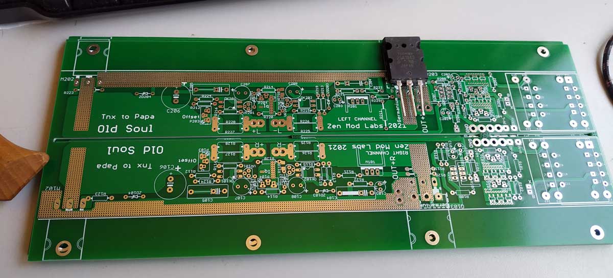

Well... okay.
A few things I am taking from this post.

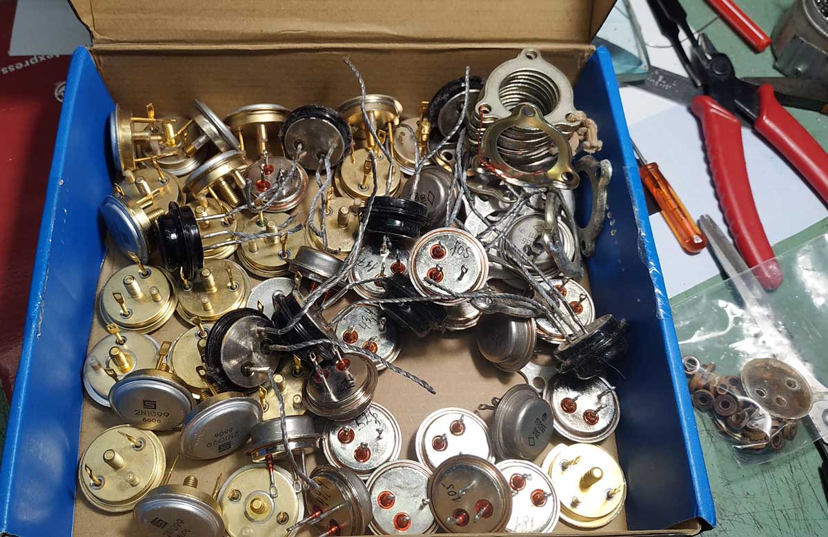

1) just great, another new amp
2) make note to self, find a trustworthy source for a quad of Germanium transistors
3) why do my finished amplifiers not look as well organized as ZM prototypes?

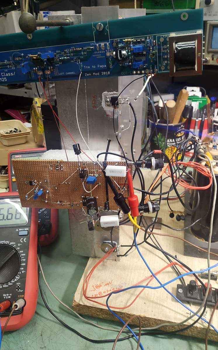

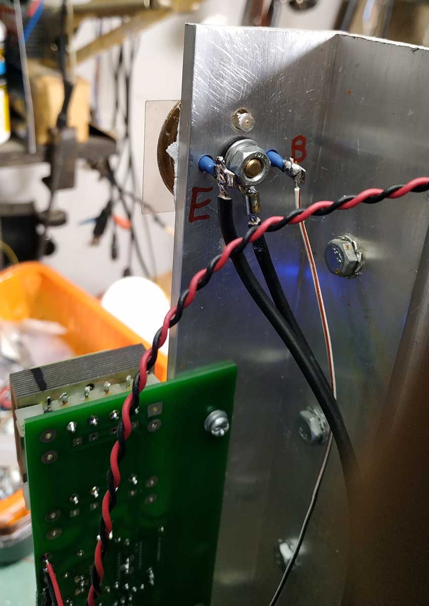

before anyone asks, to note:
biasing and drive - everything explained in LuDEF thread , posts #32-37, LuDEF , applied here too
only that level shifting source follower put in front of Ge in bottom half; due to fact that Ge needs 180-250mV EB voltage, looking at schm B lower than E, there is no need for separate CCS load for source follower - it's simply tied to output/Ge emiter node
(R122) 22R resistor value (in bracket) is sole change needed for 2SA1943
in case of Ge SF current is 180mV/10R
in case of bjt SF current is 650mV/22R
