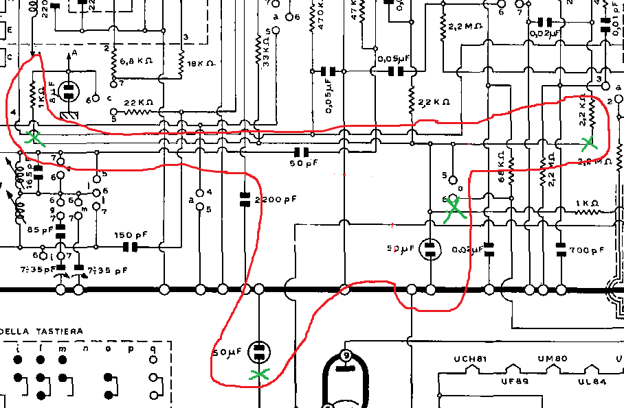

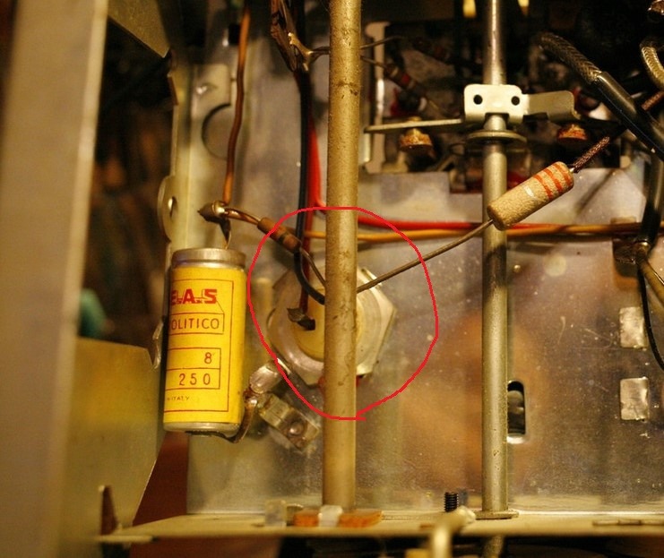

I don't know if I'm in the right section, however I have an old Telefunken Domino that I'm trying to get my hands on. The main electrolytic filter caps may need to be replaced (actually I realized that the one connected to the rectifier valve has already been changed by a previous repairer).
I was wondering which ground connection is relative to the one encapsulated in the aluminum shield, is it the case itself? It is a 50+50uF. Thanks in advance
The case is ground for all sections of the can cap. It can be replaced by single caps for each section by cutting all the connections to the can and attaching them to separate caps. It’s cheaper and easier than finding a cap the first. Just hide them under the chassis. Make sure the voltages are correct in the new caps.
Ok thanks, it was as I suspected. I think I'll try with a pair of 47uF capacitors. I have seen in a network restoration that someone has emptied the capacitor and inserted an equivalent capacitor into the aluminum can. Maybe to keep the original aesthetics, but I'm only interested in a practical purpose 🙂
Does your schematics excerpt relate to your radio? Then be aware that it's got a transformerless power supply and a live chassis. Use an isolation transformer when working on it.

Kay Pirinha, I took the schematic from this italian site. The model I have is the R712 so for what I can see there's not an autotransformer:

I think your's is a R172, isn't it? Yes, that's no autoformer at all. The use of series heated tubes together with one parallel heated is quite unusual, though.

Smart idea is to replace the bridge rectifier along with that filter cap.

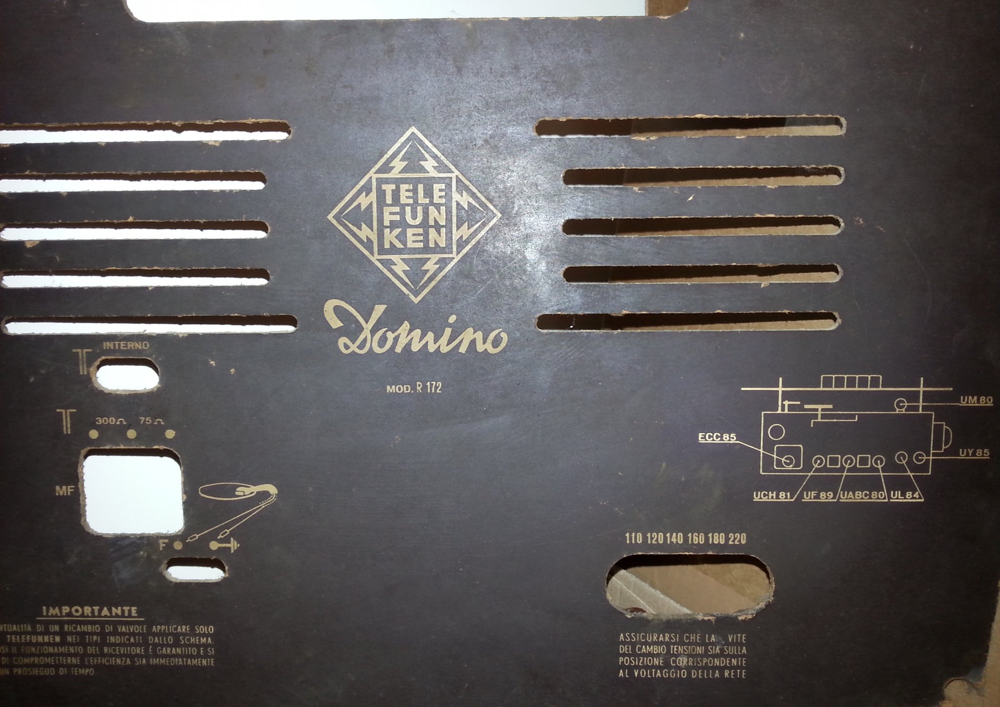

Well, I wanted to updated my trials on the Telefunken (that yes, it's a R712). After removing a lot o dust and dirt I used the WD spray to polish electrical contacts (tube socket, pot, etc.) and replaced the old capacitor with the new ones forementioned. At first glance also the old 1000-5000pF capacitors seemed in good shape, except one that at one end is about to crumble. I tested all tubes just as heater's continuity but not at work (a,k,g1,g2,etc.), so I can't say if some tube is broken or not.
Anyway I decided carefully to power up the and il took life, let's say apparently because I couldn't hear anything but in FM and almost at max volume. Tuning in this range works (it's not distorted), and I can pick up the radio stations.
Given that I know little or nothing about radio, I wonder why in OM I don't hear absolutely anything while the volume is very low in FM. Any valves in the previous stage broken? Problems with the oscillator, or something else? I don't want to embark on something that I don't know, but if there are some basic tests, maybe I can try them and see

The first test in encouranging, but a lot more work needs to be done. It may be worth it because this radio does have a good (but small) 2-3W fullrange speaker and phono input, so it can be connected to modern audio sources. The weak point of your radio are the piano key contacts. Mechanical action is sometimes needed to remove the thick oxidation layer on the contact working surfaces. Then, you must replace ALL the paper and electrolytic capacitors because they are leaky, expecially so in a Italian built budget radio made in the '50. This is not a Telefunken german radio - they were sold as premium "export" models and they had german text on the back cover. The series connected tube string was very popular because those tubes had a lower cost in Italy back then. A cheaper power trasformer is also needed because the filament supply is derived from the HT winding. This was a cheap-ish radio, so the expensive selenium rectifier was not fitted - they used a single vacuum diode. Some background hum is to be expected even after the restoration. To my experience, ECC85, UL84 and UABC80 tubes are often weak and must be replaced. You have FM reception, so the ECC85 may still be good. The UY85 rectifier may also be weak, but it does happens less frequently.
Thanks for the suggestion pcan, I remember you are from my country and maybe from what I see you know well about the popularity and the type of vintage radios. I've read also that for my kind of problem - a part the forementionend tubes and capacitors to replace - one should check the intregrity of an old component called "lares" oftentimes tending to degrade, and the alteration of value of tube cathode resistor (especially to the final tube).

This radio is pretty basic. It should be easy to repair. The first 3 steps on my routine are: clean the contacts, replace the paper and electrolytic capacitors, check basic electrical safety. The last step is important, because old devices may be unsafe: check fuse rating or replace it - remove or replace the "death capacitor" - maybe replace power cord with a new one with ground - rearrange wire location on the primary side of the power transformer and add spaghetti tubing if needed. You can then test it again and fix any further faults such as weak tubes and drifted resistors.
