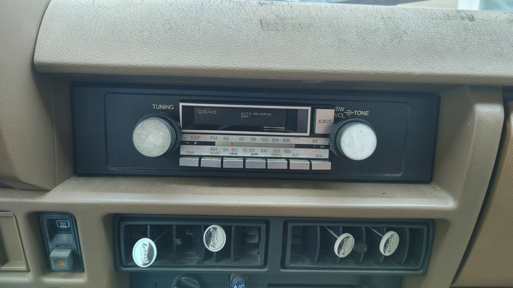

Welp the ooooooole Craig lives to play another song in my 1981 tercel sr5. I think the dirty power switch and flaky harness was part of it, but I found out it was also stuck in AM, and it has AM(?) and FM muting. Need to shift the right knob over but it looks good!
