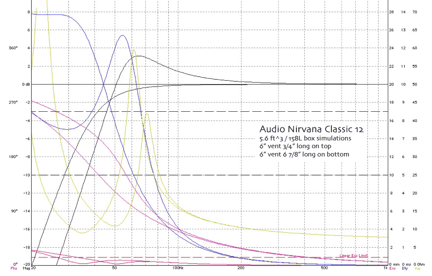

The Audio Nirvana cabinets are often not very optimal.
For the Classic 12 (Ferrite) 5.6ft^3/158L is actually pretty good, but the factory tuning is not very good.
attachment.php
It also looks like it will work pretty well in 80-90L sealed (add subs below ~50 Hz for full extension).
If i were to do a monster miniOnken it would likely be 100L.
A smaller cabinet is easier to keep from ringing.
dave
So I've finished running in the drivers as far as I'm going to, and I've gotten the following results:
Re- 6.9 Ohms
Fs- 44.41 Hz
Qts- .412
Qes- .466
Qms- 3.562
Le- .149 mH
Mms- 31.1g
Vas- 218 L
So, a bit off from the published specs, which is not a surprise, but the two drivers measure exactly the same for all intents and purposes, so at least they are consistent. The results for a generic bass reflex box call for a 8.25 cu ft box, which I'm not really keen on…
Since it's a trad. style driver, a straightforward reflex following the old Vb = Vas, Fb = F0 alignment will be decent enough, once lined appropriately. You could drop that down to about 165 litres, maintaining the same tuning which will be a slightly more damped alignment than the near-maximally flat that you'd get with the larger box above. You can lower tuning a bit in both these if desired to get more LF damping.
Of course, if you wanted to go all-out for a trad. style box, you could crank it to ~18.5ft^3, again tuned to F0, and damp the box via the old click test method until you're happy it's properly damped for your requirements.
I'd think it would behave alright in the original Karlson that is 7.3 cubic foot external bulk, but go lower in a Karlsonator 12 (about 6 cubic foot external) or similar Karlsonator Since you've stable parameters, you might ask xrk971 to run a Karlsonator sim.
